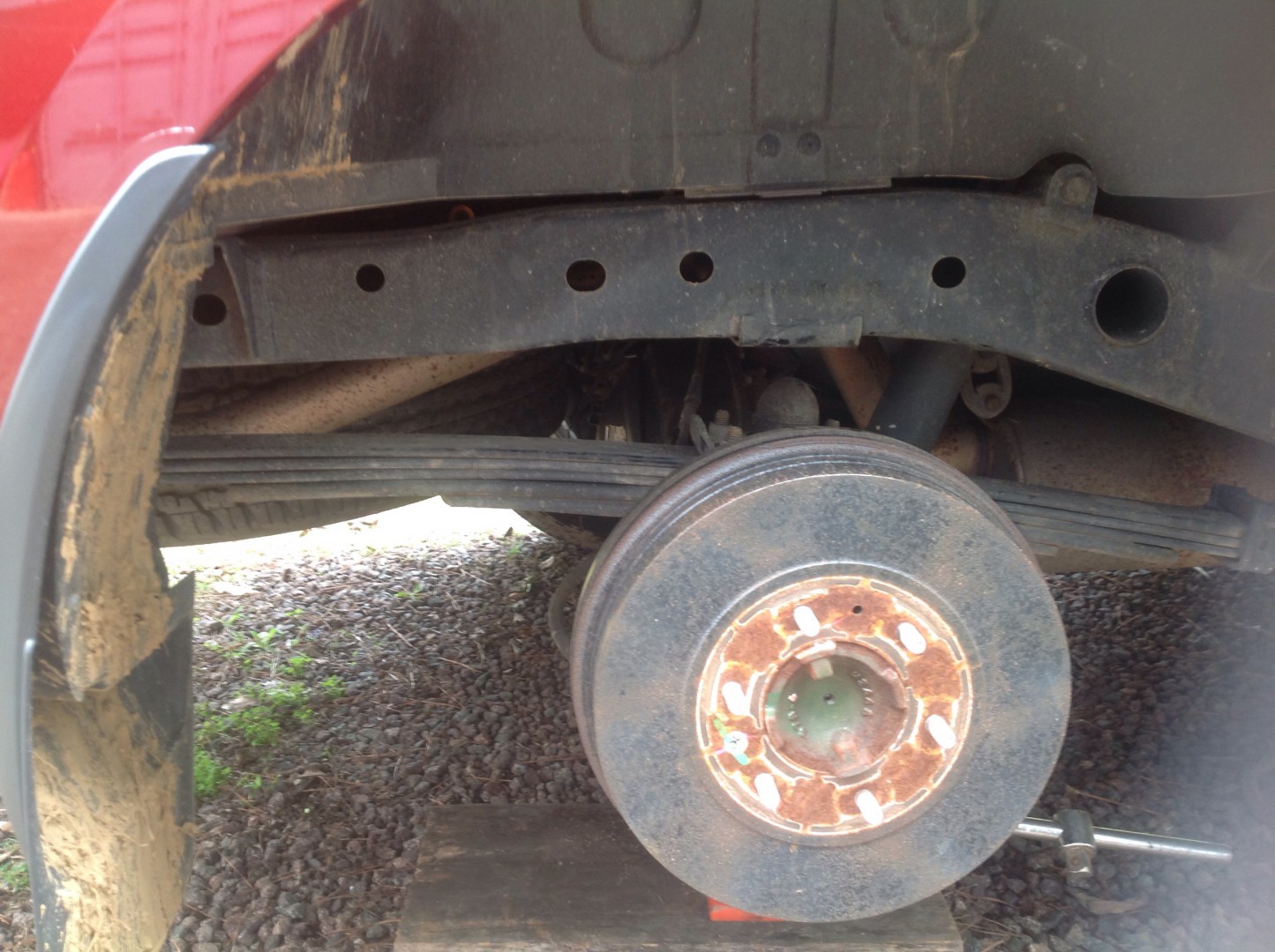

Hi has anyone had there rear springs replaced under warranty on a BT 50. Not 3 years old and less than 35,000 Klm's. With only 240 kilos on tow ball, only I.4 on rear axe have only 30 ml travel between bump stop and chassis, when unhook van and empty the back, springs still bent the wrong way. Have weigh bridge dockets.
Len:(((
Baz421 said
07:28 PM Jul 19, 2015
What model Len and what kerb weight as they differ quite a lot, say 2100ish to 2400kg ish.

Hi Baz. 2012 model, twin cab 3.2 motor GVM 3.2. Mine came in at 2.68. Rear axel specs 1.850 mine 1.4, combined weight 6.00 mine 5.44 tow ball .350 mine .242. And yes Chris and Terry what you are saying is what I'm getting from people I've spoken to and ARB, TJM, and other suspension places people just upgrade them , not only the BT 50s but the Rangers, Nissan and others because the factory suspensions don't do what they claim and like yourselves give up with the run around from the dealers. My question is though is there any one that has had theirs replaced under warranty as it doesn't do what they claim it should do as per Fair Trading.
Len.

Stl said
08:31 PM Jul 19, 2015
Thanks Bazz, I think I will need some or a lot of luck, when I took it to the dealer they said they had never herd of this problem, yeh right. I have photos and by luck had my set up weighed in Jan for my personal Knowledge. am now dealing with customer - tech support in Melbourne, who wanted rear axel weight. Took it to a weigh bride again today to get rear axel weight which I didn't get first time, all weights well under their specs. It's now parked up at their dealership again With the weigh bridge dockets. I'm just hoping others have had theirs replaced under warranty as this will hopefully help me..
Len

Hi one and all, thanks for the input, it's the principle of the matter, they are still advertising what it's meant to do, the add even shows 3 people in the back ( would have to assume 5 people all up) I'm well aware it will cost well over $2,000.00 to install the suspension needed to make it do what they advertise it to do, but I want them to do it!!like I said it's the principle which is stated under fair trading act that they can't make false, or misleading statements. Will keep all posted with outcome.
Whoops the photo is with vehicle completely empty. No weight on tow ball, basically extra 100 kilos over Kerb weight, second battery, canopy and full of fuel, that's it.
Len
Len
