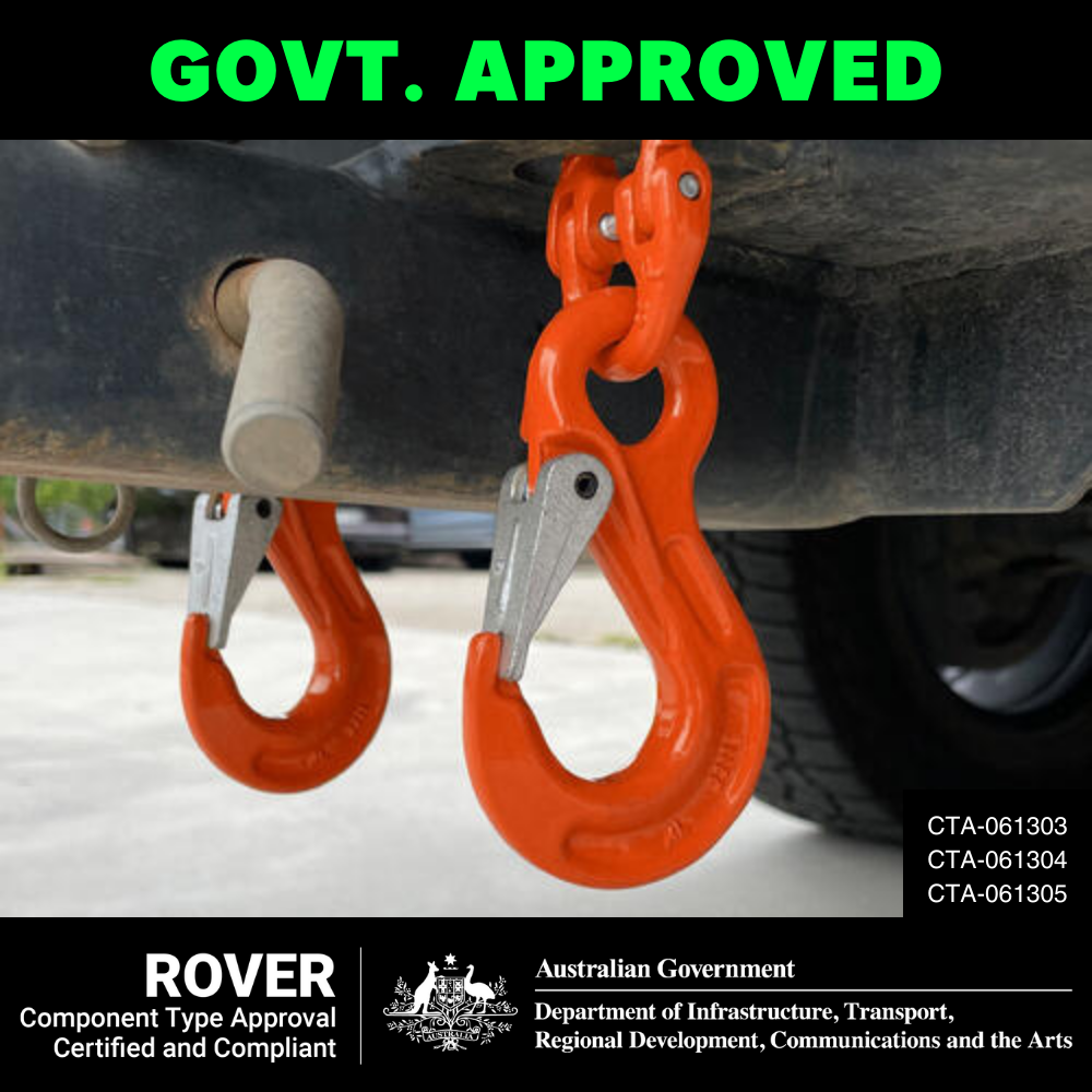

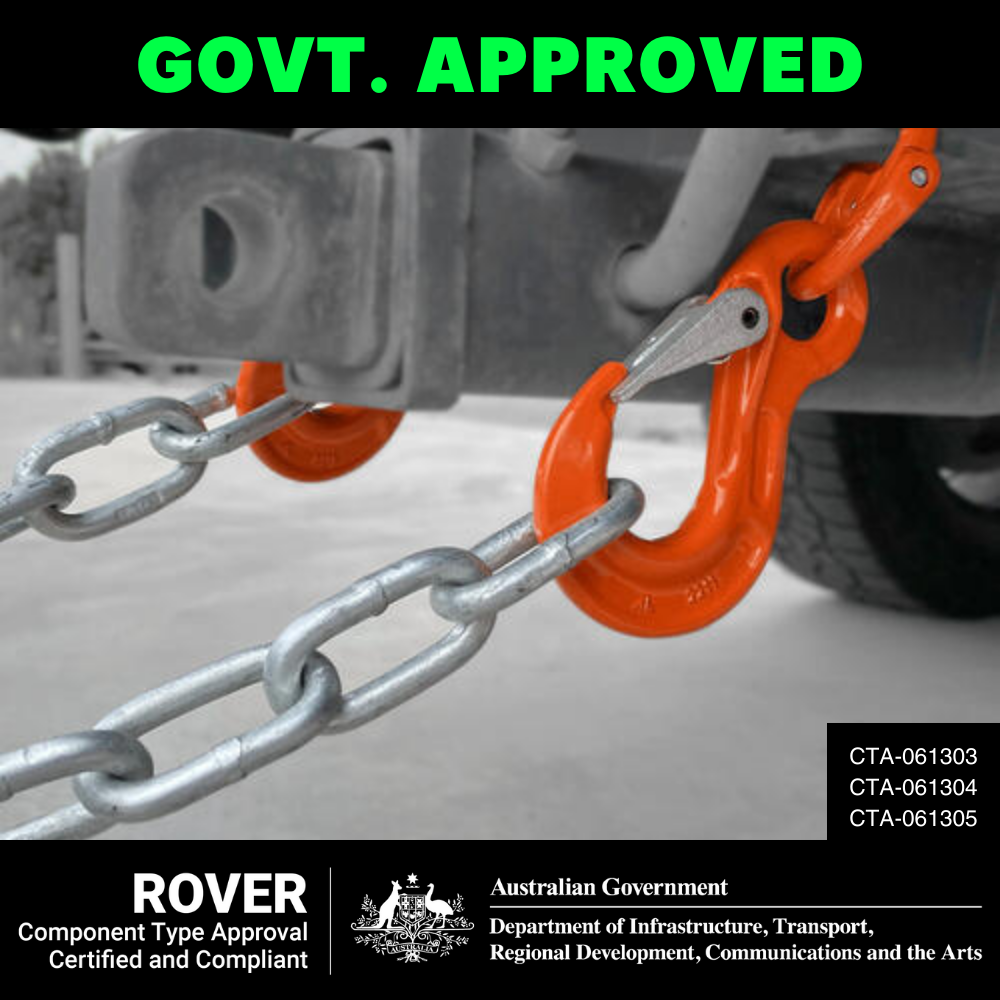

Hey everyone, this company seems to have their trailer chain clevis hooks approved for use in Australia
https://shop.ch-s.com.au/products/vehicle-safety-chain-hook-kit
they have component type approvals which lists them as "full compliance" with ADR62/02.
https://shop.ch-s.com.au/cdn/shop/files/CTA_Approvals.pdf
