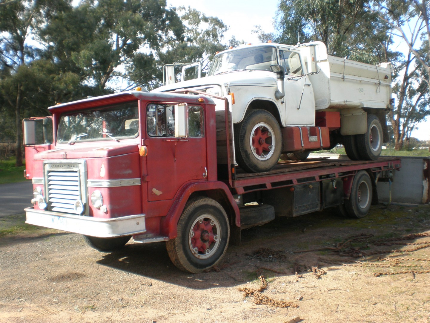

Thank you all for your replies. The truck is a 1968 ACCO with a Perkins & OD box, still working (occasionally), I replaced the seats and lined the cab to make it quiet enough hear the radio (up loud).
enroute to Alice Springs 2010 RTHoF after 10 years in a paddock.... there and back without a hitch.
