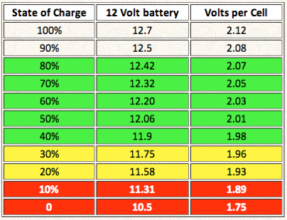

Phil C said
09:01 PM Jul 17, 2015
Hi again,
There is that much confusion in these batteries as to what voltage is 50%. I do remember reading 10.7 volts someplace but the tables above only muddy the waters more.
So our poor OP plus this tech (me) are still in no mans land.. As I have said this is new technology to me, a battery was flat when the SG went lower than a fixed measure (I think it was 1150).
Anyway, if anyone can come up with a definitive voltage that makes sense, Im sorry 12.06 and 12.2 volts just doesn't make sense when the terminal voltage is allegedly 12 volts... Please correct me if that statement seems wrong, I hope you can see where Im coming from. Perhaps we all need to research this some more.
This will only muddy the water even more.. I may have been reading on load terminal voltage... can open, worms all over the place... this table came from a agm battery manufacturer, sorry guys

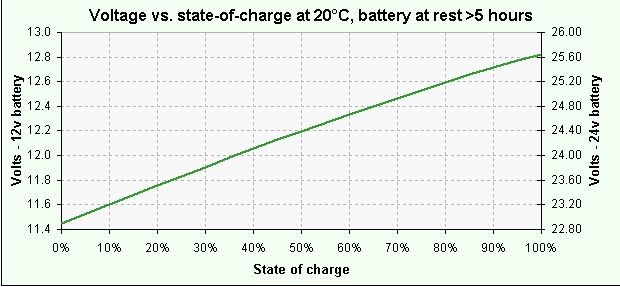

Jaahn said
08:16 AM Jul 18, 2015
Phil C wrote:
Hi again, There is that much confusion in these batteries as to what voltage is 50%. I do remember reading 10.7 volts someplace but the tables above only muddy the waters more. So our poor OP plus this tech (me) are still in no mans land.. As I have said this is new technology to me, a battery was flat when the SG went lower than a fixed measure (I think it was 1150). Anyway, if anyone can come up with a definitive voltage that makes sense, Im sorry 12.06 and 12.2 volts just doesn't make sense when the terminal voltage is allegedly 12 volts... Please correct me if that statement seems wrong, I hope you can see where Im coming from. Perhaps we all need to research this some more.
Cheers -- Edited by Phil C on Friday 17th of July 2015 09:19:41 PM
Hi,
Well there is no definitive way to tell the state of charge of a battery by just measuring the voltage unless you leave it to 'rest' for some hours. AND the different types of battery have slightly different voltages. So that is why it is confusing. AND the 12 volts is just a nominal voltage anyway so just forget that figure for an accurate reading.
The voltage drops the moment the current is taken out and the heavier the load, the more the voltage drops, but when the load is taken off the battery voltage comes back up. So that is why the battery needs to rest for an accurate reading. As was mentioned in the 'old days' you took a SG reading of the acid to know the state of charge, but that is not for today.
If you want to really know then you need a charge controller or total meter which reads the current going in and the current going out and tells you how much you have left. Simple really. Or you can use a voltage meter and observe the readings under your normal loads to get a 'feel' for how the voltage should be as the current is used up. That's what I do.
That voltage chart by BAZ421 looks good to me and is about the right voltages in my experience. Your chart above is crap Phil C and should be ignored !!!!! Ordinary lead acid batteries and gel batteries drop the voltage more under load than AGM batteries in my experience so that has to be factored in. However below 11.5 volts is living dangerously depending on the load so relying on some cutoff voltages in appliances is not wise as they are usually set too low for long term battery health.
I hope this helps a bit.Jaahn
-- Edited by Jaahn on Saturday 18th of July 2015 08:31:09 AM

Phil C said
11:39 AM Jul 18, 2015
Cheers folks
Jaahn is correct in saying my little table (taken from a manufacturers web site) is wrong.
In days gone by, you would measure a battery voltage under load to get an accurate picture of where the SOC is. Im convinced that now days its a guessing game as there is no hard and fast rule (as far as I can see).
I agree the OP has gone AWOL on this one as well, I was rather hoping that there would be some response, it has however opened a good discussion on these new batteries which I confess, I still have little knowledge of.
Im very much of the opinion that its suck it and see. The trouble is, that in my caravan the batteries are never at rest due to the charger/conditioner activity, I am concerned now that under load (TV, lights and inverter at low DC amps) the voltage gets below 11 volts. Should I ignore this? My setup is rather robust as it is 2 100AH batteries in parallel. In the above example Im drawing around 7 amps. The device I have to measure is a SETEC drifter panel. Mind you, if I shed the load the voltage bounces back to over 13 volts.
Hopefully somebody can help me clear the mist.
Baz421 said
05:53 PM Jul 18, 2015
Phil C wrote:
Cheers folks
Hopefully somebody can help me clear the mist. Cheers
Phil Batteries are far more advanced than when were RAAFies in 70's that's for sure.
However as to your question above - I never let ours go below 12V under load, NEVER. By the way they sit on 12.2V down to 12.1V down to 12.0V for ages and ages, UNDER LOAD. As I said our last lot of 4 X 100ah batteries lasted 7 years except one which was connected to an inverter wrongly by the sparkie who wired the van at manufacture.
That one battery obviously went below 12V without me knowing it until I looked very closely at the wiring and that battery lasted 2 years.
One thing with AGM's make sure they are fully charged and charge at the 20ah rate (for your own batteries - should be printed on the battery) for a while to see how they come up, ie if they come up quickly in say 6 hours or so they were not flat at all BUT if they take 24 hours to charge they could reasonably be called flat.
You get a feel for it if you watch the amps IN ie solar on fine day for us is 25A if batteries low for say 6 hours before charge rate drops to float voltage. So in that 6 hours I put back say 150Ah from a bank of 400ah batteries. So I have not even taken the batteries down to 50% of capacity (not SOC here).
Hope this helps.
Cheers Baz
