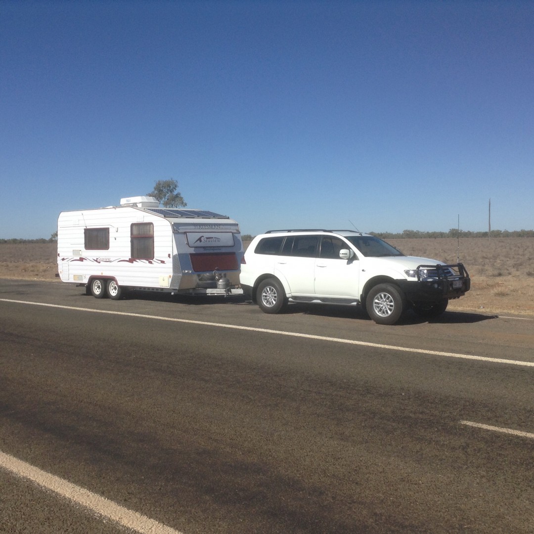

Anybody out there using a Mitsi Challenger for a tow vehicle?
looking at about 2200kg GVM and ball weight about 160 kg
I guess a Mitsi Triton is about the same vehicle

Challenger all good for weight 3000kg tow 250 ball weight Just wondering about transmission and power durability etc

Hi Jade. I'm using a Challenger for a tug- my weights and measures are about the same as yours. Unfortunately, I can't advise what it's like as yet as I have been refurbing the van. Won't be long tho. We bought it after much research. It's petrol currently returning 32-37 mpg on the highway not towing. I expect that to drop quite a lot but i think it will still be acceptable. Tough if it ain't.. It is based on the Triton I understand. Pajero similarities as well. Other than that I'm in your boat- wondering.

We have a 2011 challenger,towing 2.1t. There is now 142000k on the speedo.42000 as been towing the van. Anywhere between 12.1 and 14.3 lt/100k. Love the unit and would buy another one tomorrow! (no van can get 7.8l/100k between Bathurst and Sydney return.)

Never had any o/heating problems anywhere.Ours is a manual runs up Mt Victoria,River Lett hill, Mt Wyagdon and Commissioners hill in 2nd at light throttle and at 2200 rpm.

Where did you get the 250 kg ball weight? My towing guides specify the 2005 an earlier models as 2270/227 kg, up to 06/2010 as 2500/250 and subsequent models as 3000/300. However the edition is May 2015.
This is a review on carsales page for a 2013 tow test on Challenger.
I don't own a Challenger was just asking for an opinion and my ball weight was conservative given they quote 300kg.

http://www.caravancampingsales.com.au/content/advice/2013/tow-test-2013-mitsubishi-challenger-4wd-ls-39857
MITSUBISHI CHALLENGER 4WD LS
Engine: 2.5-litre, four-cylinder turbo-diesel
Power/torque: 131kW at 4000rpm/ 350Nm at 1800rpm
Transmission: Five-speed auto
Length: 4695mm
Width: 1815mm
Height: 1840mm
Wheelbase: 2800mm
Ground clearance: 220mm
Kerb mass: 2051kg
Fuel: 70 litres
Towing cap. unbraked/braked: 750kg/3000kg
Tow ball mass maximum: 300kg
Fuel economy (claimed): 9.8L/100km
Price: from $42,490 (MRRP)
I wouldn't class the Challenger as Agricultural, most comfortable 4x4 I have driven,and towed with
