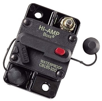

You could use a manual resettable circuit breaker similar to this. Just press the button to open the circuit and push lever back to close it. 60A or 80A depending on what load you normally have on the battery.

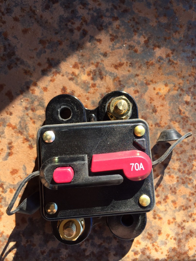

Thanks troops that was what I think I was looking for so got one and fitting it today
