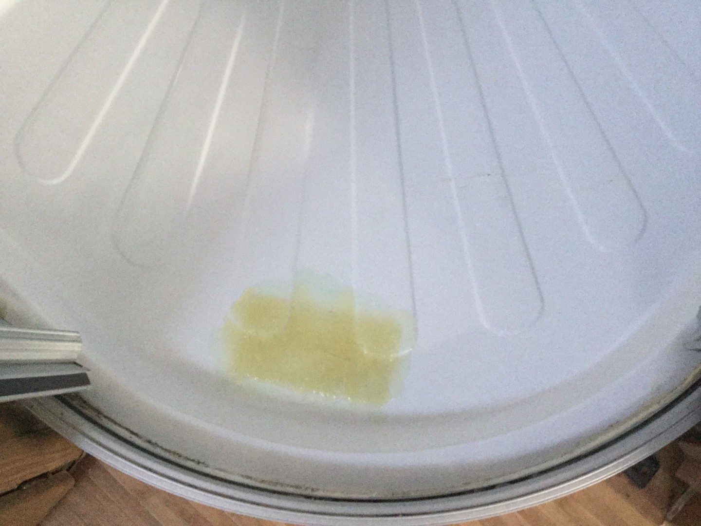

As I have said before I have these horrid cracks in the floor of the shower, it seems to me nobody will cover any replacement/repairs so I bit the bullet today and staeted the fibreglass repair. After 20 mins the surrounding floor hasn't softened and there is very little exothermic activity.
Pic shows the first patch after 20 mins.

Thanks Woody, Im not much at composites either, I spoke with an old bloke last week who was a fibreglass expert in his trade.
Asked him about glass on ABS and he said no worries. It seems this is a winner, all we need now is the elephant test when I take a shower in it lol

In its raw state like that it is still porus and not water proof, it will need at least 2 coats of flowcote to seal it but you are probale aware of that

Thanks blaze, that's bloody good information. As I said I know little about composites. Thank goodness for this forum..

If you do put on some flowcoat. make sure to cover the flowcoat with some tape. Flowcoat normally only hardens in the absence of air, if you watch say a boat being built the flowcaoat is first sprayed onto the mold then the fibreglass, ie no air on flowcoat.
Someone above mentioned that it may be ABS, if that is so you can melt some ABS into acetone to make a thick soup then introduce into the damaged area, when the acetone evaporates you are left with ABS and a joint as strong as the original (in theory). The acetone in the soup should melt the surface of the shower fusing the two together. I have used this method on some scooter panels with successes.

You have your flowcte and gelcote mixed up, flowcote is applied to exterior of fibaglass, gelcote is applied to a mould and the fibalass is then applied to that to create a finished product

The problem with the soup mix of acetone and ABS is that the floor is rather thin and has little support underneath. Im rather hoping the glassing will do the trick as I have extended the mat over a reasonably large area.

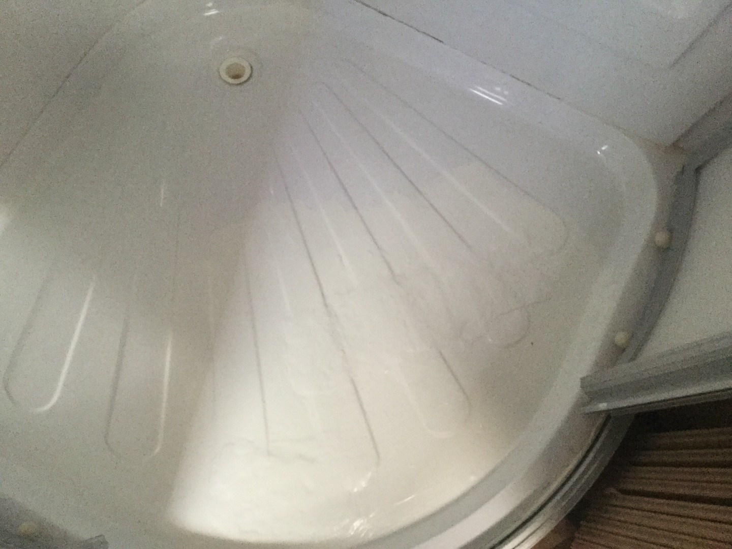

Just put the last coat of flowcote on the floor. Did a quick elephant walk on the repair last night, to see where the crack will start again and not a problem. I suspect we may have a winner here.
I put 2 layers of fibreglass down and 2 coats of flowcote, so I recon I have this sucker in the bag. The repair has thickened the floor and given it more support, look a bit tacky but we don't live in there so practicality is the order of the day.
Thanks so much for your input guys, I was completely in the dark about flowcote, that is one great product.

Cheers again for your help the work stunk like mad for a while but Im letting it harden some more before we elephant test it before the showers 2morrow.

Thanks AK, that's the problem... getting underneath. Its a sealed unit so the next step (if needed) will be to cut and lift the floor, fully support and glass over the top... The flowcote is the best, so that gets a go next time..

the flowcote is ONLY to seal the fibaglass and not for any other use. Dont cut the floor out, drill some holes about 200 mm in from the corners ( about 6mm holes and call them entry holes), then drill some 10mm holes on the sides in the corner (call them exit holes). Now get some expander foam and put in the entry holes until it expands out the exit holes. Be VERY careful as expanding foam can do damage if it cant expand freely. Expanding foam will absorb water (if leaks are fixed it shouldnt matter), you can also buy close cell foam used in the construction of boats and wont absorb water but I havnt seen it in pressure pacs, used as flotation.

Yes as with most structural things .. 10% extra support can make things 100% stronger... I was going to suggest adding foam from underneath ? It seems as explained it has double floor ? Which is where I would go through as asthetally can't see the patch ... Other than showering on boogy board etc ? I guess there's no room for a dancing rail ? Ahaha

It has a double floor with small blocks of wood?? supporting the floor. It flexes like crazy when you step on it. As it is only about 2mm thin it cracks real easy. Really bad design and not built for heavier people..
