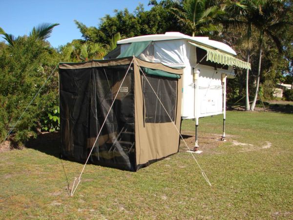

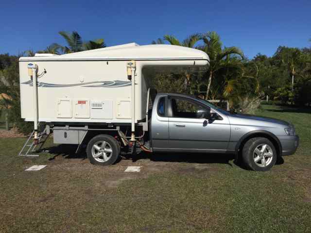

We have had small towed pop tops both canvas and hard roofed for many years, (great fun) and then purchased an Avan Off Roader that they experimented with some years ago and used it for about 6 years. (Hated it, too big and combersome off road) I then had an old VW Kombi well set up that we took around Australia and up and down the east coast several times for 5 years (loved it but unreliable) but after being restricted to mainly made roads decided it was time to get something that was four wheel drive and revisit a lot of areas that we wanted to explore more and at the same time get away from a bigger rig. After a lot of research I decided I would purchase a slide on. As a trial and an interim, have purchased a second hand Matilda Slide On (Gross wt 800kg) with remote electric legs and top lift and am using it around Queensland before heading back south later in the year. I have it fitted on my Ford RTV with upgraded leaf springs and airbags.
I was going to buy a new Active slide on but this came up after I sold my Kombi whilst in Brisbane much faster than I had expected and the wait for an Active unit is nearly six months and we were left homeless so to speak!!. Advertised my VW Kombi thinking it would take several months, sold it in two hours, what was I thinking!!
First impressions of the Matilda Weekender slide on is that it is fantastic but I do need to upgrade the old Ford to a new 4x4 Ute, I would like to get a Cab Plus type ute but if necessary will go with just a single cab but need to do some more research on what is out there and the length from Cab to rear axle as C of G is fairly critical that it be at or forward of the rear axle. Extra leaf springs and air bags I consider essential so will arrange for those before delivery.
Looking forward to some more around Australia trips in the coming years.

GarryM said
06:46 PM Jul 22, 2015
Have now been running with the unit on the back of our old Ford RTV for over a month now and done about 1000km up and down between the Sunshine Coast and up to Hervey Bay and back down to Byron with out any problens with an extra HD leaf in the springs, 50psi in the air bags and on recommendation from Goodyear, uped the tires on the rear of the ute to 60psi and it runs and tracks well and sits very comfortably on 90kph.
Anyone thinking of getting a Slide on, I can only highly recomment that extra leaf spring and air bags is the way to go but do some through research on GVM to make sure you stay on the right side of the recommendations for the vehicle.
