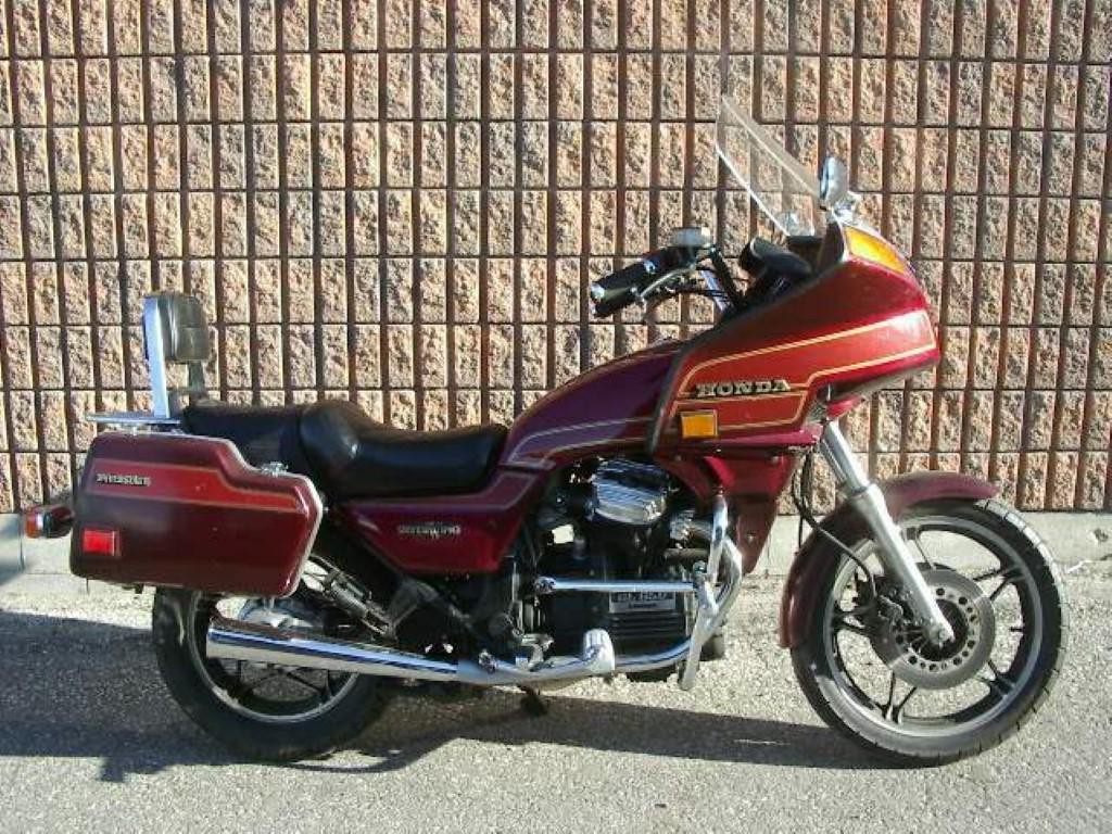

We are in Dungog, with Blazeaid, helping to clean up after the floods. I recently bought a Honda GL 700 m/cycle. My partner and I went for our first ride to Newcastle. To be sure, we bought a new battery for it.
At Hexam the motor stopped dead. No electrics.
Called the RAC, (NRMA) The bloke turned up, charged the new battery and suggested that we go back to Dungog.
He said that we should find a reputable auto electrician to check the alternator. He also advised us to avoid "Dodgy Bros Auto Fix". We have a trailer to carry the bike to Newcastle. What we need now is the address of a competant auto electrician. Any ideas, please!?

First of all the Honda does have a stator not a alternator so far I know
The common problem is most likely that the rectifier spit the dummy or
that the 3 way white plug on the stator wires is burned out,
and that stop you dead in your tracks
most early Gold-Wing riders used to solder the wires together instead of having a plug there
so there you have the most commen problems
also try to get a workshop manual for it
Wich model do you have exacly is it like the photo???

Yes it is exactly the same as the photo. They only produced 800.

If you check that white 3 way plug what comes from the stator first
It is under your seat on the rear mudguard (3 plugs together 2 small one big one )
I just had a look in one of my manuals
Also check if your main fuse is still ok , they are very tricky they can look ok but have some times
a hairline crack in them
Cheers John

Now if you have a multimeter and know how to use it , there is another test to see if stator is ok.
First of all , make sure you have a fully charged battery. Then disconnect the white plug...start bike up and let it run at even idle ..Don't rev it up ... and on the alternator side of white plug (male side from memory) with multimeter on ac volts ...check output voltage on each pair of wires..3x2 pairs. Voltage needs to be consistant across all pairs...and not below 15 volts per pair.
If its outside any of this ....stator is stuffed ...and from memory it is engine out of frame to get at it.
There is a bloke at Colo Vale who has rewound mine in the past who does a top job. If yours needs to be rewound ..P/M me and I will try and find his ccontacts.
Also set your multimeter at dc volts ...and with everything connected and at idle ...;there should be a consistant 14 volts ...even with headlight on.
HTH.
Cheers Keith
