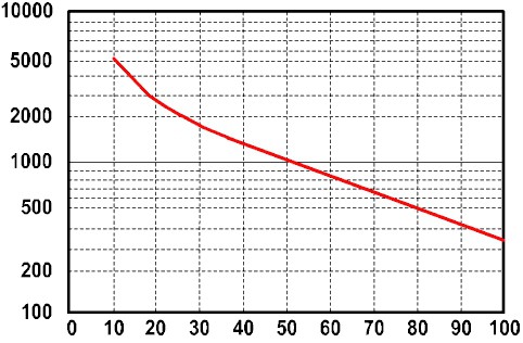

Ondabeach said
08:35 AM Jun 24, 2015
Actually Peter, the thing is that continually discharging your battery to 20% will GREATLY reduce the life of your battery... by 90% in fact!!!
Just google 'AGM battery discharge depth vs cycles' and you'll see the same thing everywhere.
The lower you discharge your batteries, the shorter their life.
The longer you leave them even partially discharged, the shorter their life.
To maximise your battery life, keep them as close to fully charged as possible.
Our van will be parked at home for a few months,. We only have one battery, so I have just disconnected one of the terminals. Normally the roof top solar panels would keep the battery charged, but I have covered the van so no solar.
Have I done the right thing???

Ondabeach said
02:52 PM Jun 24, 2015
Whether you discharge to 20% or 60% before recharging, it is still a cycle. A cycle is defined as a period of discharge followed by a period of charge, ideally to full capacity.
While a battery is discharging, the sulphuric acid, which is the electrolyte, chemically reacts with the lead plates to create lead sulphate, which builds up on the surface of the plates.
When the battery is recharged, most of the lead sulphate is converted back into sulphuric acid and lead, but some of it will crystalize and will not reconvert.
The deeper you discharge a battery, the thicker the layer of lead sulphate build up, and the less of the lead sulphate that will convert back into sulphuric acid when the battery is recharged.
The longer a battery remains in a state of even partial discharge, the more of the lead sulphate on the plate surfaces will crystalize, which is why a battery left discharged for a long time will no longer accept a charge, because too much of the lead sulphate will have crystalized and no longer be able to be reconverted to electrolyte and acid.
So the bottom line is that the more deeply you discharge your battery, the fewer discharge charge cycles it will endure, in other words, the shorter it's life.

Peter_n_Margaret said
06:31 PM Jun 25, 2015
This is exactly the same as saying if you drive to the next city instead of just driving to the shops you will get less TRIPS from a tank of petrol.
A battery works in much the same way.
The graph you posted has the information to calculate the differences. Measuring the life in Ahs or Whs will indicate the power the battery delivers in its life - like a car, we are interested in fuel range, not how many trips we have.
Shallower discharges give slightly better life it is true, but that may require buying and carrying several batteries instead of just one.
To get back to the OP, discharging your battery to a low state will not DAMAGE it, it will simply use more of the total fuel that it can deliver over its lifetime.
And do recharge it fully as soon as possible. Leaving it flat will damage it.
06:00 PM Jun 26, 2015
This is becoming tedious.
To use your graph Steve......and using a 100Ah battery as an example.... If you discharge that battery by 80Ah between charges EVERY time you use it, your graph shows it will deliver about 500 cycles @ 80Ah each = about 4,000Ah over its lifetime. If you choose to discharge it by only 20Ah between charges EVERY time you use it, your graph shows it will deliver about 2,800 cycles @ 20Ah each = about 5,600Ah over its lifetime.
"Actually Peter, the thing is that continually discharging your battery to 20% will GREATLY reduce the life of your battery... by 90% in fact!!!"
No, not a 90% reduction in capacity, closer to 28% actually, for this quite extreme example.
Then, if you wish to take advantage of that extra life and you need the 80Ah between charges, you will need to carry 4 of those 100Ah batteries instead of one.
That is about 120kg instead of 30kg to lug about and about $1,200 instead of $300 to spend each time they need replacing.
We can each decide which of those options appeals to us best.
11:46 PM Jun 27, 2015
Ondabeach wrote:
But... you just couldn't resist misquoting again hey Pete?
No one has suggested only discharging batts by 20%, I recommend not going below 50%.
The only time I quoted you Steve was when you said......
This is a common statement about deep cycle batteries and AGMs in particular, but it is an urban myth, it is misleading, it is not correct, it is just wrong and there is no data to support it by manufacturers or any one else, but quote it often enough and some people will start to believe it.
Look like all the world's battery manufacturers are pretty clueless Pete, you could save them a fortune in all that silly testing they do.
Amp Hour lifetime delivery comparison for a 100 amp hour AGM battery based on data from battery manufacturers.
Discharge down to 20%
500 cycles @ 80 Amp Hours = 40,000 Amp Hours
Discharge down to 50%
1100 cycles @ 50 Amp Hours = 55,000 Amp Hours
40 x 1.375 = 55
So only discharging your batteries down to 50% will give 37.5% more usable power during the lifetime of a battery compared to discharging down to 20%.
Not my opinion, just cold hard scientific fact, proven not by me, but by the companies that make the batteries.

All cycles are not equal, Steve. A cycle to 20% is not equal to a cycle to 60%. To talk cycles and try to define life in cycle terms is mostly meaningless. Yes, during each recharge event, a little less lead sulphate is converted, as I explained above. The rate at which the degradation occurs is pretty well linear to the amount of conversion that occurs during a single event where the battery is discharged from some charge level. A little use, a little degradation; a lot of draw and a lot more degradation. So the number of "cycles" is just a count of the number of charges the battery receives after a discharge of some value; nothing to do with some prediction of "life".

Yes Iza, 20% is different to 60%, and no, you can't define a battery's life in a precise number of cycles. There is no definitive way to predict the life of a battery, but the manufacturers use 'cycles' as a yard stick because it's the most definitive and succinct method they have.
The crucial facts remain that the deeper you discharge a battery, and the longer it is not in a fully charged state, the shorter it's life will be. Any time that a battery is not fully charged then there will be some lead sulphate present, and some of it will be crystalizing.
So, more time a battery spends near fully charged the longer it will last.

Peter, you seem to be under the impression that a battery will deliver close to the same number of KW hours in it's lifetime regardless of how deeply you discharge it. That is simply not true, to use a fuel economy analogy, you're suggesting that you can get the same mileage from a tank of gas regardless of speed, load and terrain.
That's an analogy that does not work, Steve. Fuel usage varies in accordance with several factors other than how much you use before filling the tank again. A water analogy might work if you could explain how water disappears if you empty more each time before you refill.
Iza
Just a few urban myths for ya Pete
https://www.google.com.au/search?q=agm+battery+cycle+discharge+curve&biw=1280&bih=623&tbm=isch&tbo=u&source=univ&sa=X&ei=5CiPVZSdIoTl8gXM6YPgBw&sqi=2&ved=0CCMQsAQ#imgrc=_
40 x 1.375 = 55
