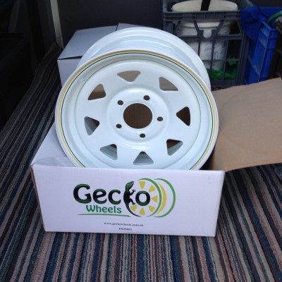

Hi Docker, I see by your profile you're in Perth. I recently bought two sunraiser style rims from Perth Tyre Distributors in Belmont. Mine were 6x14" at $60.00 each, they have many other sizes available. They are the WA agent for Gecko wheels which are load rated. Their ph 08 9277 4434 ask for Merve sure he will be able to help
