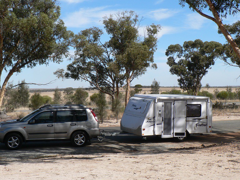

I had a 2006 Xtrail auto petrol which I pulled a small Jayco Feather pop top and also an Avan Aliner camper trailer with for a number of years including around Oz and it did it well. I do not know about the current Xtrail though. Can't remember what the spec's were. When towing I used about 14 litres per 100 kms.
-- Edited by Weevil on Saturday 20th of June 2015 11:17:48 AM
