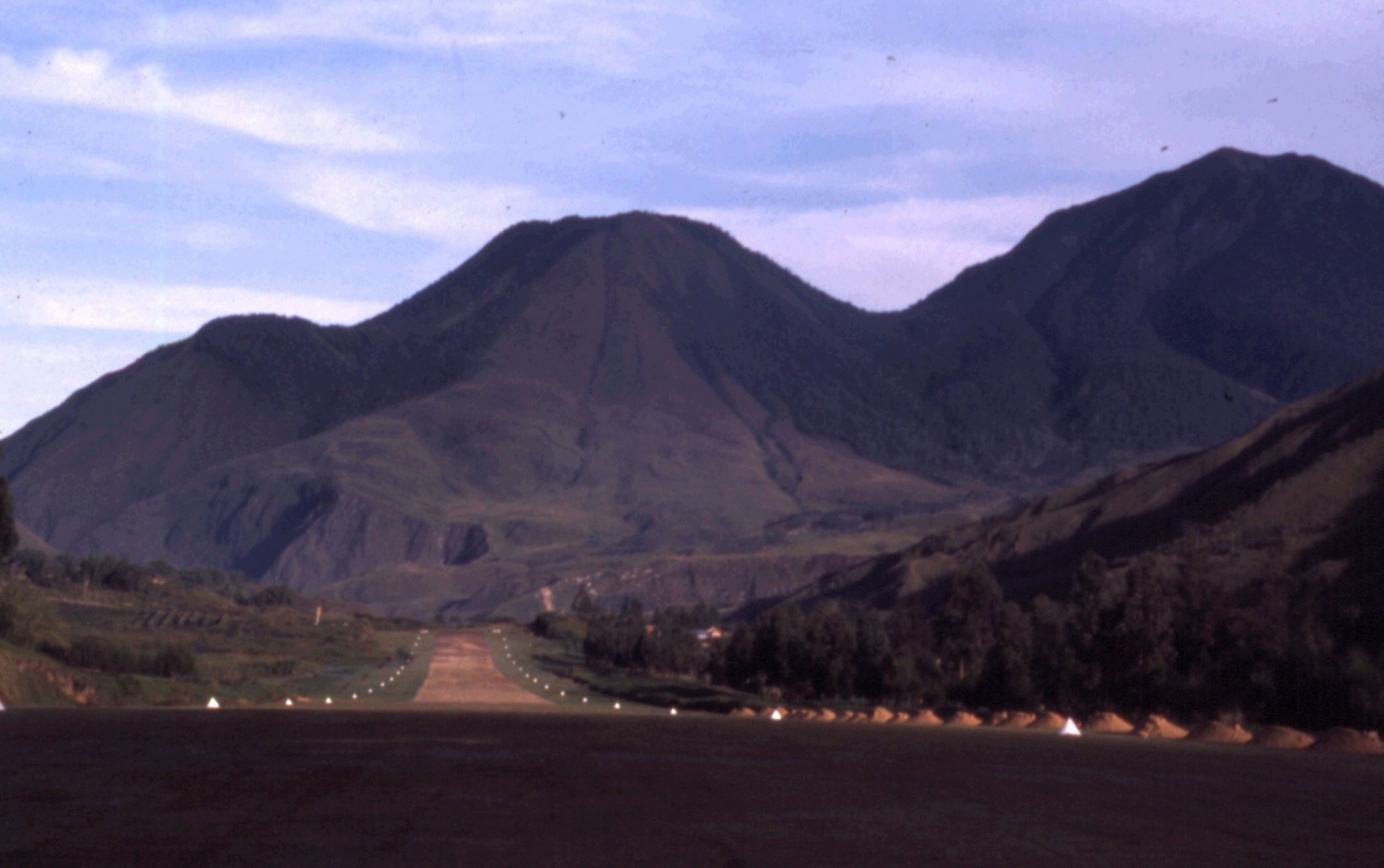

MKA1a Thats the Marawaka strip way down there, the mountains in this country are just amazing.
MKA2 On final approach, you cant change our mind and go around.

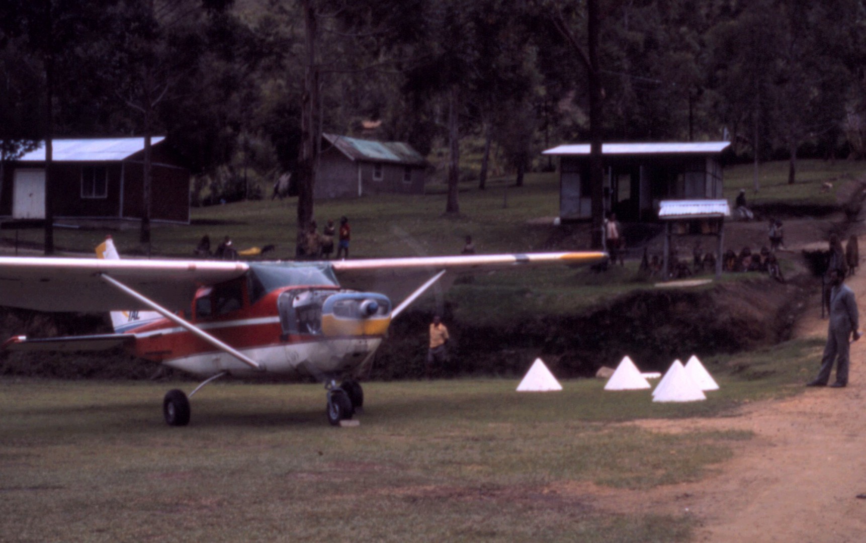

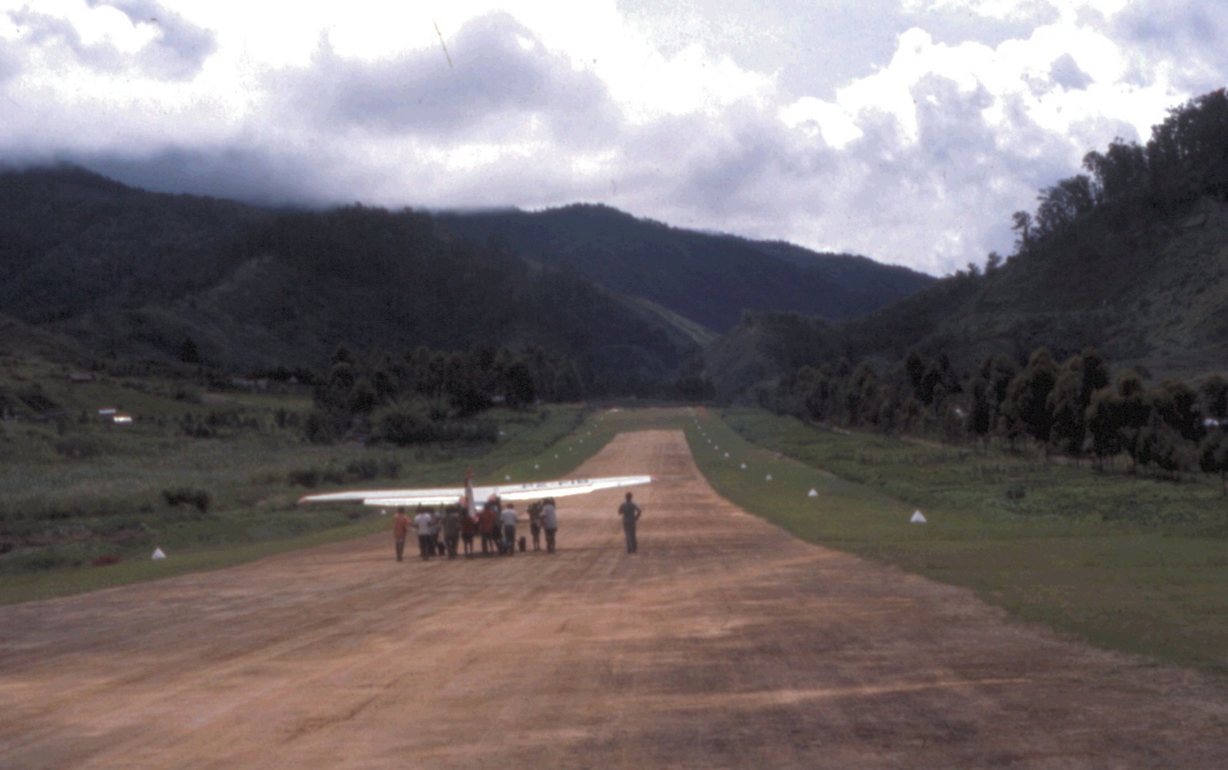

Anyhow we arrived and I think it was on a Cessna 402a with our tools and gear.

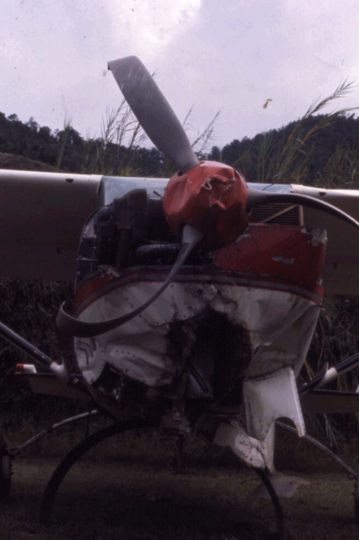

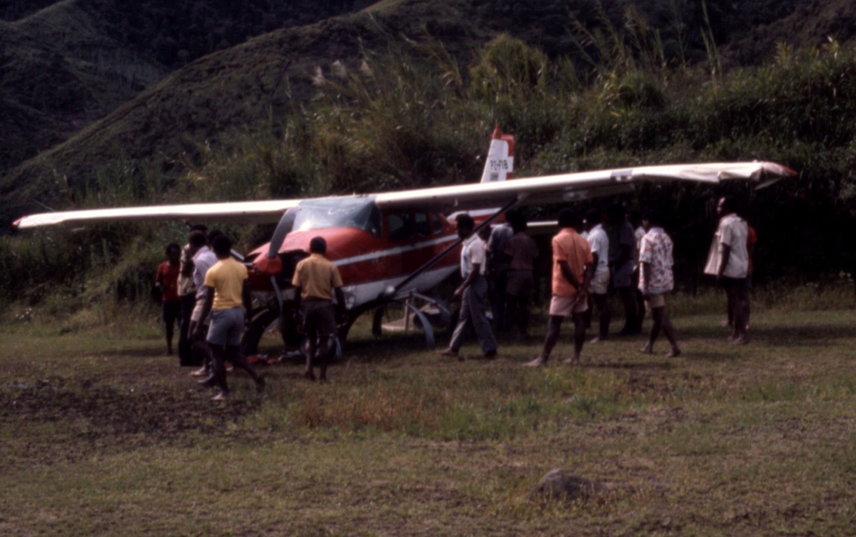

MKA3a & MKA4a The plane looks a bit sick, flipped on its back as well.

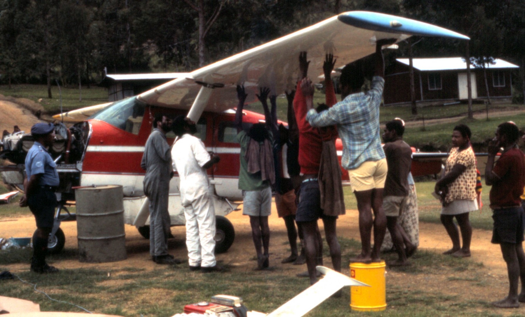

MKA5a It was a long push back to the start of the strip and the village. Many hands make light work.

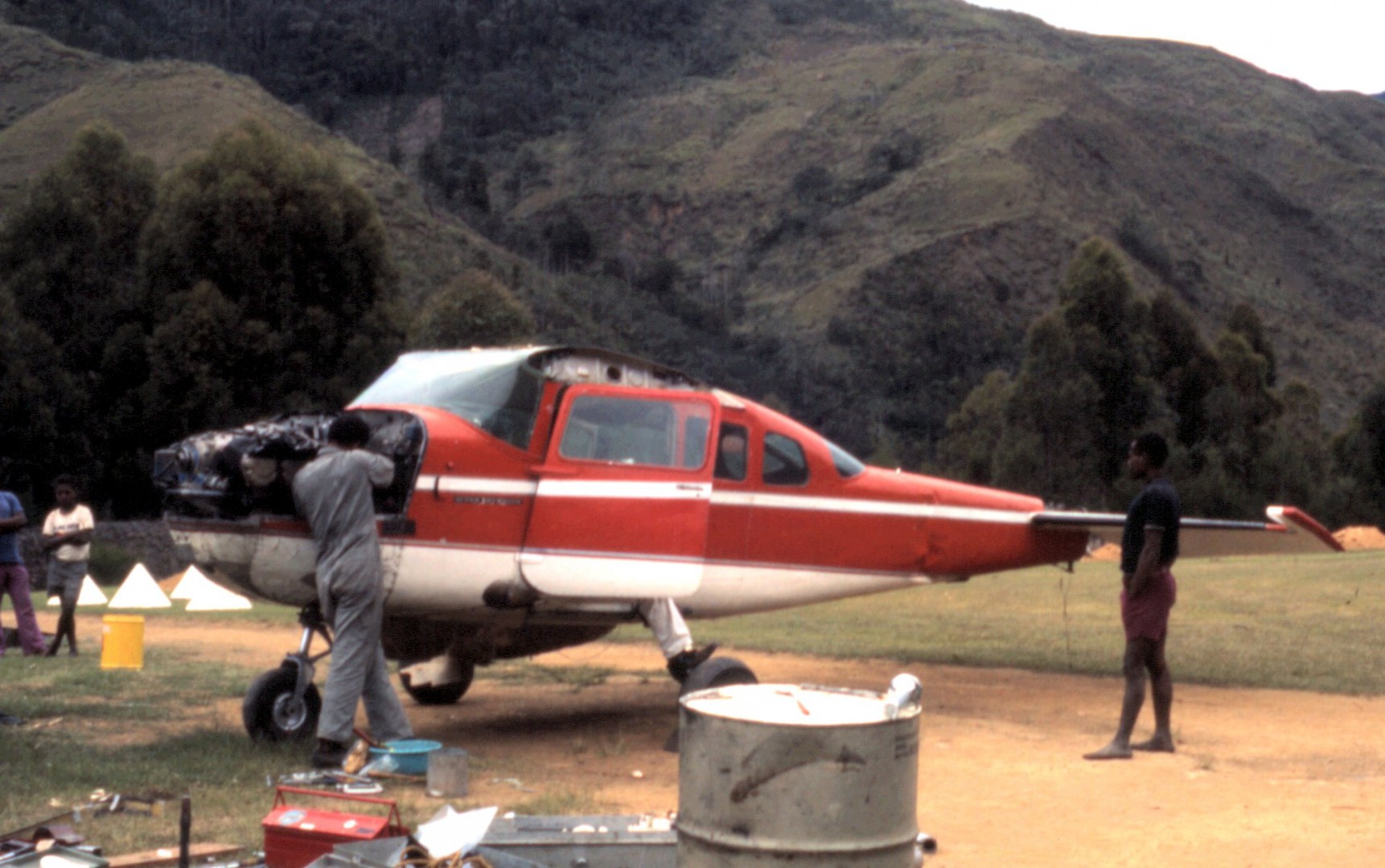

I think we stayed in one of the local huts. Regarding sleeping and eating etc., I don't remember a dammed thing. We worked long hours to get the job done.

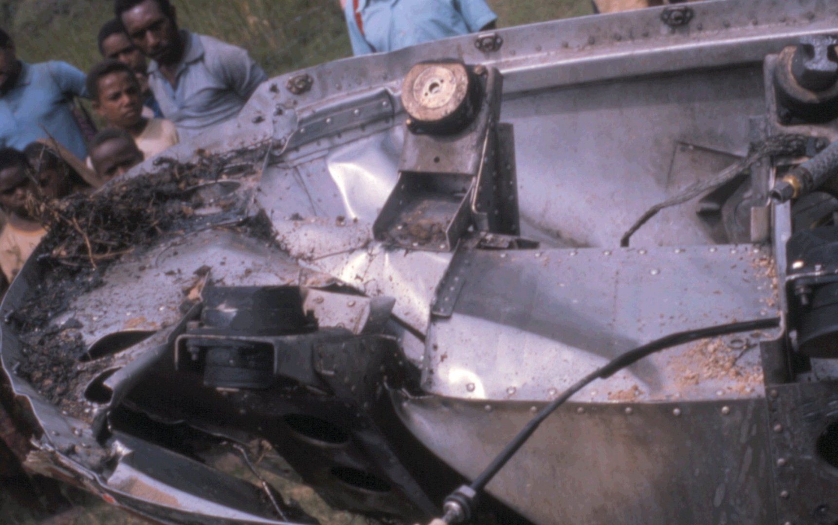

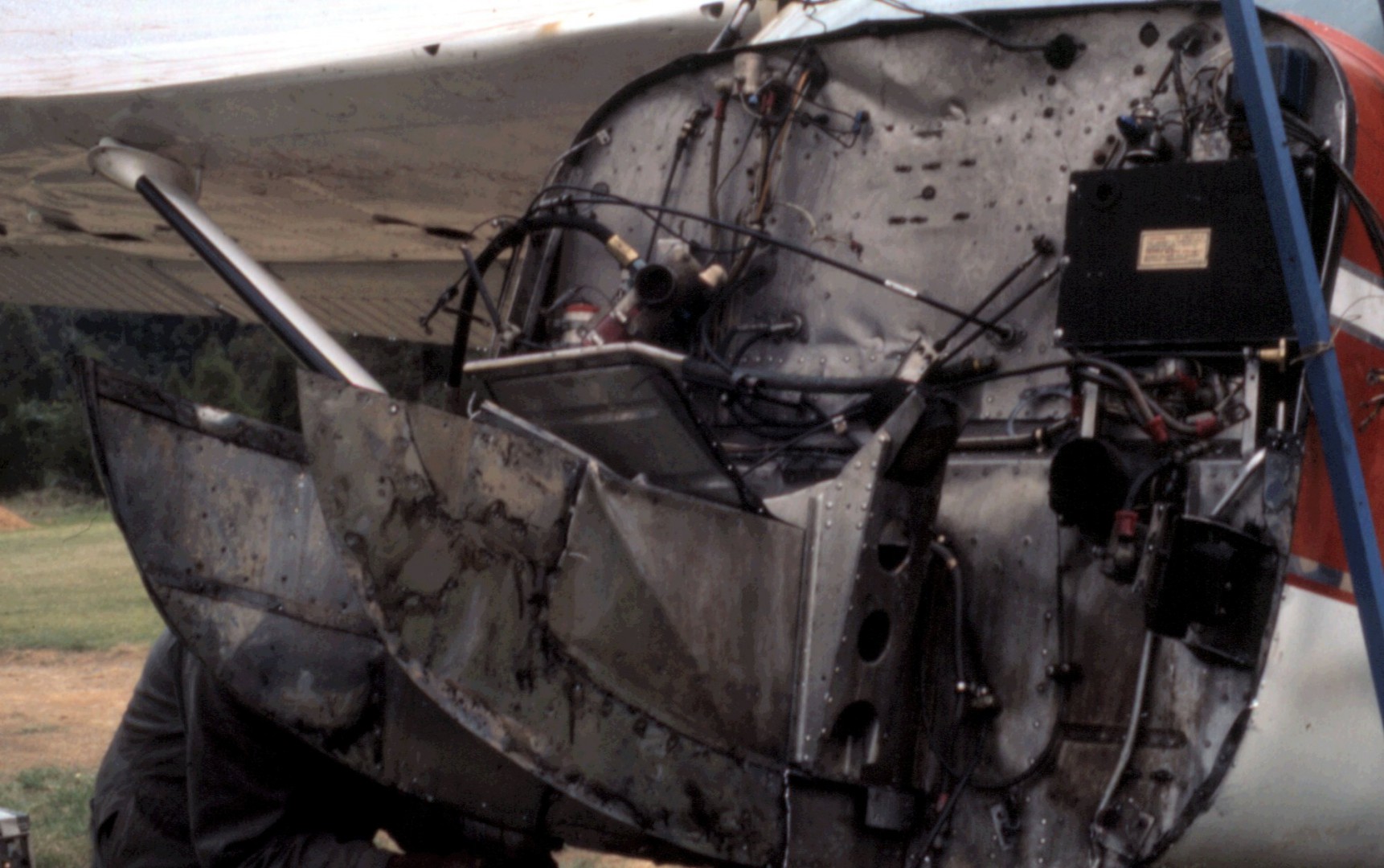

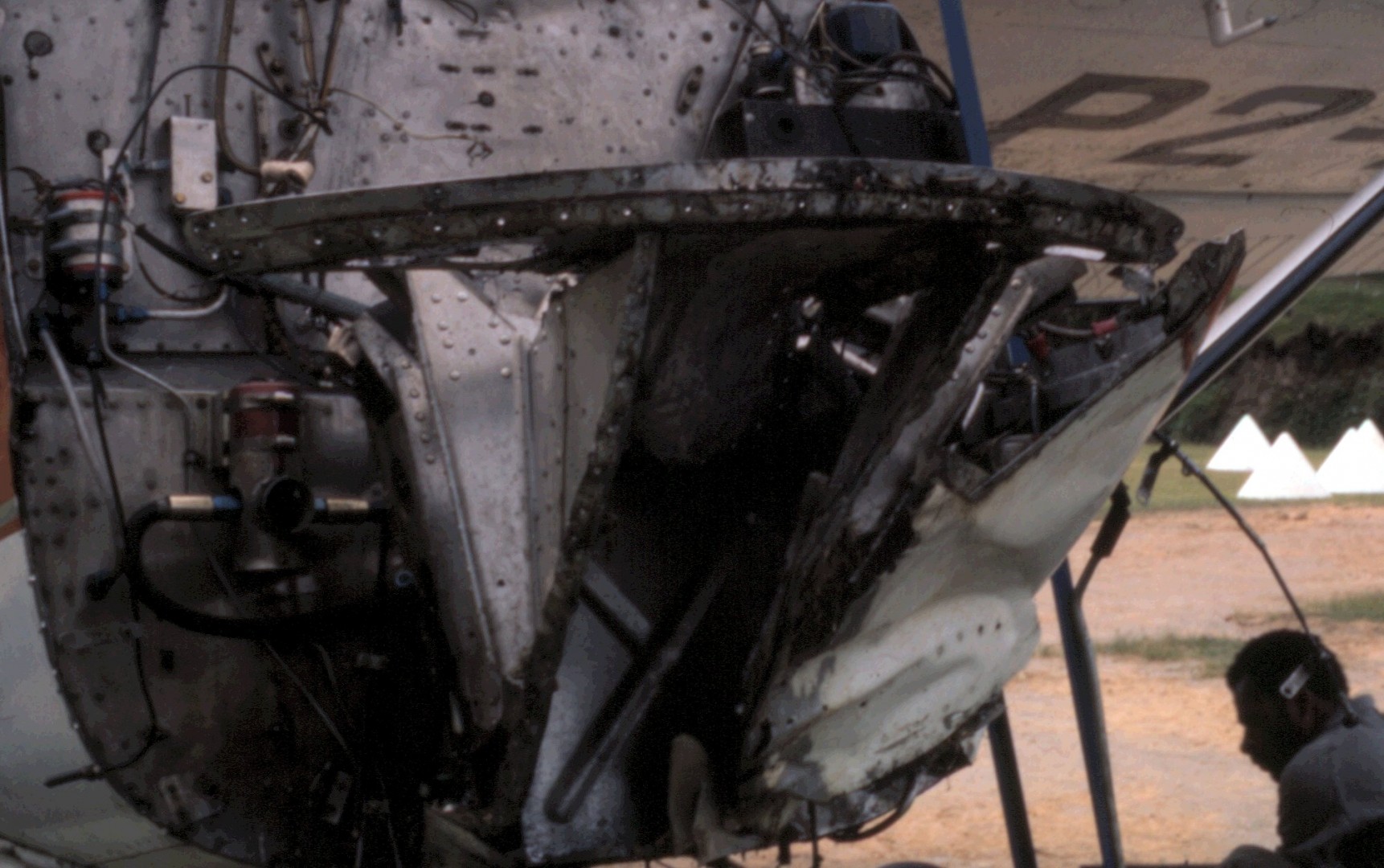

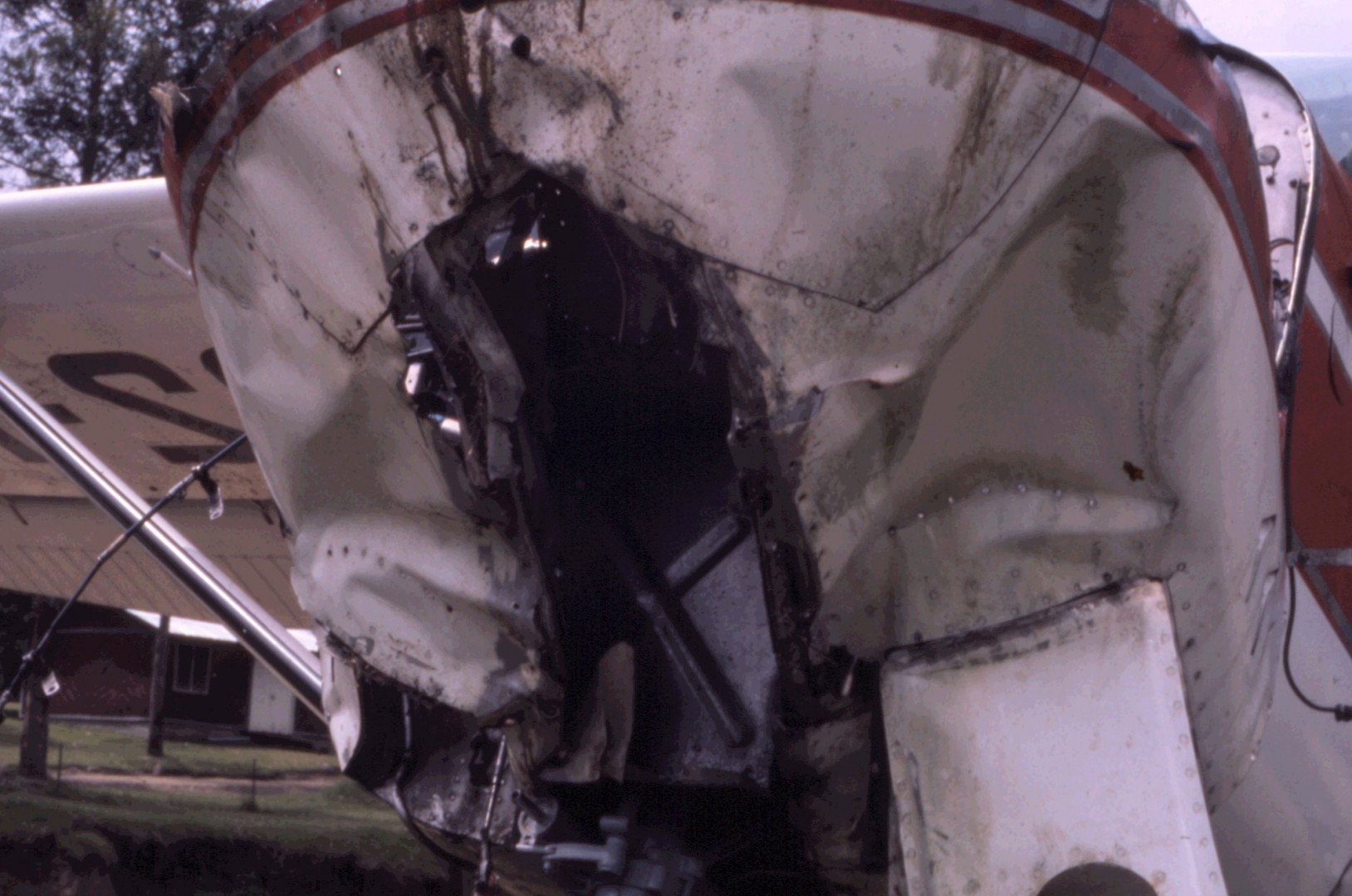

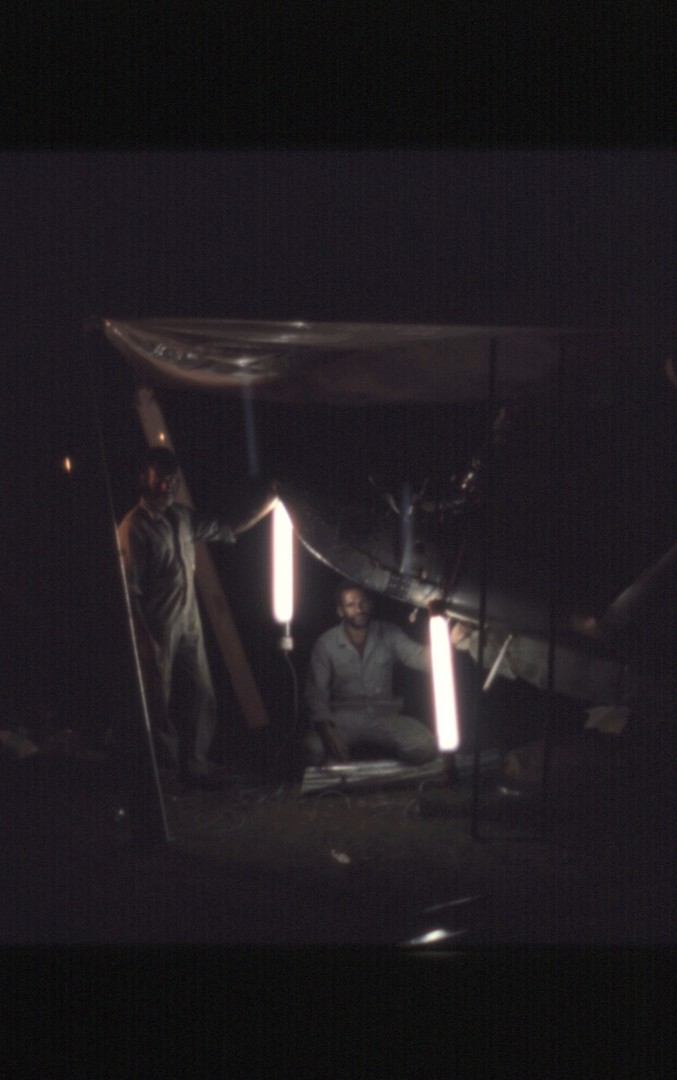

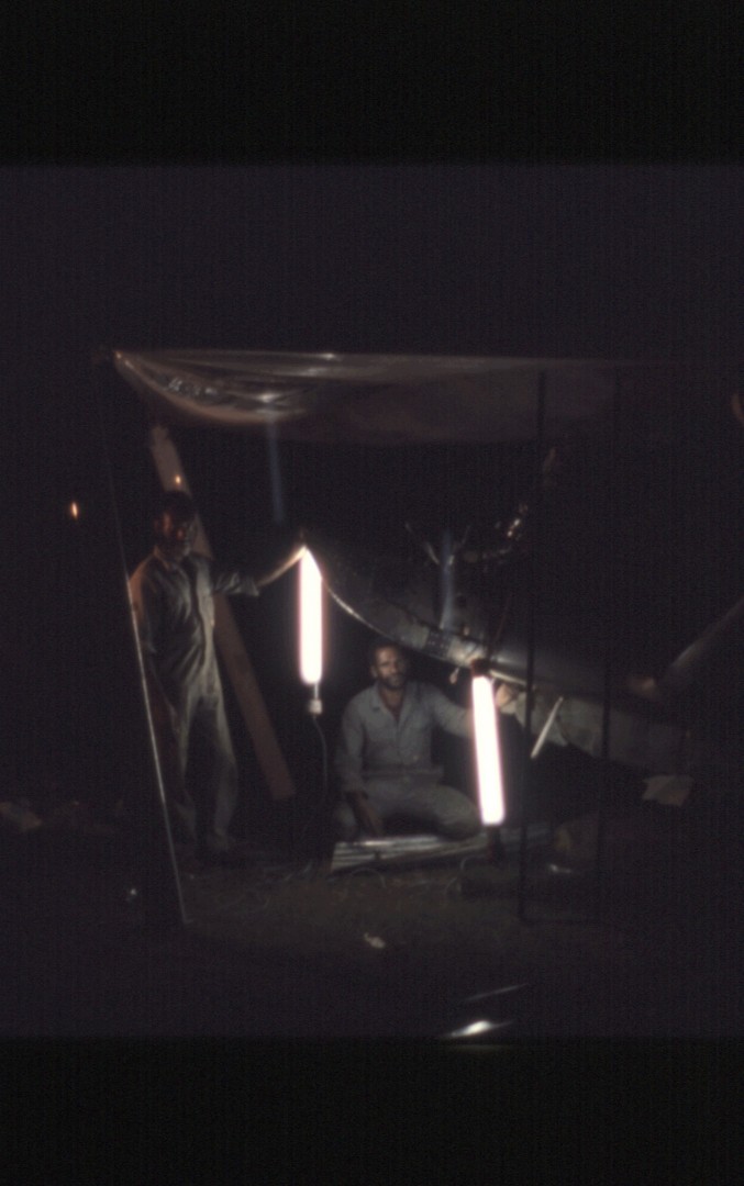

With the engine removed, its all pretty much crunched up. Working from day break and well into the night, we drilled out the rivets, bashed everything to its approximate shape and bolted or pop riveted it back together. All we had was a generator and a couple of electric drills.

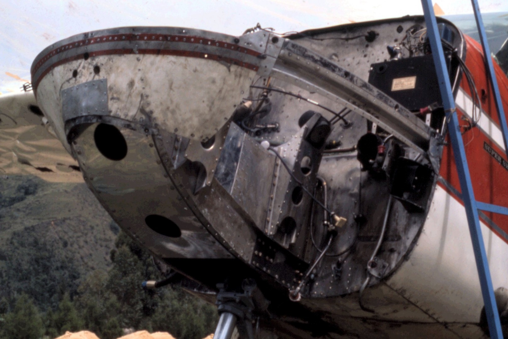

If I remember correctly we reinforced the engine bay with one inch steel angle, a bit of steel plate here and there etc. Sukarno and Jacob my two assistants were as good as they came and together we worked as a good team. We worked from sun up until well into the night.

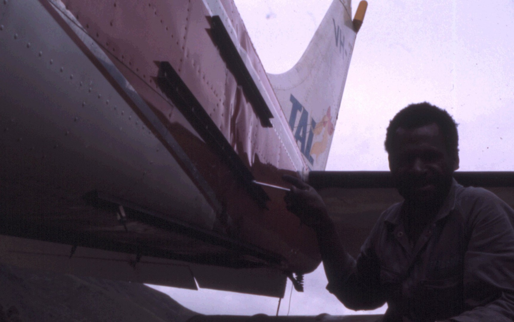

I needed a few spares for this job. Had them delivered by Twin Otter. A new set of wings, tail assembly engine prop fuel etc. The pilot in the picture is Max Parker 2nd chief pilot, test pilot, it was he who flew this poor plane out.

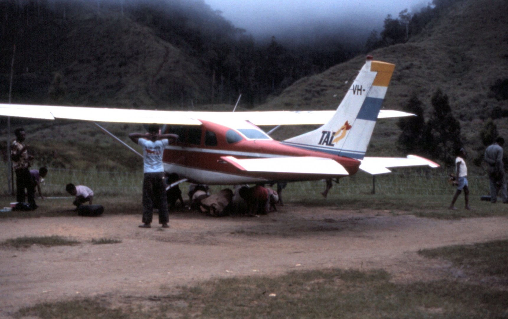

The plane is beginning to take shape. note the constabulary keeping an eye on things, the people watched everything.
The fuselage had a slight bend in it. So we braced it up with some steel channel 4130, bolted in place, looks like it will hold.

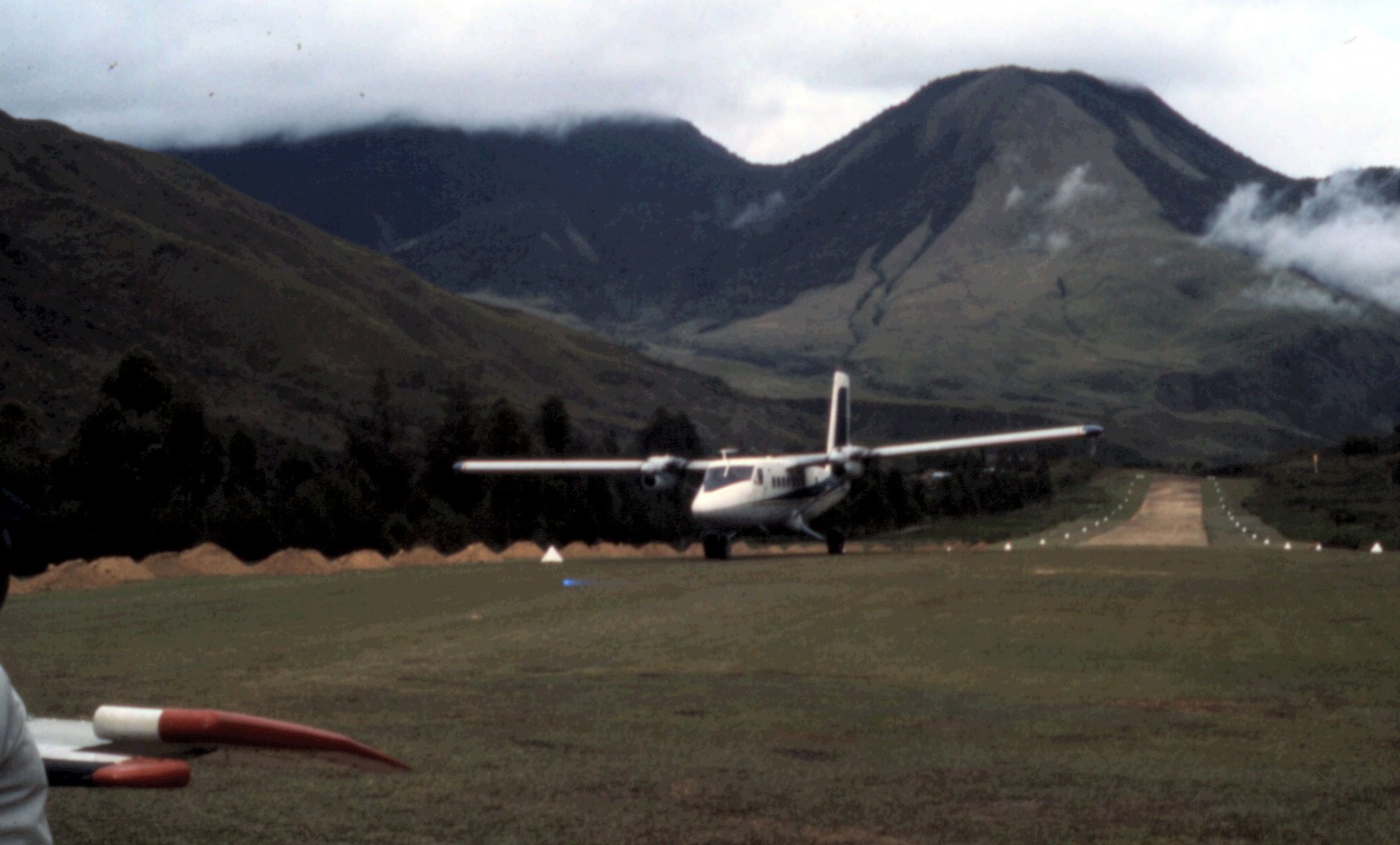

Engine test run and we are all ready to get out of here. That's a picture of the take off run on this strip. Has a solid feel about it.
I haven't got any pictures of the take off or flight back to base, as I was in the plane watching the back of the fuselage in case it started to creak a bit.
The job took about six days to complete.
