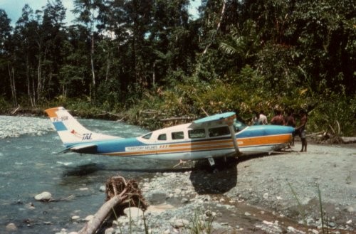

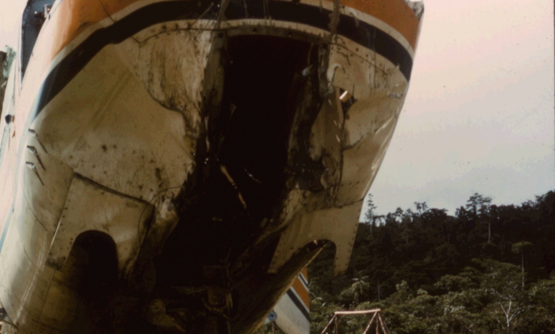

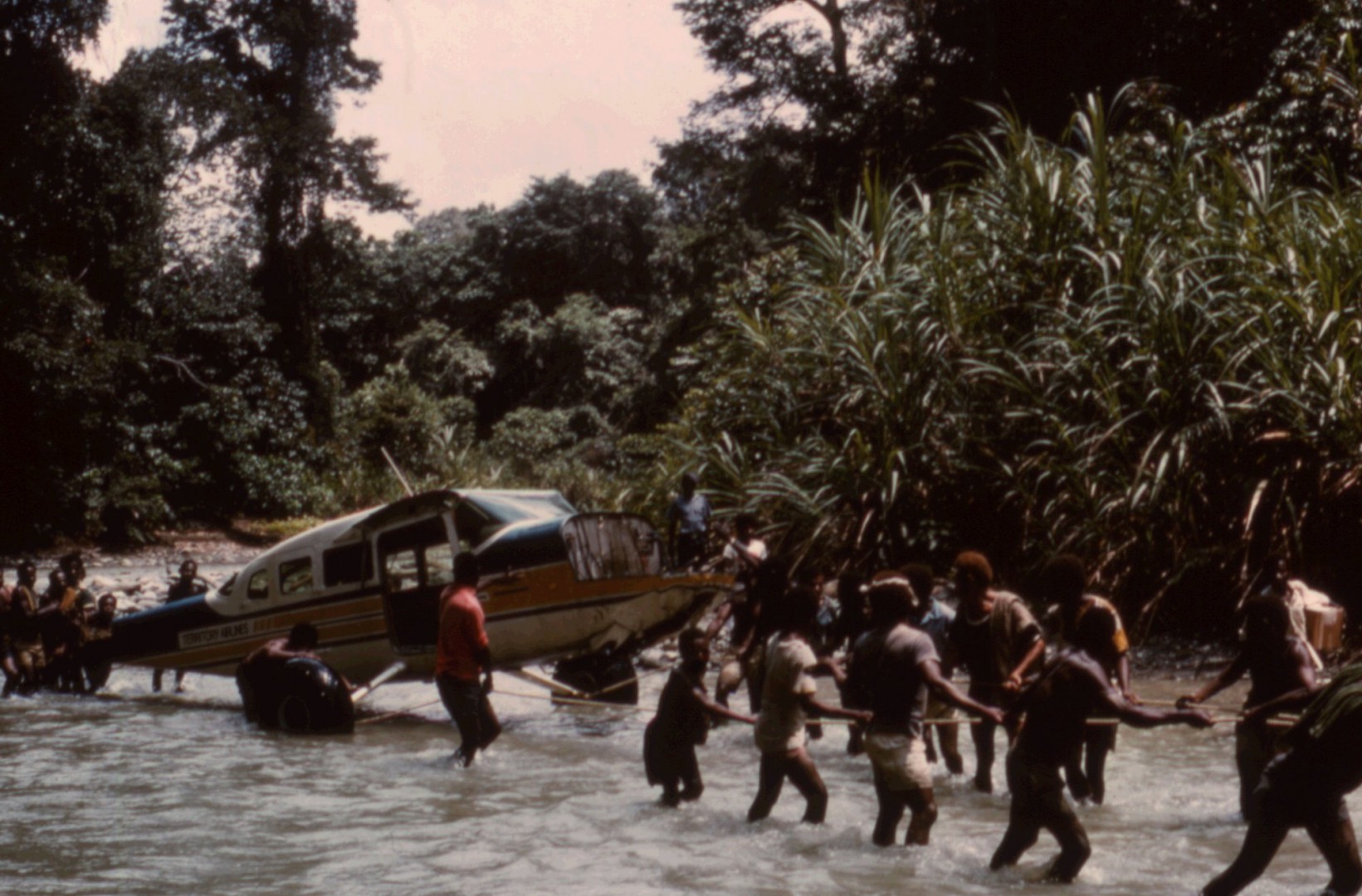

The pilot took off from the Imonda airstrip, near Irian Jira. He experienced engine failure and had to make a forced landing. The area is covered in dense jungle, but lucky for him he saw a bend in the river he was flying over. By landing across the bend he was able to put the aircraft down, no injuries just frightened passengers. Pictures 5-3-1.
We had to get the plane back to the strip. To do this we dismantled the plane, hired 100 locals, paying them 10c each to carry the parts back.

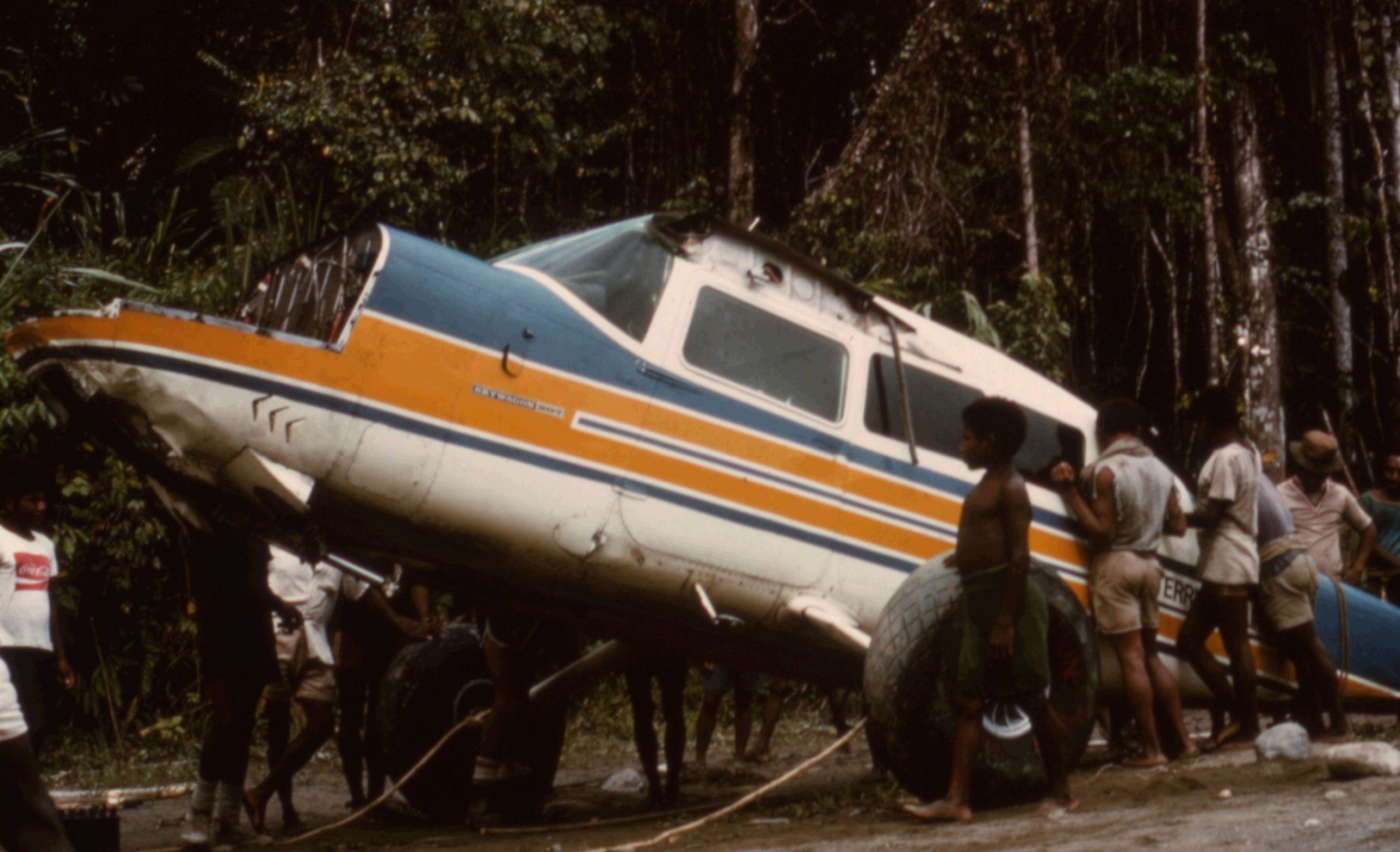

The next problem we had was to get the fuselage back to the strip. The river bed was covered in large rocks and fallen trees. to get over these we mounted Twin Otter wheels on the Cessna, tied on ropes and pulled. We probably hauled it 10km up this river then headed inland, we had to widen bridges and cut paths, but we made it. Pictures 7 & 8.

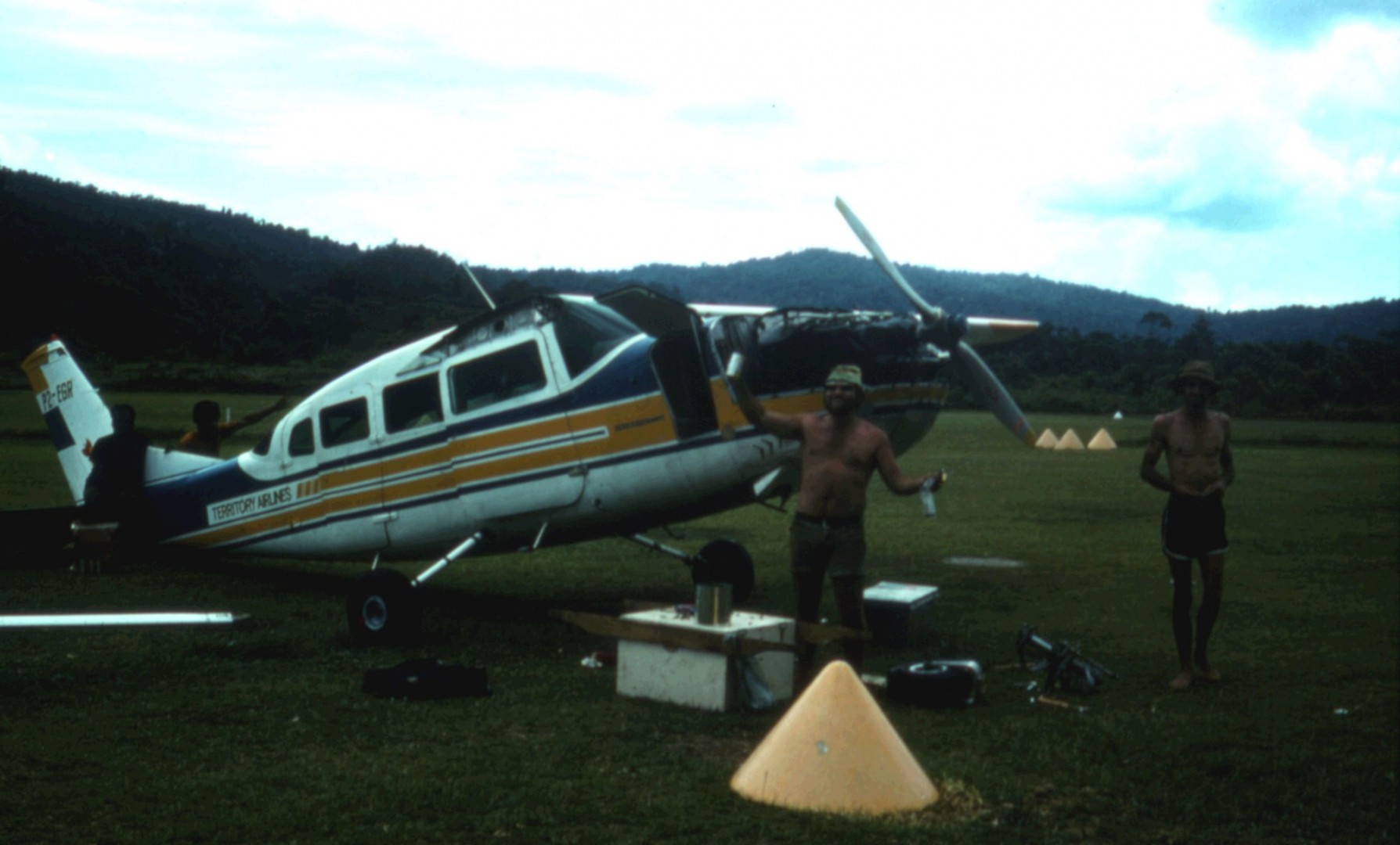

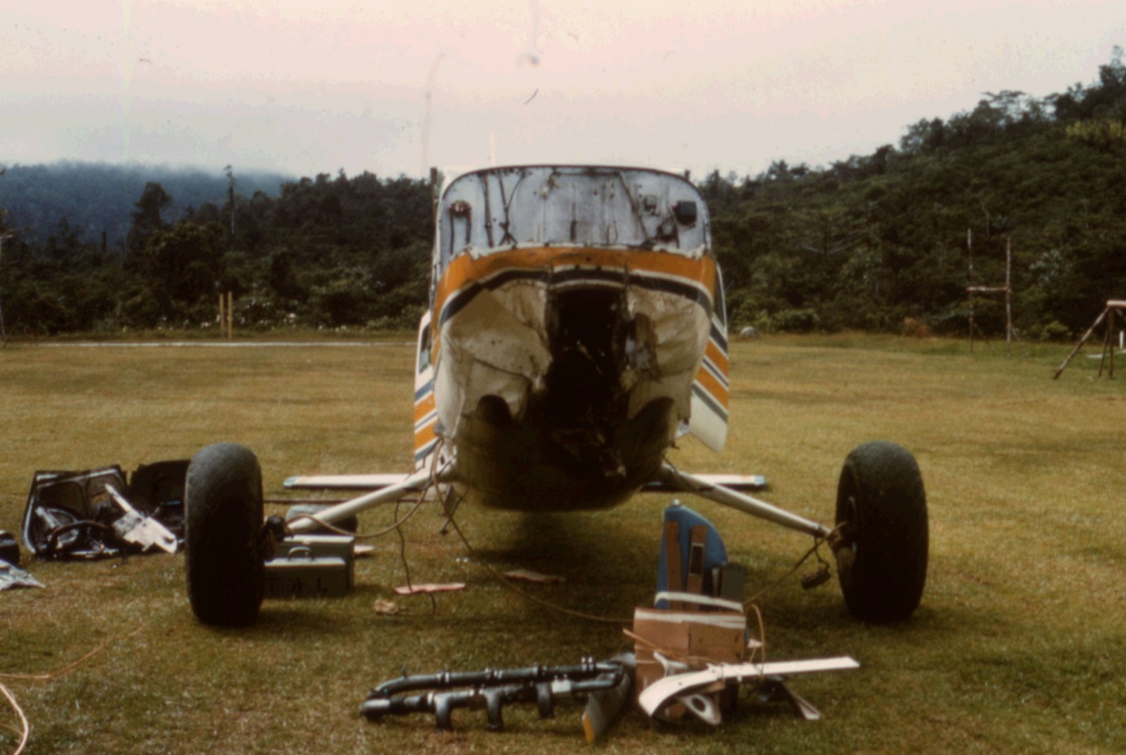

The damage to the airframe was confined to the engine bay and nose gear. I repaired the airframe and my other workmate replaced the engine. We de-riveted, bashed the panels back to their original shape on rocks, pop riveted them back on. We had a couple of the local boys from Goroka to help us, they were very good. Pictures 4 & 2.

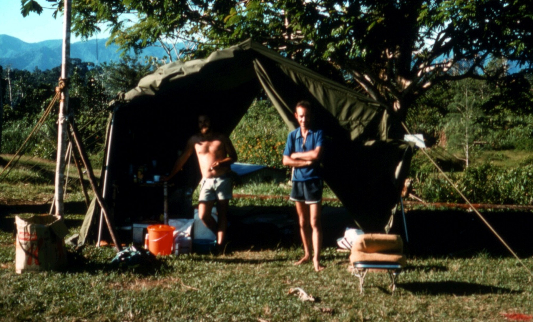

We lived in an army tent borrowed from the PNG army, our communication was via SSB transceiver. The Upright post by the tent is one of the aerial masts. Picture 8.
As you can see (I'm the skinny one) we were very particular about PPE and alcohol was never consumed on the job! Picture 2.
