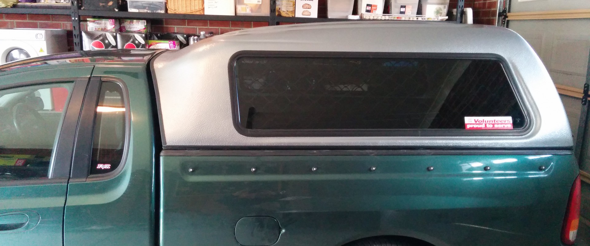

Towed my new van home last week from about 400 kms away. Tug was my ute without the canopy. Tons of power & torque (XR6 Turbo) but I could feel the drag over 85-90 kph. The instant fuel economy was a tad average at times too. Looked on-line on Thursday night and found a suitable canopy close-by. I'm hoping that it will improve my aerodynamics.
