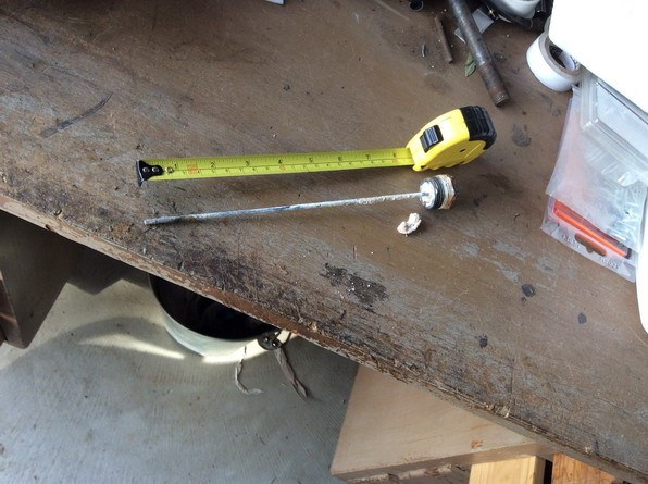

Checking the anode has been on my to do list since a thread or two made me aware of what can happen.
I was working on a couple of jobs in the van and decided to have a look at the HWS anode. After finding a suitable tool I removed the anode with these results. Yuck!!! I will need to flush out and replace anode..
Should have been replaced some time ago by the look of it. Suggest you change it before all of the alloy has gone usually around every 12 months. I check mine very 6 to 8 months and always carry a spare. Leaving replacement too long will increase the rate of corrosion of the tank. The regular checks also ensure the tread doesn't get corroded up making the removal difficult and it can be flushed out at the same time.

Must check mine.. They said it was replaced before I bought it..
You can trust (????) what a salesperson tells you... Lol

Just replaced mine too .. the first one with the new van.
Fortunately I don't over-use it and the anode-alloy was was about 50% of the original ..
'twas my first shot at doing it and found it quite an easy process ..

I reckon you've had a good run from that anode LOL

You were lucky! I'm paranoid and check it regularly to avoid the gunk clean up. Takes a lot of water to flush it well and get it all out. I use a tooth brush to poke around inside and get the big lumps out....
