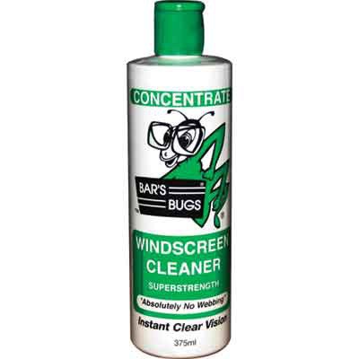

Yep We carry enough crap now. I use 100ml of metho and 100ml of Bars Bugs and it works well for clean screen but no good for killing algae. Need a bottle of pool algicide now.

I always use good old Bars Bug and a bit stronger than normal I have a 4.5 ltr washer bottle and would use it up in a week so the water is never very old

Ditto Hats,,, used it for years. It also softens the rubber when applied direct by a rag.
