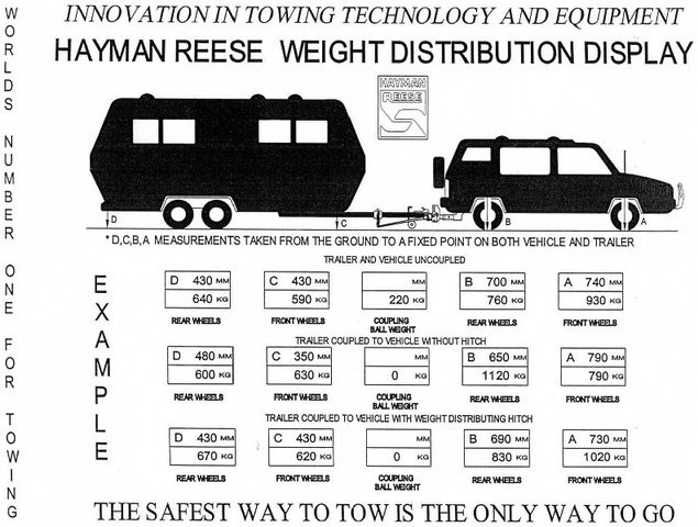

How have you calculated your carrying capacity of 400 kg. Generally the loading capacity of Falcon utes is around 8-900kg depending upon model. This loading includes everything that adds weight to your vehicle. That includes driver, passenger, fuel, stuff in the cab, load in the tub, weight of tow bar, canopy or ute lid and the ball loading of the van. Also if you don't have WDH then the weight removed from the front wheels when you couple the van (remember the front rises when you hitch the van) is carried by the rear axle. That weight transfer will be the ratio of the ball overhang length to the Falcons wheel base. That will amount to +/- 50% of the ball weight extra weight on the rear wheels. You may have to subtract a lot of that extra weight from the loading in the tub to reduce rear axle loading.
The following diagram demonstrates the effect of using and not using WDH.

Thanks for that chart. I saw a youtube video from Hardings on fitting a WDH that I was going to watch again. Your chart reinforces the video. I used have to do that towing a camper trailer behind a front-wheel drive.
