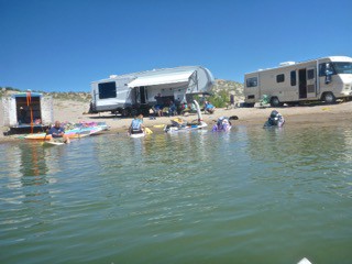

Know one guy who has a large camper shell of a 450 (1.5 ton) 4 x 4 diesel with which he pulls a toy hauler trailer (BMW and dirt bikes). He has a total of 1.8 kW on camper shell and trailer with battery suite in both and connector cable from trailer to camper shell. He also has additional panels on side of camper shell which he can swing up and lock in place for the total of 1.8 kW.Have run into others when boondocking that use combination of fixed on roof and movable panel in US.
Photo is camped at Elephant Butte on Mothers' Day Weekend with older son and family, daughter and boyfriend etc. Ran 1.7 kW a/c unit for 3 hours during day from solar/battery suite.
Reed and Elaine (currently in New Mexico, USA)
2006 Chevie 3500 (1-ton) 4 x 4 diesel (6.6 l with dualie rear axle) with 45 gallon Transfer-flow auxiliary diesel tank
Open Range 34' (10 meter) 5th wheel
1.4 kW in panels (2 sets of 3 x 235 W panels in series for 90 V to controller)
TriStar MPPT-45 controller
8.7 kW-hr (48 V nominal) LFP
Magnum 4.0 kW PSWI
508 W Mean Well 48 to 12 V converter
All LED inside and out
1.0 kW Honda generator (never used in two years except to make sure it still runs).
