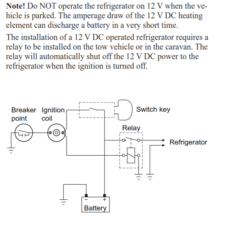

Absorption fridges should not be powered from batteries. They are only supposed to be run from the alternator of the tug if you wish to run them off 12 V. A fridge 12 V element is one of the best ways of over discharging batteries and buggering them.
Here is Dometic's instruction for fridge installations. You will see that they recommend an ignition controlled relay to protect the battery.
Thanks so only put fridge control on battery when in transit

Hi
Definately do not run any 3way on 12v from the van battery & only from the crank battery while the engine is running
Your model fridge [model number please?] may have an inbuilt isolator but if it does not you should have an isolator fitted to prevent discharging the crank battery
A voltage sensitive relay gives the best protection, next is the ignition controlled relay as shown in Peter D's post

The fridge in question, is a 3 way which when run on 12v will draw about 10 amps of more. The 80Ah battery they have would be dead in about 8 hours. You on the other hand have a much larger battery and fridge that uses much less power.

Hi
