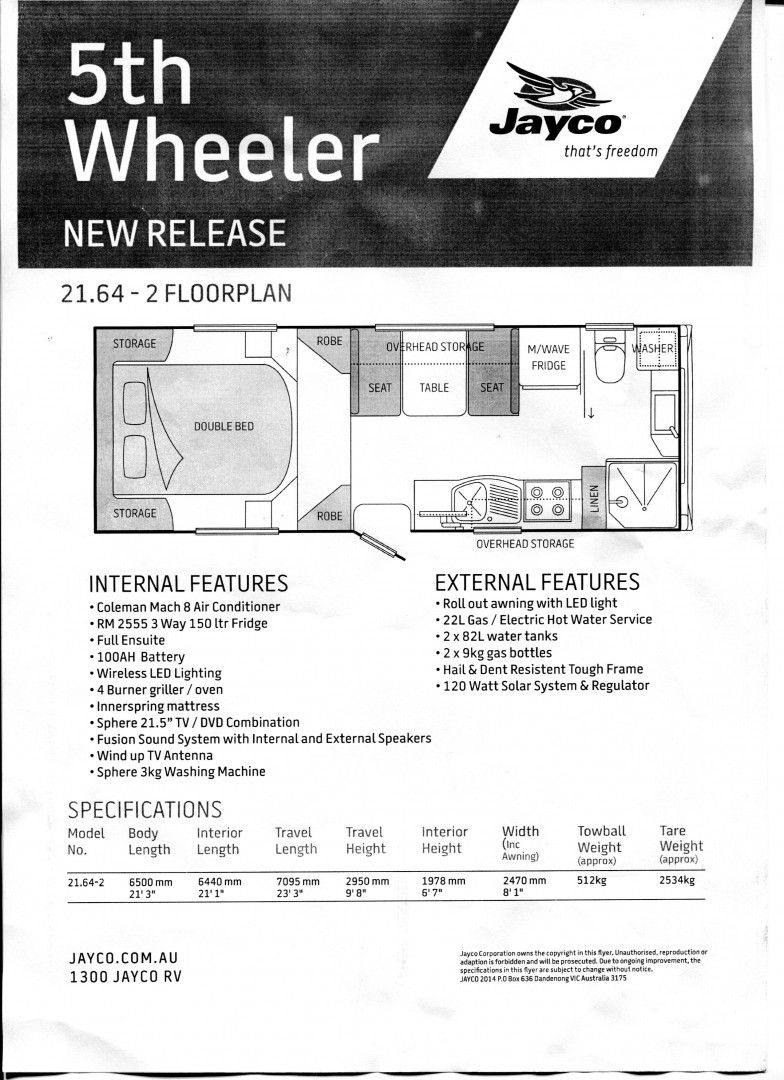

If there are just the two of you intending to travel there are many advantages in towing a 5th wheeler.
1/ Where a caravan is unstable when towed, a 5 wheeler is self stabilising. I.e. self corrects if a sway happens.
2/ Usable area in the van verses towing length is much better. No draw bar, part of the structure is over the tug.
3/ Tight turning circles and I believe easy to back.
4/ Easy to hitch and un-hitch. No sway bars or load distribution bars required.
5/ The towing and load forces on the vehicle are where they should be, over the back axle of the tug.
6/ Utes are now very comfortable, powerful and there is a good second hand market at the moment.
7/ Australian made 5 wheelers are made from 18 ft models up to what ever.
8/ Design layouts are not so restricted by balance as are caravans.
I have attached a brochure of the new Jayco model which is 22ft long but would have a towing length of about 18ft or less. It is new in the $70,000 mark, which is comparable with a large caravan. The hitch costs about $4000 to fit.
Considering the safety benefits alone, these vehicles are worth a look.
