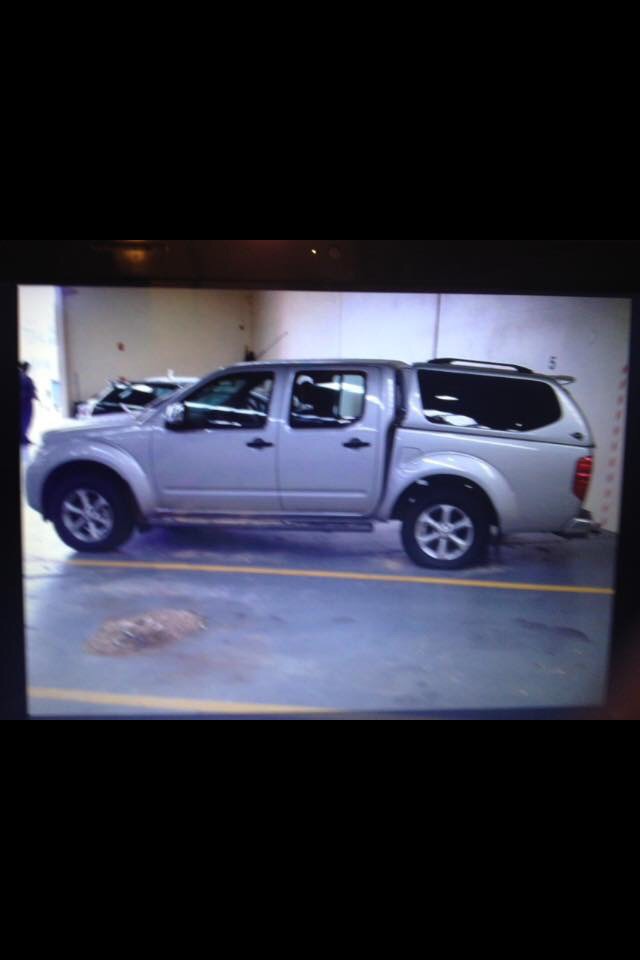

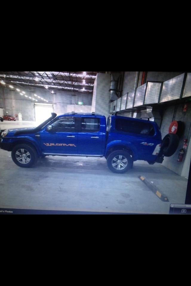

A friend told me it was because of the curve at that point on the chassis rails. They are Cold pressed which can cause a weakness in the metal. Sounds logical but not sure if that is the true reason.
elliemike said
11:08 AM May 28, 2015
Air Bags fitted to Elliptical springs can create this.
Or overloading a trailer/caravan. That has excessive Ball Weight.
Saw one come in like that while in the Flinders Range last year, at the Great Wall. Young fella and family, very new 4x4. His mates told me he had stored water and extra fuel in a utility box fitted to the (extended) "A" frame of the Camper Trailer. They estimated he had 200 litres stored there. They were not amused as it had ruined their 4x4 trip. As they had to Tow the camper and nurse him back to civilisation. But I did feel for the guy. They had bee doing the Strezleki I think.
-- Edited by elliemike on Thursday 28th of May 2015 11:16:25 AM
-- Edited by elliemike on Thursday 28th of May 2015 12:41:42 PM

What has caused these two popular tow vehicle,s to hunch there back like they have.
Lance C
I do feel for the owners and tell you that for free.
This problem has been happening for quite some time now & like said over loading, airbags & to big of vans etc etc, its time people realised this & bought suitable vehicles.
Dare say the insurance companies will be looking at the over loading in these cases.
JC.
