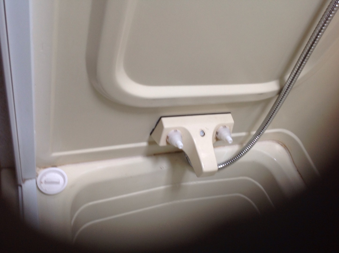

How are the shower taps generally held on ? Is it just the tap cover ? The shower connection has come lose . I need to replace it . I'm not well designed for these tight areas .. Fitting new shower hose is easy they said !! Sheesh .
hako said
01:04 PM May 27, 2015
There are many different designs...a pic would help.
dragonfly1 said
04:03 PM May 27, 2015
On the underneath side there is a little plug just flip it out with a screwdriver and then use a small Ellen key to get the grub screw out

Here's a photo . Yes off to YouTube .. I not bad at maintenance .. A socket set , screwdriver and a pair of pliers isn't going to fix this.. everything works except shower outlet is broken or leaks .. Now the minister of the house can't find the new one !! Sheesh! We are home now ..

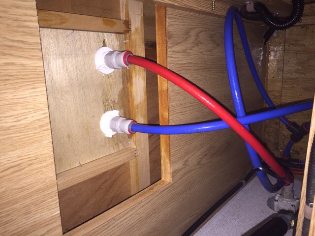

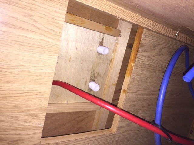

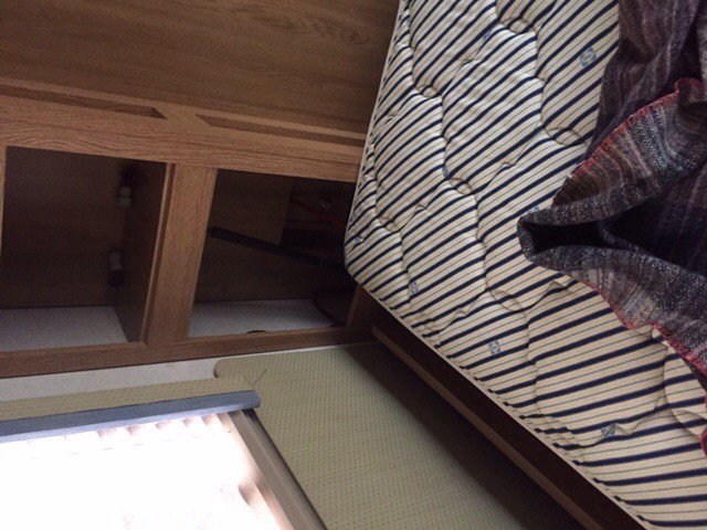

Replaced.. Removed panel beside bed.. Disconnected .. Replaced and hooked up push in water pipes..
