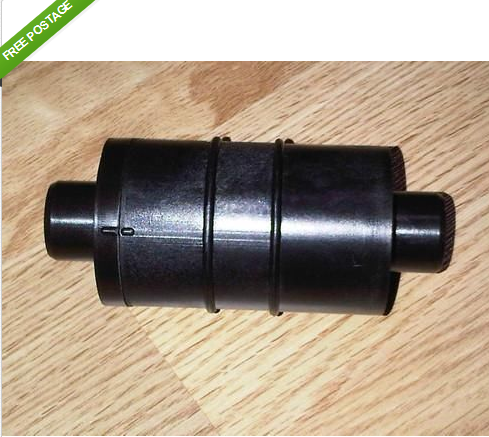

I installed a Air Intake Silencer,it does make it quieter.It cost approx.$25 dollars.

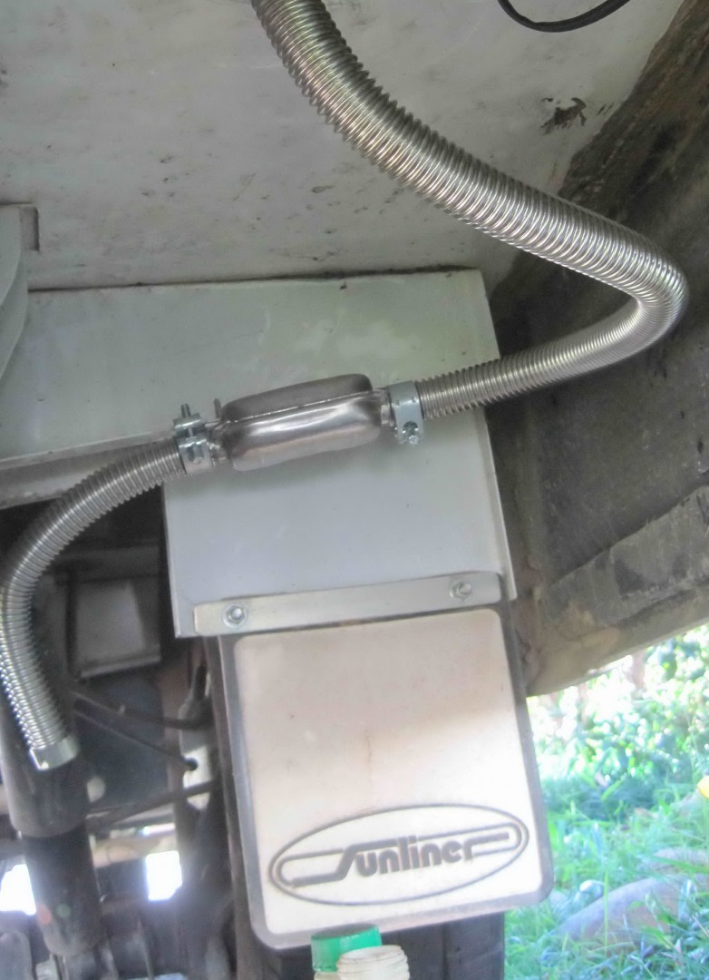

Yes I see that.. Our one is so quiet outside you only hear a slight shsh noise.. The exhaust is that crimpled flex pipe..
I has its own baffles in the flex pipe.. yes there is a silencer on both sides..

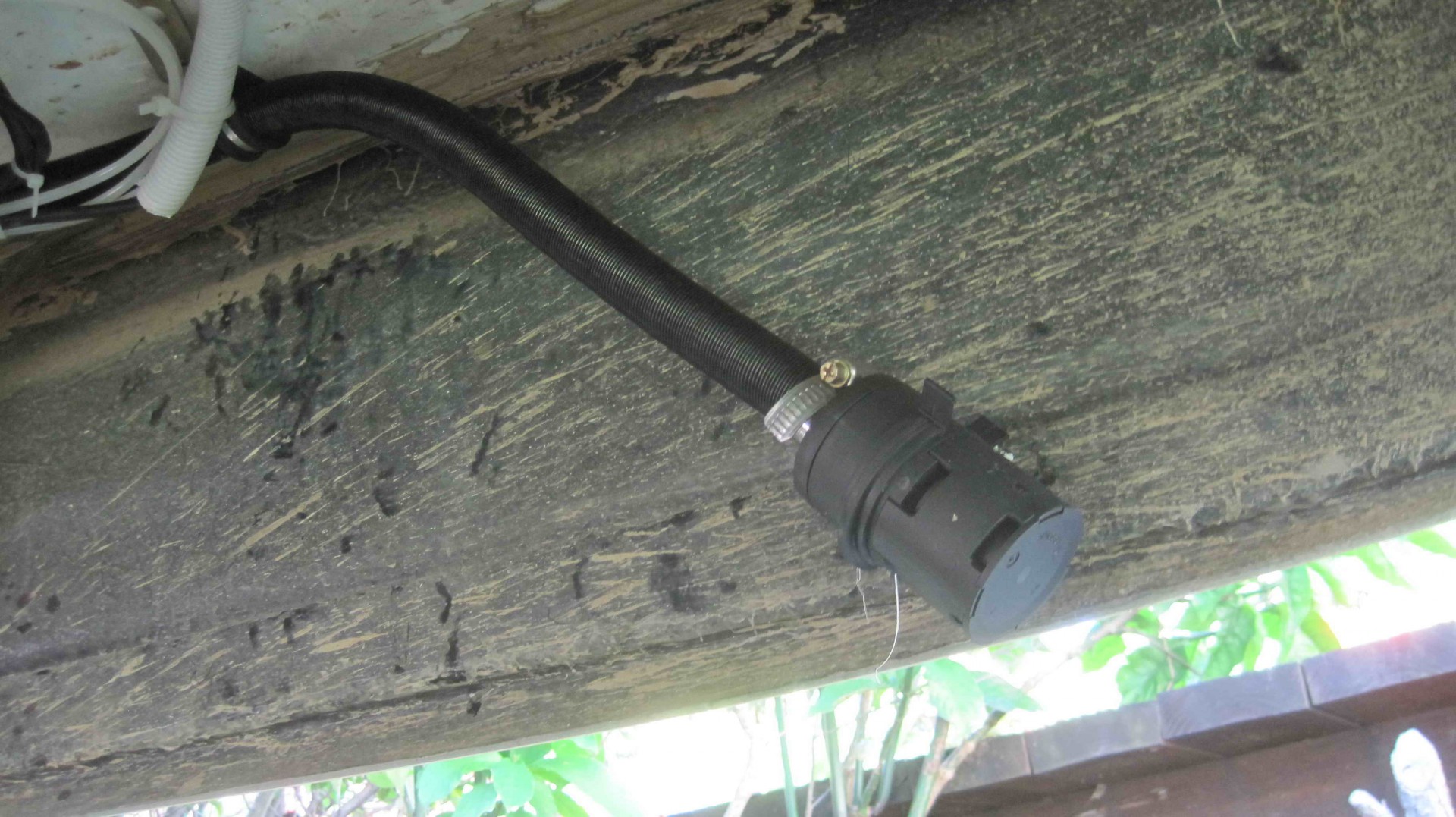

The silencer that I was thinking of is on the air intake pipe underneath the van. I had the heater running at it's maximum and I got under new the the van and the audible noise was coming from the air intake not the exhaust hence the thought of a silencer but as another poster has said they are at silly prices. I am now thinking of a mower muffler or a air compressor air intake these sell for around $5 on eBay.
got it from Graeme Yost,at
It looks like this
