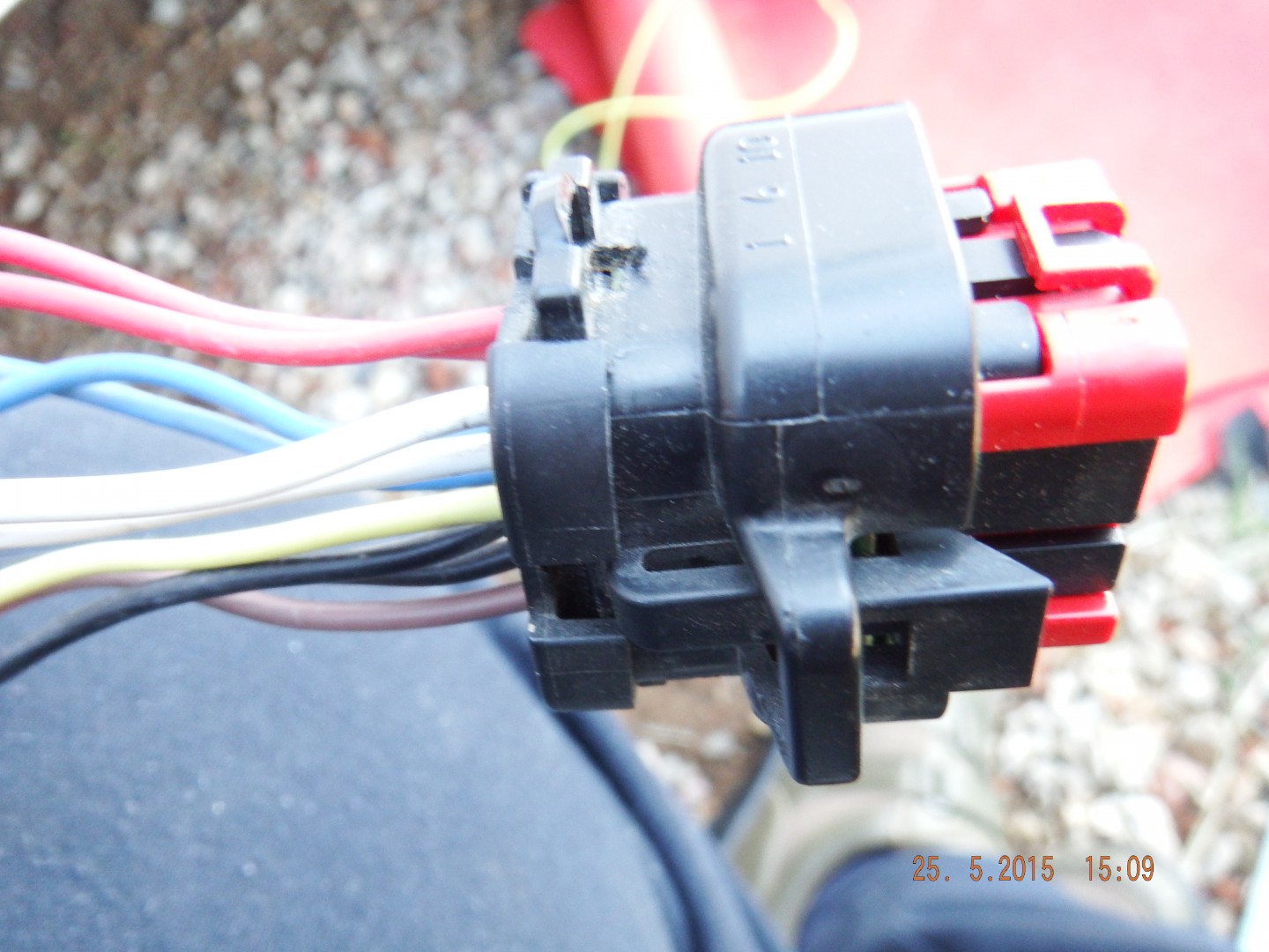

EL KO will be shocked to hear this problem. How about someone who actually had this happen (that's you Phil) email them. They are very customer focused and take their product safety and installation seriously.
If they hear that Jayco, a Dealer or sparkie did this - they'll be on that outfits case and also review their installation instructions (if its needed)

I agree with that Bruce, whoever made that loom really screwed the pooch. I'll find the address and get an email in the system.
I thought about reversing the connections in the 12 pin plug but didn't like the thought of what earth being positive would do to other stuff on the circuit.
I am planning to run a line via a fuse from the 12 volt fridge terminals to the ESC. Does anyone know if this is legal? The original feed comes from the trailer connector so I don't think there can be a problem. Advice would be appreciated.

Gee Possum, a number of good people on this forum would be up in arm over that manager from Avida. Standards are the bible, and MUST be complied with. My experience with auto electricians is not a good one, mind you a number of them are excellent however there are a few Cowboys out there as well. I guess the same applies to sparkies.

Jim, just make sure the lights come on and turn green when you hitch up the plugs. You may also need an adaptor from the tug to the van if the van has LED signal lights, that will depend on the type of tug you have. My Ford Ranger didn't like the LEDs at all and I was given an adaptor from our Ford dealer.
Cheers, I don't think you will have an issue, just do a complete look around and make sure everything is working properly Before you leave the dealership.

Ive got to tell you I was a bit peed off when I found those cables inverted. I have contacted AL KO and Jayco, still no response from AL KO but Jayco can't believe their eyes (company line) I am very keen to see what AL KO has to say.

G'day Bruce, at this stage I hadn't heard from AL KO. It's near a week now so I will phone them next week to see what's what. Because I'm an electrician I can fix the thing myself and I'm not interested in reparation or compensation. My big deal is how many more Jaycos are there with this issue? I was blindly towing thinking the ESC was protecting me, lucky we didn't REALLY need it.
The big deal I now have with Jayco is that they haven't got back to me. Two issues with one system transposed power and wrong pin. I swear my van was a late Friday afternoon job on a long weekend, built by the work experience kid.

Hi folks
I have finally found the problem with my ESC.
After the brake repair I pulled the ESC off the van and ran a continuity check back to the 12 pin connector.
To my shock and horror the positive and negative have been transposed ON the ESC connector (according to the book).
I am going to change them and let you know what happens. Pic shows the 2 white wires where the 2 red wires should be.
