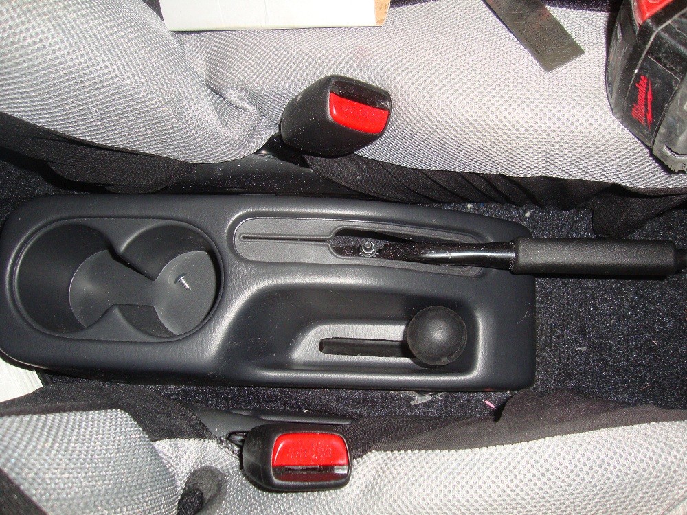

Hi Kelpie He has a Birdsville on a Fiat base.Max tow is 1500kg and max ball weight 100kg.Very hard to make these figures with a Jimny + a trailer I think you will concede.
as i have said earlier there is a modification for the Jimny drive train called a "wizard" This allows to flat tow them but it costs around $2200.00 Works by disconnecting the tail shaft i/e a dog clutch
(see Pics 2 property of SuzuiSports)
