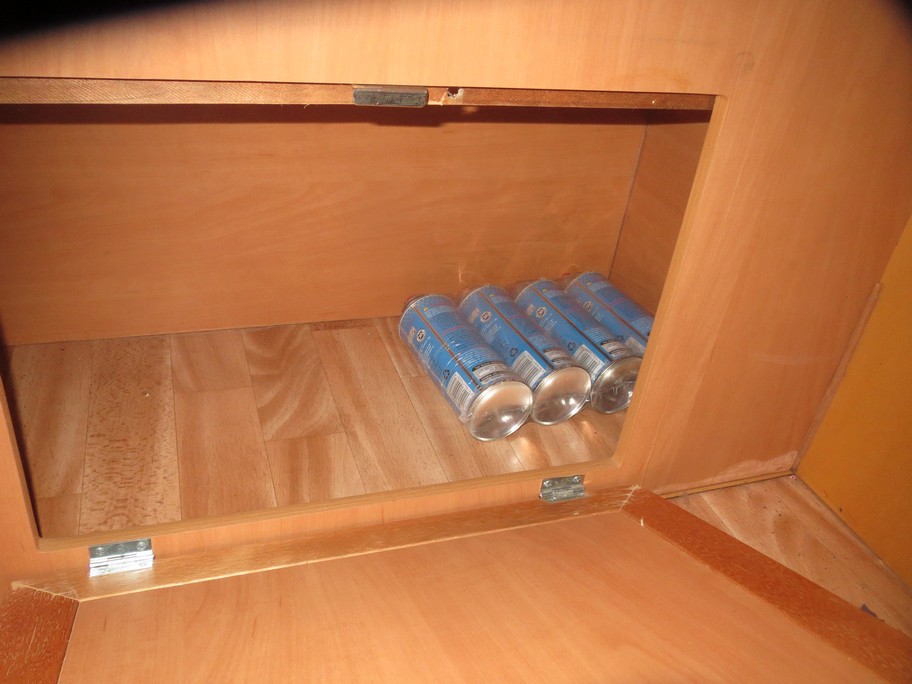

Just a hour or so ago I moved some new 220gm gas cans/cylinders from one cubby in the van to another spot. The cans were still in the shrink plastic which I thought protected them to some degree but how wrong I was.
When moving the cans I dropped 2 cans about 6" onto the floor of the cubby and then heard a hissing sound and that gas smell - grabbed the cans which were spraying out liquid gas and removed them from the van all the time thinking what ignition sources are there....fortunately none, but had the fridge been running on gas it would have been different. A strong SW was blowing and temperature was 9C - had it been summer with temperatures in the 30's the gas would have sprayed out with much more force.

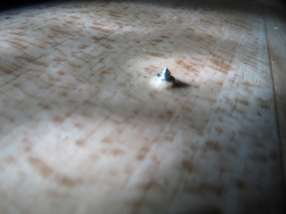

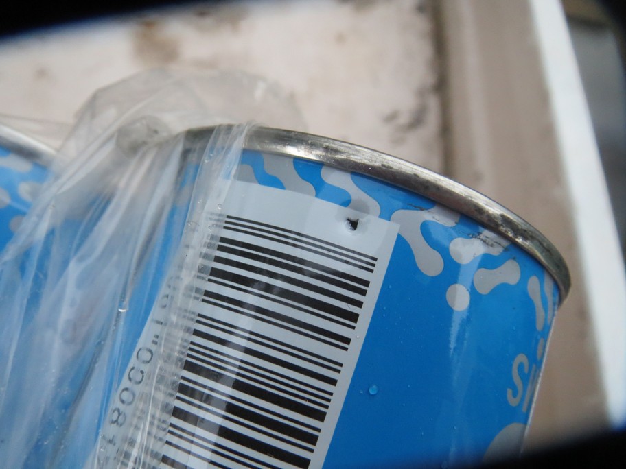

Cause of the puncture was the needle point of a self tapper sticking up through the floor. It must have been there for at least 2 years and 30,000km since it was screwed in. Third pic shows the screw to the left.
So that's how easy it is!
