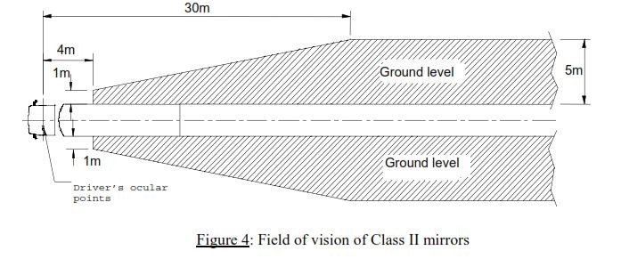

ADR-14 allows cameras to be substituted for mirrors. However the cameras must cover the same field of view as specified for mirrors. The following is from the ADR (and before someone comments that the vehicle shown is a LHD model, ADR-14 incorporates the European specification in the interest of minimum red tape for international trade.)

I don't think that that comes from any legal document. However it is a damn good diagram detailing the requirement for supplementary towing mirrors. If you are after legislative requirements I suggest you go to ADR-14- download it from here.
The diagram I posted above is just for the main mirror of a vehicle. Trucks are required to have convex mirrors that cover the side view closer than the main mirrors an have a wider field of view. They are also specified in the ADR. The standard door mirrors on our tug cover that requirement.
