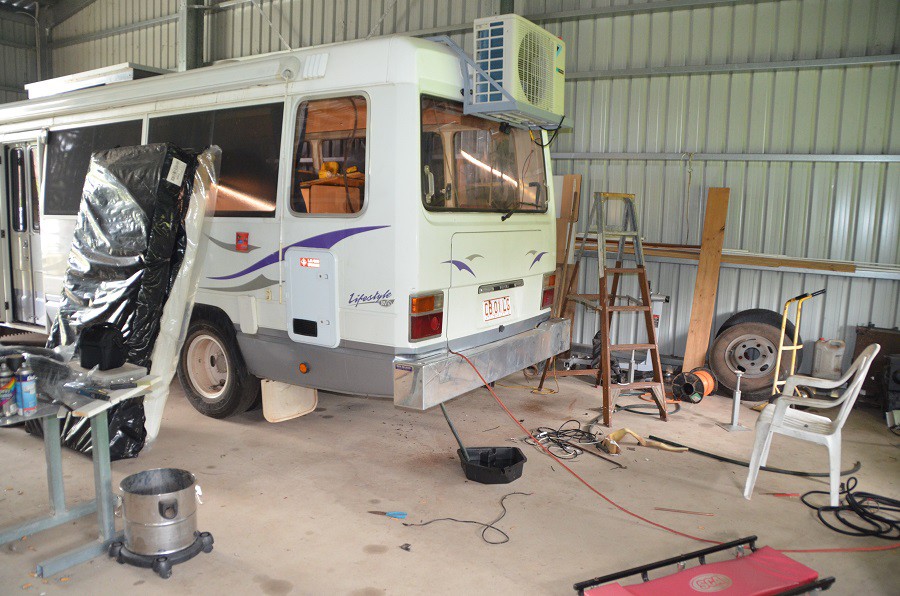

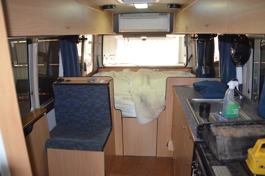

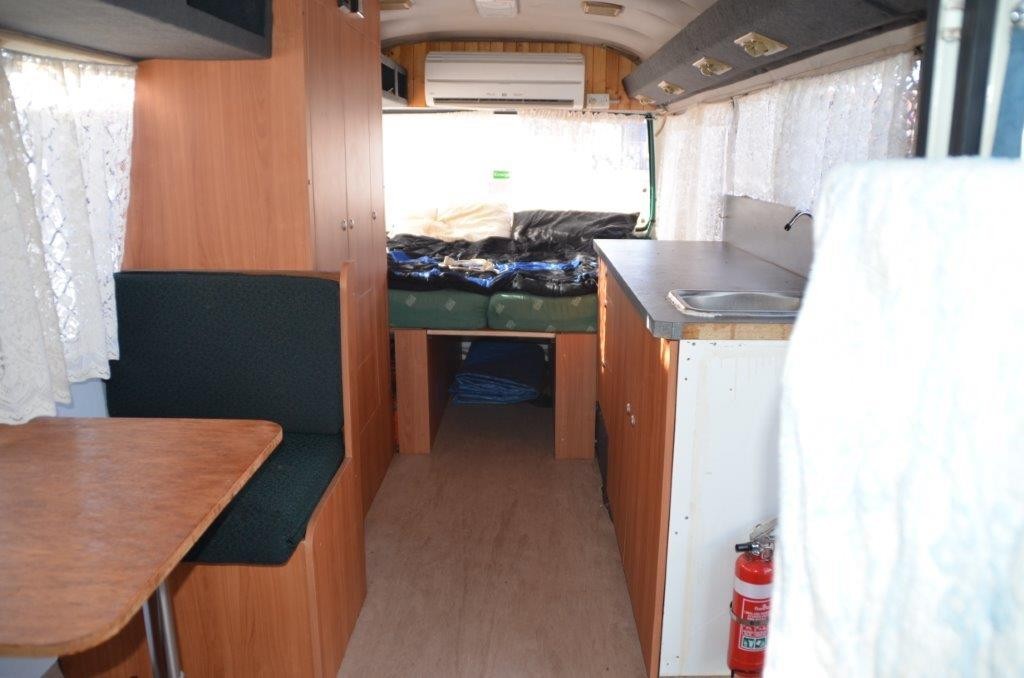

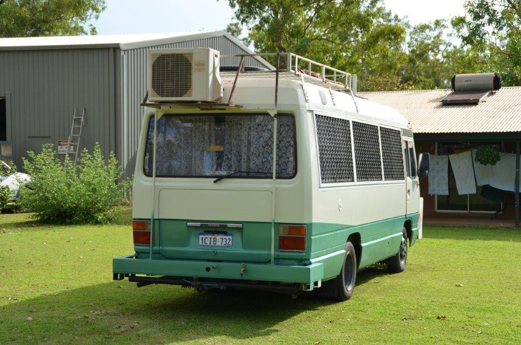

Fujitsu inverter on our old Coaster, Daikin inverter on our new one, pulled the roof Dometic out on our LWB & fitted a vent, best move we ever made. Daikin runs on just 510 watts in 40 degrees & can be run on our house batterys via the inverter.
Photos are of our old Coaster new one is located similar.
Found the new LWB photos
