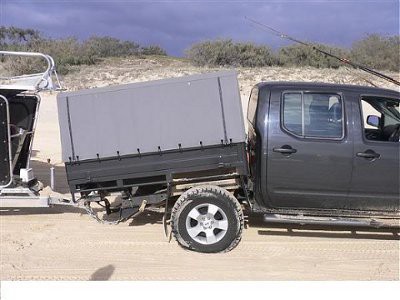

1300 kg in the back is a hell of a lot mate
Be carefull that you don't end up with something like this

I really don't like the scare tactics of people putting up those odd photos, I do wish they would loose them.

Bent , broken chassis is not just scare tactics , in my travels I have seen a few , mostly Dual Cabs ,
if your std suspension is not up to the job for the load you carry , its best to get it sorted by a Spring Works and avoid air bags .

those scare tactics of the odd photos are pictures of utes with broken back most are caused by the use of over inflated airbags that change the load point on the chasis

The Hilux I have just sold went over the weigh bridge @ 3300kg , way over its 2780 GVM , I had well sorted suspension and no Air Bags
it handled the load no problems . We do a lot of 4wding in the Vic Highcountry, Simpson a few times , Cape a couple of times , Gibb plus plenty of Out Back Dirtroads .
