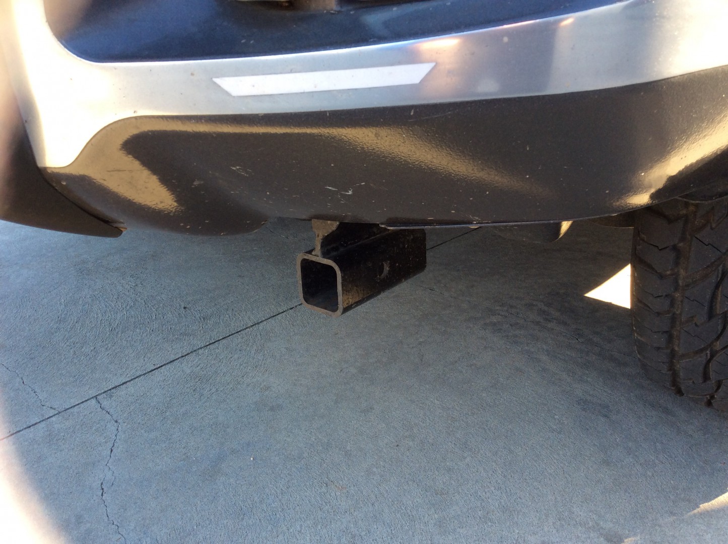

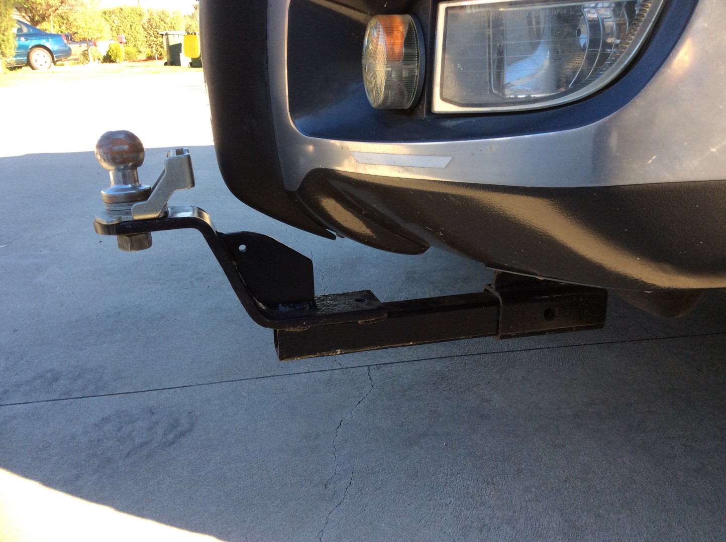

This is how I mounted mine which I copied off a patrol,mine is fitted to a 120 series Prado,I had a dog leg where it made it easer to put the van away.now I have shifted house I don't use it, I must say it made life easier ,when I did use it I had a pump up jockey wheel on the van to take some of the weight,and only used at home,and was always removed for travel.The patrol had one mounted on both sides,if they are offset you can look down the side of the van while pushing.
