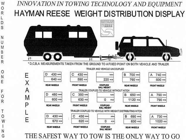

Weight Distribution Hitch (WDH.) - Toyota suggest you should use a WDH or load levelling device. This device will transfer the ball weight between the axles. If you don't use WDH then the weight on your rear axle will be about 1.5 times the ball weight you impose on the tug. As Cruisers are not great in the load carrying department you are liable to be overloading your rear axle if you carry much load when you have the van hitched. The diagram below explains the situation
