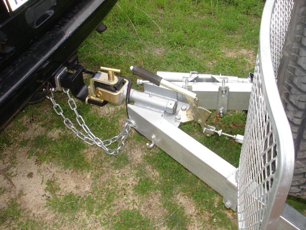

You seem to all be missing the point.. On mechanical override brakes, the brakes are operated by inertia whenthe trailer or van starts pushing the tow vehicle. There is a sprung loaded shaft that is compressed when the trailer or van starts pushing against the tow vehicle under brakes. When you reverse the trailer or van, you will also compress that shaft and force the brakes on, unless you flick the little lever over to prevent the shaft being able to slide back against the brake operating lever.
So.... unless the van has been fitted with a Tregg or Trig hitch, he shouldn't need to worry about there being an override barke style coupling. If Tregg or Trig has been fitted.. sometimes the manufacturer fits an override brake style swivelling hitch to save fitting a separate handbrake handle. It is not common, but a couple of weeks ago I was talking to a bloke who had that on his brand new camper trailer.
This is a Tregg with override brakes, and the lever pointed to by the arrow is the one Hey Jim has to flip over when he reverses his trailers. Without that lever you can see how the shaft would get pushed back agaqinst the brake lever and cause the brakes to be applied.
This is a Tregg with separate hand brake lever and no ovveride brakes.
Obviously, unless Hey Jim has an offroad van he is unlikely to have the Tregg hitch, and this isn't even an issue....... But.. it can happen.
On my camper trailer I fitted electric brakes and left the override brakes as well, so I had redundancy if the electric brakes ever failed and I didn't have to buy a handbrake mechanism.
Excuse my ignorance but how would that work.....which system has priority and even then if one fails how is the other system going to brake correctly?.
It would work very well . If you are using electric brakes, you just flip the reversing lock over so the ovrride brakes are inoperative. If your leccy brakes decide to cark it, you flip the lever back and you have override brakes.. It's not a question about priority, it's just a backup if the electric brakes fail. And thbere didn't seem much point in replacing the swivel hitch with a non override one and having to also buy a handbrake mechanism.
