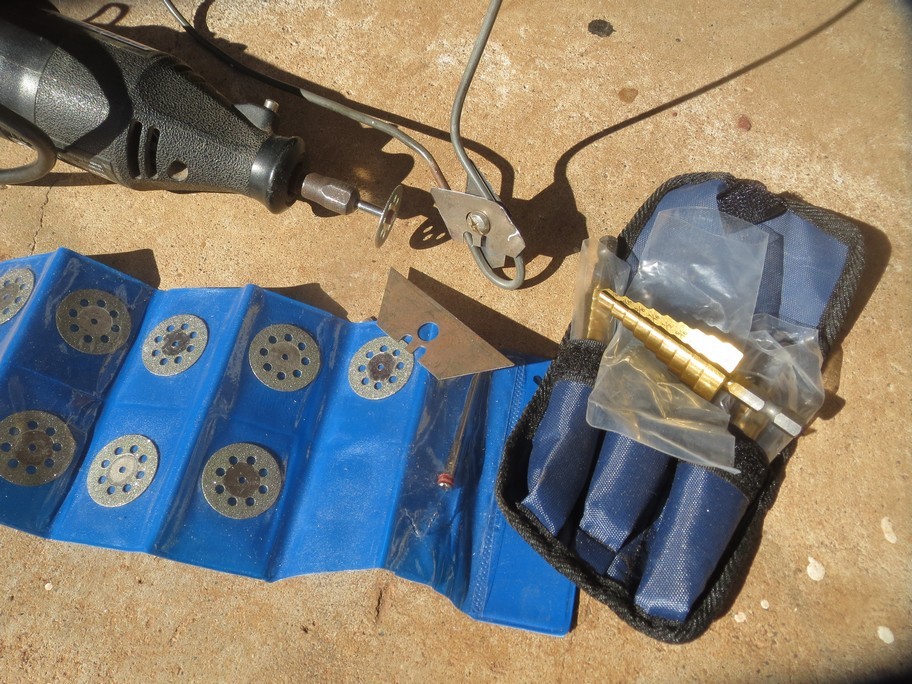

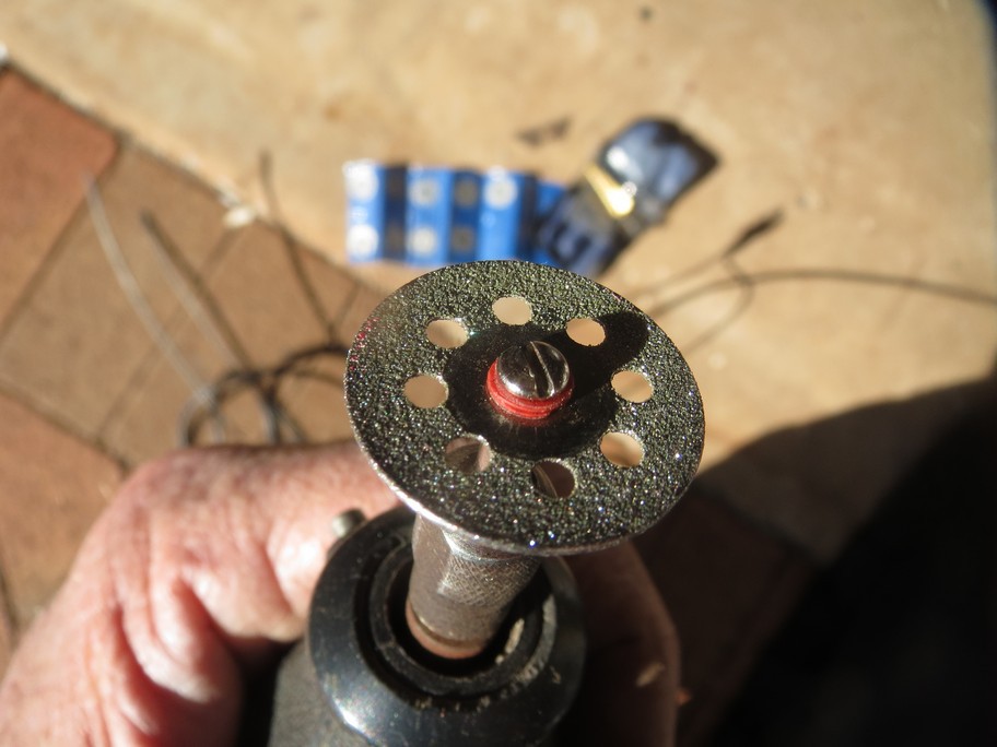

Here are a couple of very handy and versatile items - first the cutting discs which attach to a Dremel or similar tool - they will cut thru a Stanley box cutter blade or a padlock plus basically anything. At under $3.50 for 10 delivered they are very affordable! I'm still on the first blade and I've made 5 cuts thru a Stanley blade (for a avocado picker) and 1 thru a hacksaw blade (for fun) and it's still serviceable.
Second handy item is this 3 piece set of cone drills - handy for making any sort of hole that you normally drill into 'anything' larger....I used mine to enlarge a hole on the side of my van for the TV aerial wire where it was overkill but this sort of toy will have many uses. Again pretty cheap at $8.06 for the set of 3 delivered.
I've attached some pics of the items and what the disc can do....plus links.

Tried the larger stepped drill - the one that starts at 1/4" and finishes at 3/4" - used a piece of 2mm steel channel for the test. Initial 1/4" hole was a bit slow compared to a normal drill but once that hole was through the drill went from step to step as fast as I was prepared to push the drill right up to 3/4" with no wobble or jagging so I was very happy with that. Checked the cutting edges with an loupe and the all appeared sharp with no chipping or burring so they are made of decent steel. I note that Bunning sell a similar drill to this one at $48...that's for 1 drill, not 3 and it's also made in China. Profit must be good if you can buy from Ebay for $2.70 each yet at the hardware shop they cost 18 times as much! Didn't both on body metal as if they go thru 2mm steel, thinner metal will a cinch.
Re the discs - tried one on a 1/4" HSS drill and it cut thru the shank in about 45 seconds. After that there was still carbide (or whatever is the cutting medium is) on the disc surface and this is still the original disc (9 left).
