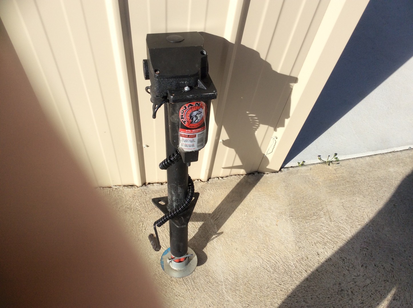

Olley46 said
02:09 PM May 13, 2015
This is what I use ,I have a trail mate lifting bracket which attaches to my electric jokey wheel then it is used as a jack and a jockey wheel if need be you can fit a wheel where the detachable foot is, it is capable of lifting 1350KG cost of the electric jockey stand less than $200.00 nearly half the price of a trail mate, and they are available in a heavier lifting capacity.Handy for artheritis sufferer.

Just a few questions about the 12 volt Jack - can it be clamped in with the normal Jockey Wheel Type clamps or does it have a larger diameter.
If so what type of clamp and/or brackets if any are supplied and are they capable of being clamped securely to the Drawbar without too much fabrication.
Cheers Kev.
Olley46 said
10:33 PM May 13, 2015
KevKim37 wrote:
Hi Lance,
Cheers Kev.
Hi Kev
It fits in a normal jockey wheel clamp ,no supplied brackets,I use it as a jockey wheel , got the old artheritis it helps heaps. I bought the electric jack from Repco.

gandk said
02:44 PM May 17, 2015
Thanks for that also to the others re trail a mate. I actually did contact Goldstream head office and they said they now use Ko jack jacks but the load capacity is not as good as Trail a mate.
Thanks again. Will get my husband to have a look at your photo.
