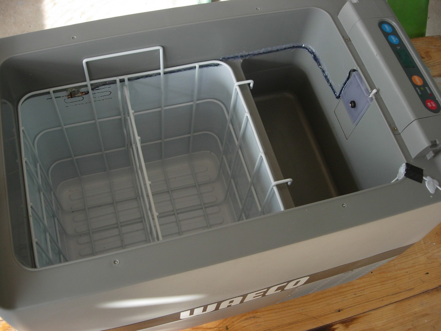

are you sure the small section is not a dairy section which is in a lot of 12v fridge/freezers, because that section wont freeze

Looking at a picture of one, they are no different to most other portable fridge freezer. The small part is never intended to be used as a freezer. Waeco units look the same layout. To me the Bit Deals one is quite a reasonable buy.

just what I thought it is a dairy section it is not meant to freeze

Agree with all the replies as my Waeco copy is the same - small section is not cooled by coils. This is not a problem as that's what you use for dairy products.

Thanks for all your comments, I don't feel too bad about my buy now, there is no information in the user manual about the small section not being a freezer it makes sense now, this all started when the supplier Bit-Deals informed me that ALL the sections should be at the same temperature, it would of been good if they knew what they were selling!!! Thanks again.
