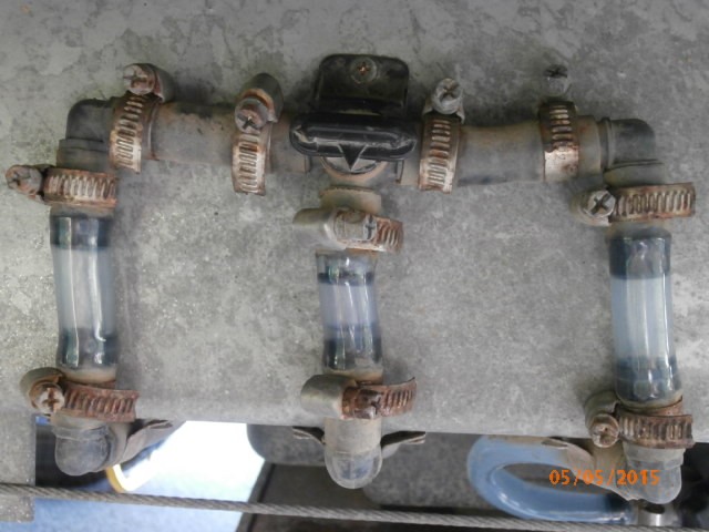

We have recently acquired a 2011 Jayco Starcraft with two 90 ltr water tanks. It has 3 clear plastic sight tubes. Two would be for the amount of water in the separate tanks but what is the third (middle one) indicating? Also the four position, 3 way plastic switch under the side of the van, does it have any effect when filling the tanks? It appears not to, irrespective of it's position I cannot fill just one tank of choice. I think that the switch may only control from where water is being used, could that be possible? It is not that obvious to me either where to set it to, to use one tank before the other. Cheers Steve.
One goes to the pump (centre one I think)...the other 2 from either tank. The arrow points to whichever tank you are drawing out of. Common sense would say that rear hose is rear tank etc etc.....but on my van ...it is actually arse about ...go figure LOL.
HTH.
Cheers Keith

Hi
As Keith says above - the left and right hoses are from the tank and the middle is the one which goes to your pump! It has nothing to do with the water in. Turn the black arrow to the tank you want to draw water from.
I got sick of crawling under the van, so changed the location so that the plastic selector was located inside the van - just before the pump.
rodden said
05:11 PM May 5, 2015
hi Steve ,
the pointer at 12 o'clock = both tanks off , pointer at 3 o'clock = front tank , pointer at 6 o ,clock = both tanks on, (water being drawn from both tanks at once ) pointer at 9 o'clock = rear tank. when trying to fill one tank only do not have both tanks turned on as you will find that one tank will slowly decanter into the other, also do not travel with both tanks turned on as if one should be damaged and lose all its water the other tank will also lose all its water, not good
so far Iv,e lost three tanks to stone damage over the years. and they all had good stone protection fitted
good luck travel safe
gtsteve said
05:44 PM May 5, 2015
Thanks Guys, yep I can see it all now, and a good tip about loosing both tanks of water.
Cheers Steve.
09:50 PM May 5, 2015
When the pointer is pointing down, both tanks are interconnected. When you fill one tank it will run through to the other. If you only wish to fill and use one tank then turn the pointer to that tank. When you fill that tank then water will not run through to the other one.
