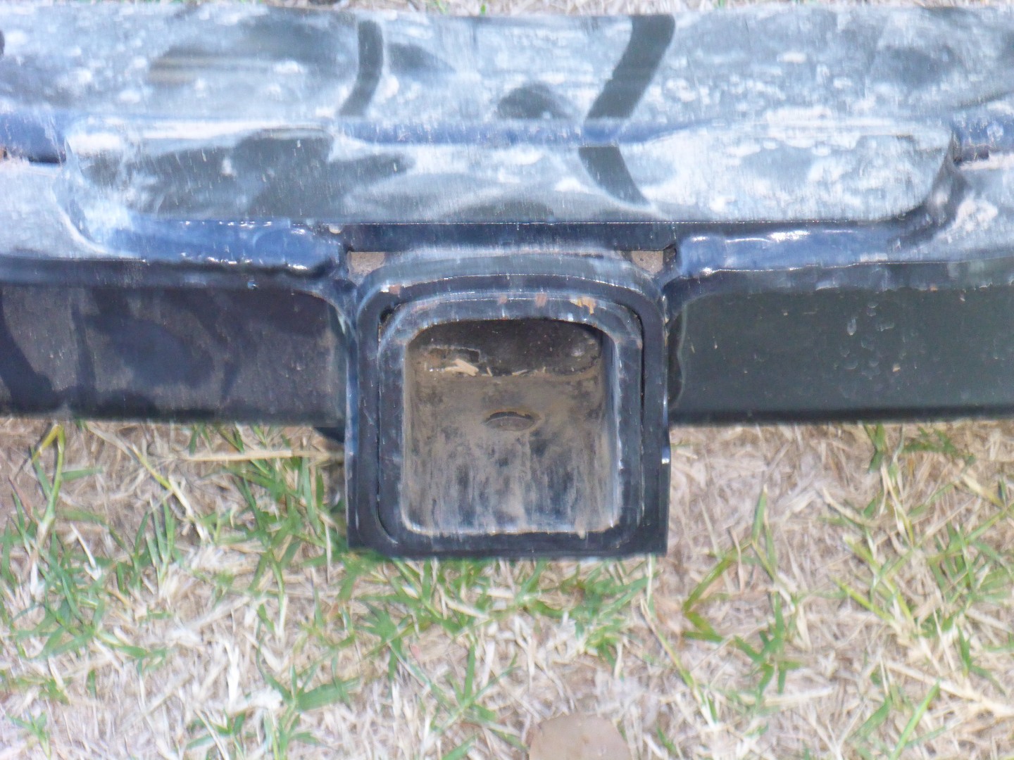

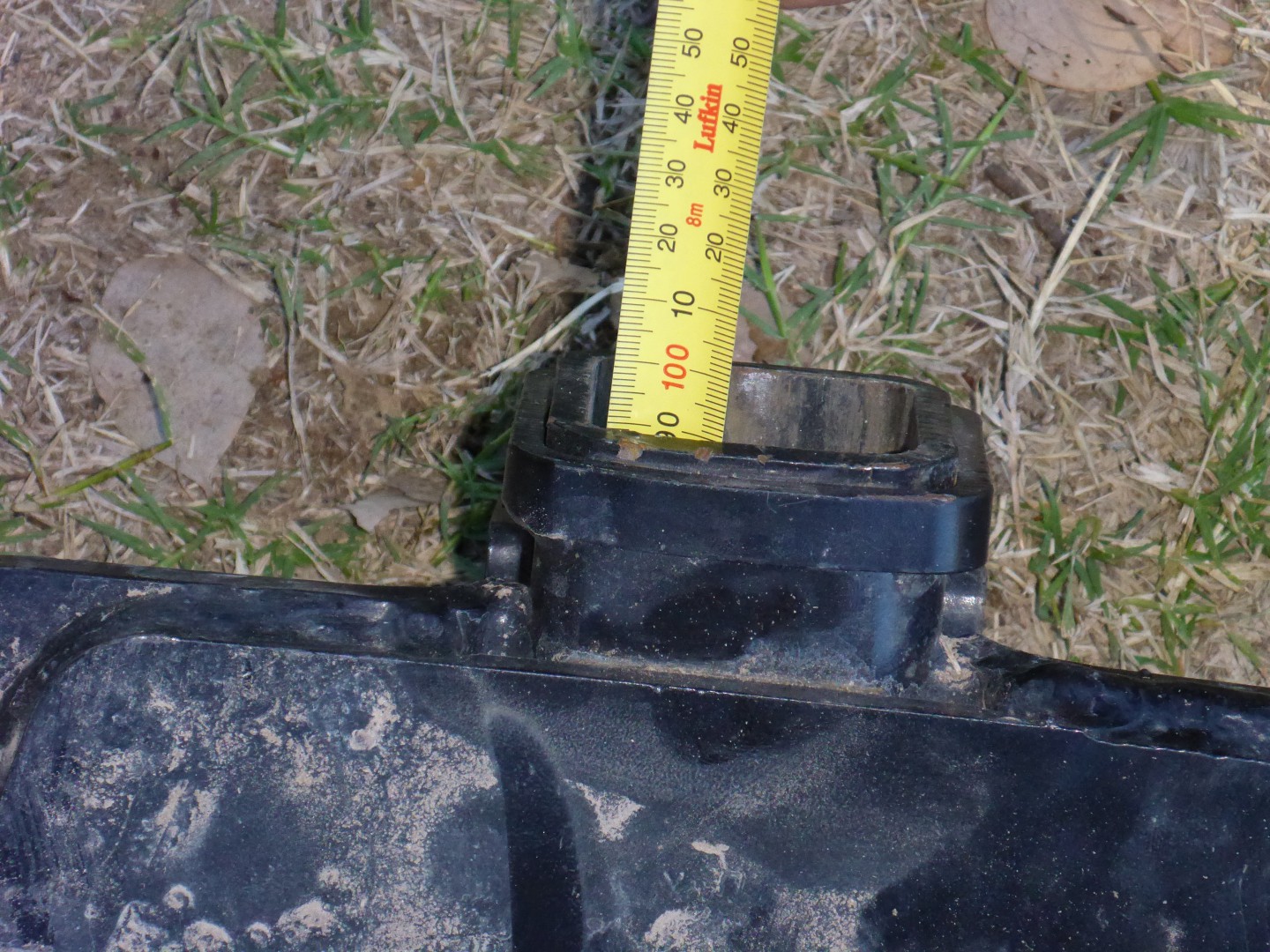

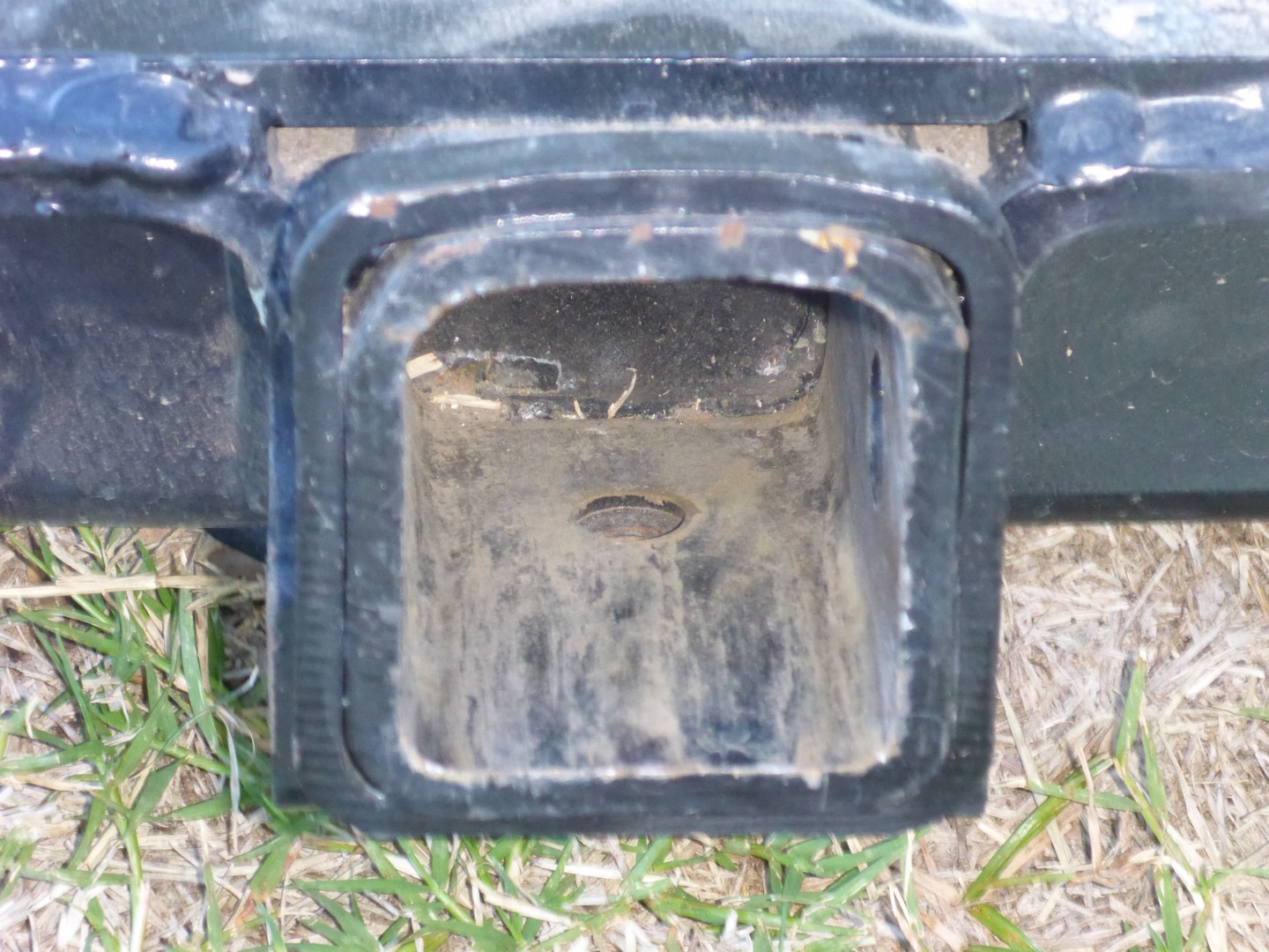

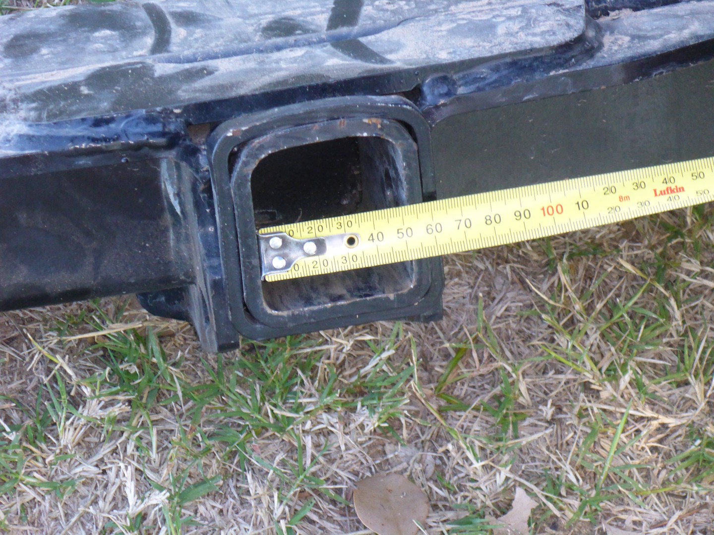

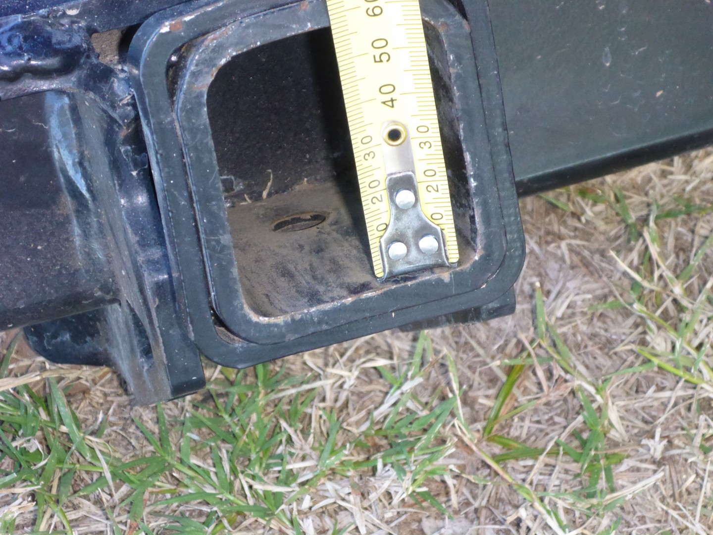

10:28 PM Jun 1, 2015
Hi
sorry for the delay but here are some photo's to show what is wrong with the tow bars. Ford have not wanted to know us, we were left stranded for 2 weeks waiting for a re-placement (not a ford 1). with no help from Ford at all.
IMHO the 90mm depth of the receiver may be an issue. As a comparison ours is about 180mm deep (not bragging just an observation all) and about the same thickness of material.
May be imported steel in towbar. I know when I'm welding imported steel, as it welds erratically and can have large pools of impurities and splatters at times.
Hope the problem is fixed with new one.
Cheers Baz
Cheers Baz
