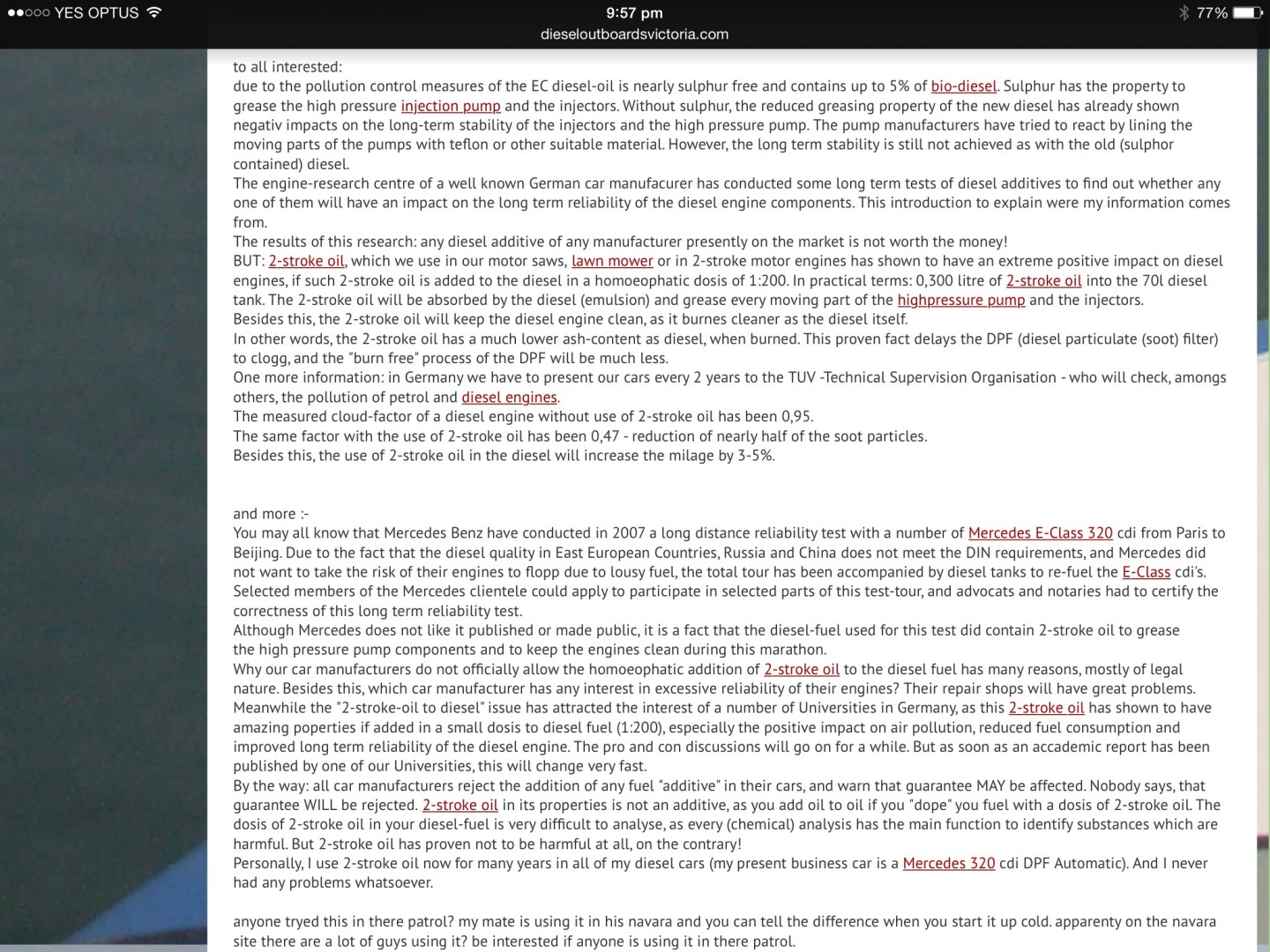

The addition of 2-stroke oil to modern diesel motors has been "debated" for some years.
Without comment or prejudice, I provide the following for information/consideration -
The use of 2 stoke oil in diesel has been around for many years and there seems to be no positive proof that it is of any use. For piles of info on its use just Google 2 stroke in diesel.

As well as the above info (it's been done to death) the local fuel suppliers are adamant there is enough of the correct additives in diesel to lube the pump on current diesel engines. However a small amount of the correct 2 stroke in the tank won't do any harm (it's designed to burn) and will add a small amount of extra lubrication for the pump. Having said that the Izusu engine in my Colorado has a design life of between 500,000 and 800,000Km before major rebuilding is required.

I use two stroke in the Landcruiser. Started of using Flaslube and realised that two stroke oil did the same thing albeit at a cheaper price. Only use mineral oil. Synthetic oil is OK but more difficult to keep mixed. The engine sound much quieter and there is a slight improvement on fuel consumption (1l/100km). The ratio is between 1:100 and 1:300. Recommend it to all that have a tug with diesel engine.
Spoke to a few truckies and they tell stories of using old sump oil in their fuel. Obviously old technology diesel engines.

If you are interested, there is a long thread on the Landcruiser forum (LCOOL.ORG) regarding two stroke oil added to fuel. Would not put sump oil in a modern engine. I know of someone who put used transmission fluid in an old Landcruiser. I think it is mechanical injection.

Let's just call me naive ... but let me put the following for consideration.
Due to tightening of EU (and ultimately other countries) pollution control requirements, fuel companies needed to make their diesel fuel 'cleaner' - so they developed ultra-low-sulfur diesel (ULSD).
Keeping the scenario as brief as possible ... this reduced the 'lubricity' of the diesel fuel. The fuel companies therefore used 'additives' to overcome this.
One would think that the fuel companies would be extremely fearful of legal action if diesel engines were adversely affected (or damaged) by the use of this fuel.
Given the litigious nature of our world these days, it would not have taken very long for actions to be initiated against fuel companies - resulting in horrendously huge settlements - IF such damage began occurring.
There have been no such litigations - successful or otherwise.
So, if the fuel companies are confident with the fuel they supply to the public for use in diesel engines, surely there is very limited value in adding 2-stroke oil in addition to the other proven additives inserted by the producers.
I am not a techo, engineer or physicist - just postulating my thoughts.

Some serious tests of fuel additives have shown that a dash of BioDiesel is the best for minimizing the wear that comes with low sulfur fuel. Much better than 2 Stroke. Anyone driving a diesel in NSW is already adding a dose of BioDiesel to their tank.
