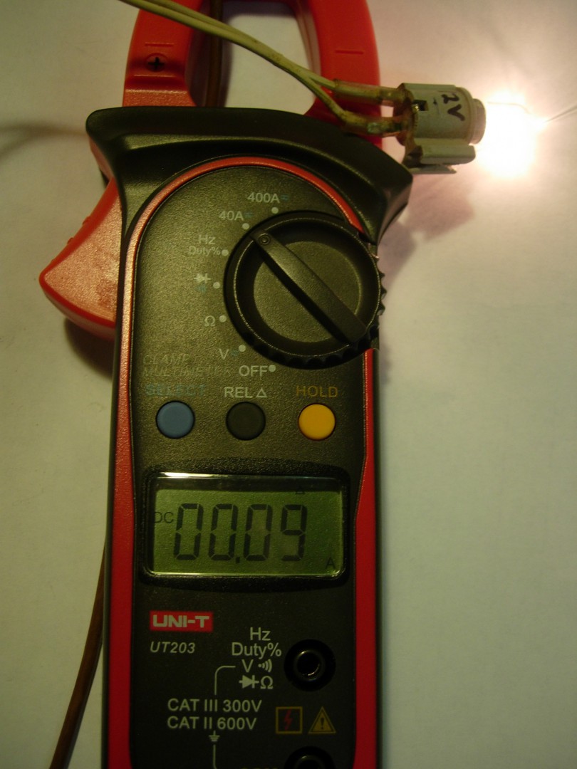

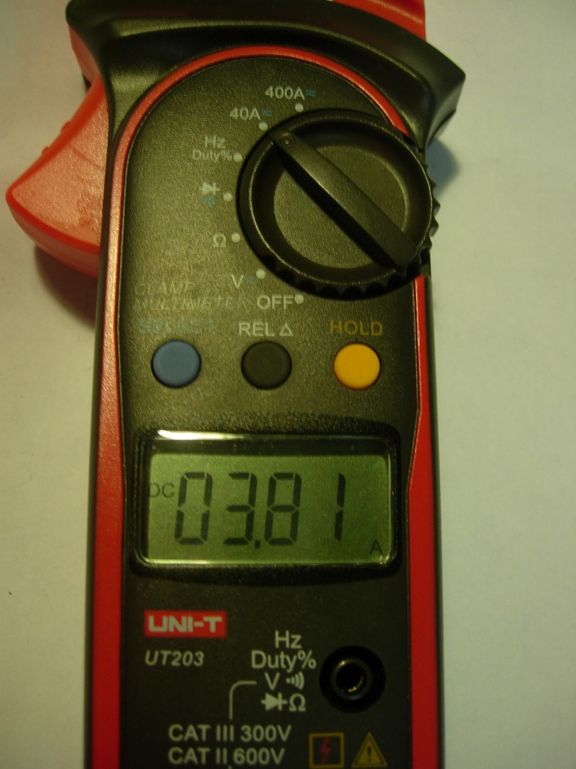

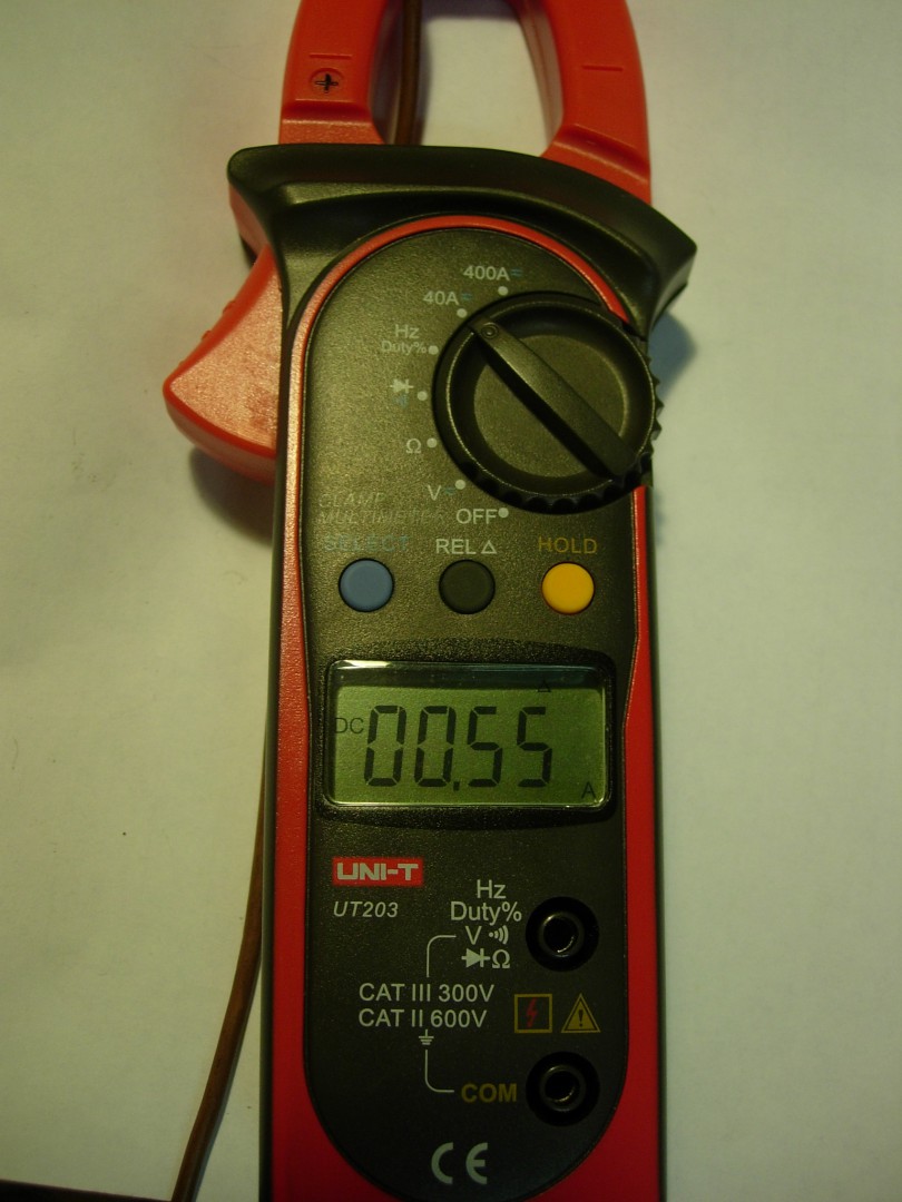

I wouldn't be too put off using an AC/DC clamp meter with 40A/400A. I use this a lot & on 40A scale is quite reasonable for small currents. These were measuring currents on 12Vdc.
The meter in my pictures is an AC/DC clamp meter & in the pics its measuring 12V DC current.
