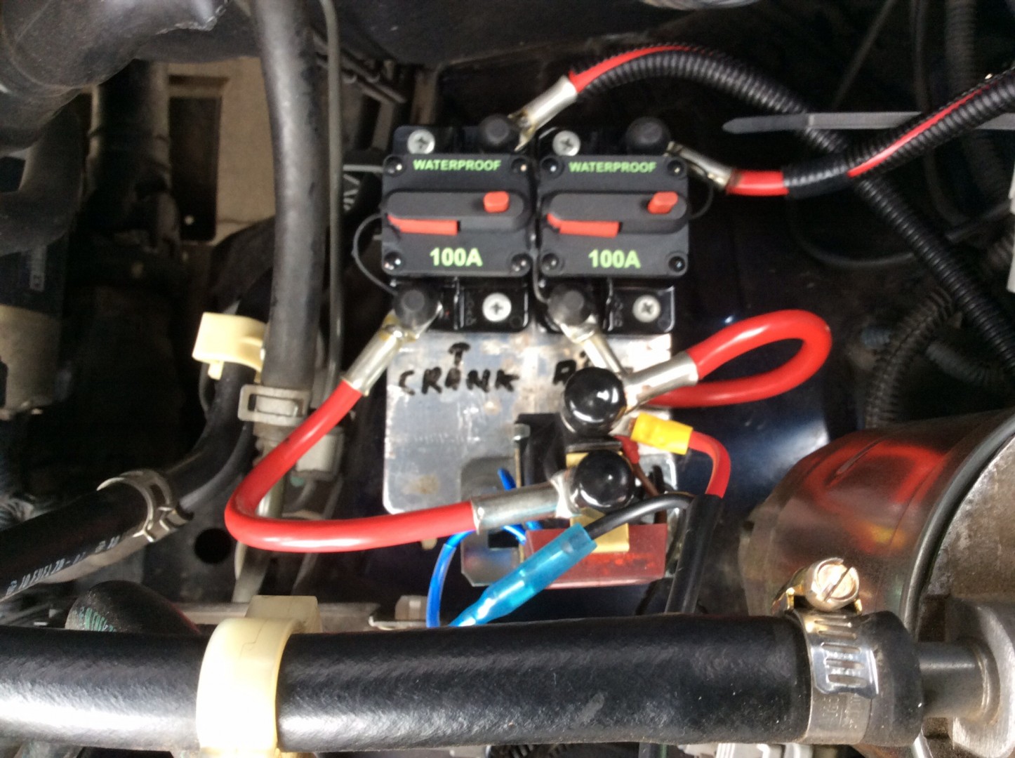

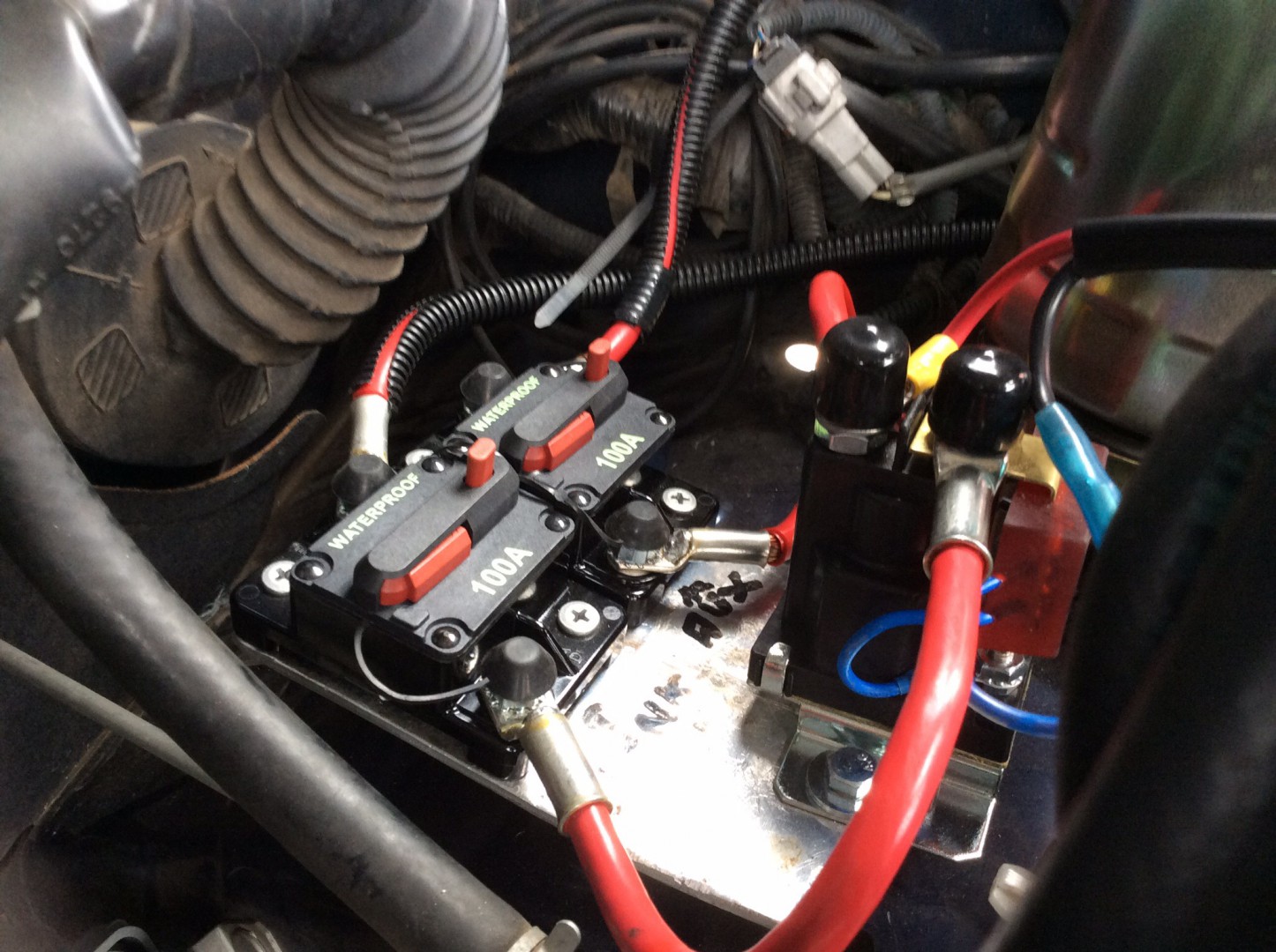

I bought this one on E Bay $109.00 for the switch $52.90 for two 100AMP circuit breaker,s about $218.00 with a bit of wire and some terminals,I had the Battery and Battery cable.

Olley46 the circuit breaker for the rear battery should be as close to it as possible not up in the engine bay. It's job is to protect the cabling between the two batteries and the rear battery in the event of a short developing.

The second battery is not in the rear, it is not far from the circuit breaker, had to fit circuit breaker where there was room.
Alan
Lance C
All good Olley46
Alan
