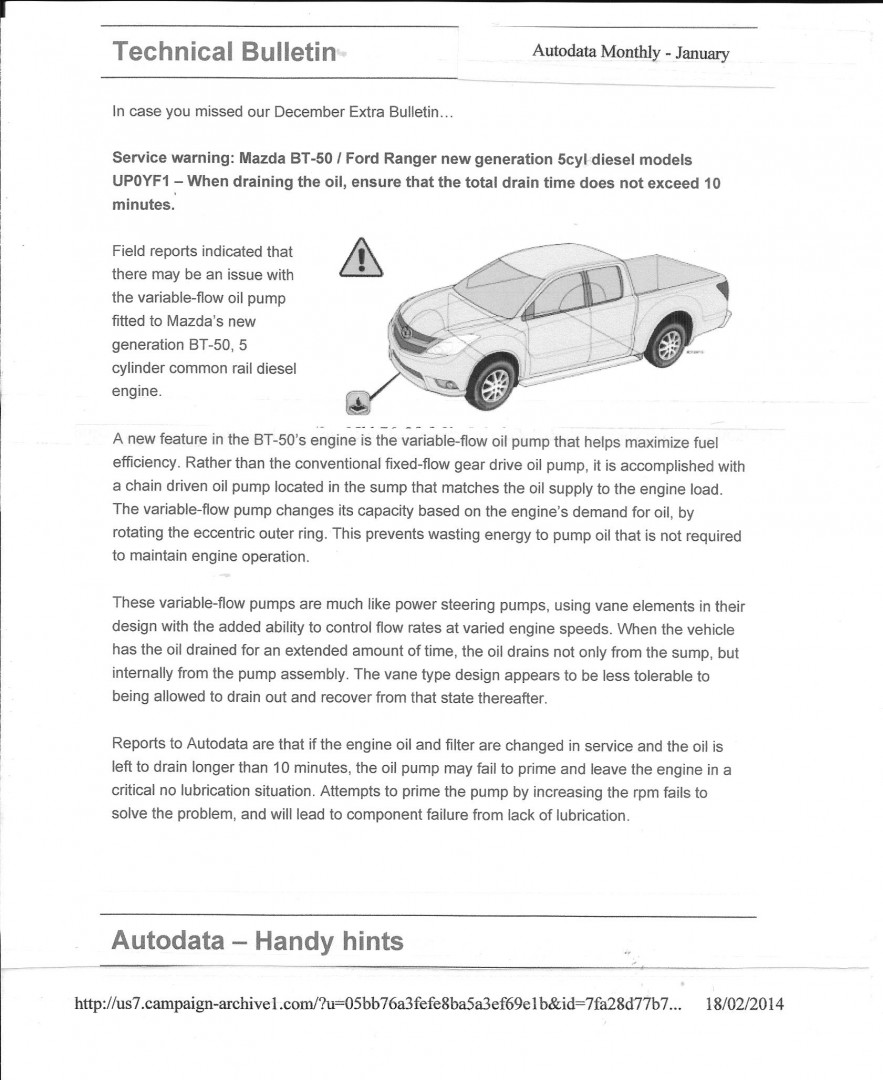

jade46 said
12:21 PM Apr 25, 2015
DeBe wrote:
You could save a lot of money by changing just the oil & filter yourself, if out of warranty. Bearing in mind if its the 5cyl diesel don't take too long to do the filter & oil change. As it wont pick the oil up on starting. The cure for that is remove the oil pressure switch & pressure feed oil in to the oil gallery.
Could you "please explain" If I take half hour to pour new oil in the engine won't pick it up ? Is that what your saying?
Read this & it does happen.
