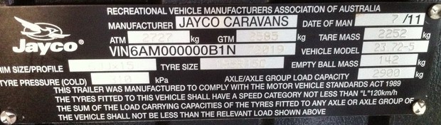

My VCV compliance plate reads 180kg "Ball At Tare". Check and see if yours is "tare". I have 250kg on the ball. Tow bar can have 350kg on ball.

Plendo's advice is correct. The ball weight stamped on the compliance plate is arrived at by a simple calculation by the manufacturer - simply the difference between the manufacturer's stated ATM and GTM - and has no actual relation to the tow ball weight of a fully loaded van.
Unfortunately, many (most?) van manufacturers rarely actually weigh EACH of their vans at TARE to arrive at these figures. They weigh the first one off the line and then apply those weights to all vans of the 'model' they build thereafter.
The actual ball weight (determined by weight/s of loaded van over a weighbridge - or tow ball weight scale) should not exceed the vehicle manufacturer's maximum tow ball weight for that vehicle AND/OR the maximum weight allowed for the towbar/hitch attached to that vehicle.
Rule of thumb is that tow ball weight be 10-15% of ATM.

My understanding is as John has stated, and as indicated buy Paul, the tow ball weight stamped on the compliance plate is what the builder expects the tow ball weight of the empty van to be, the key word here being expects.
Now you indicated that your loaded situation puts your ball weight at around 300kg, with a tow vehicle max to 350kg, I would have left it at that.

Ours says empty towball weight.
