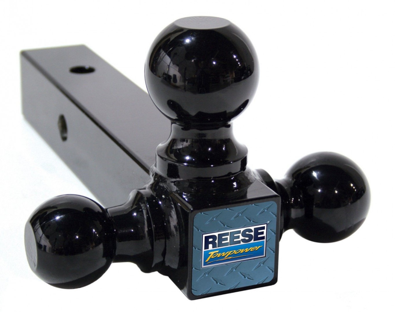

You would have to get one of these
and they're welded on..
