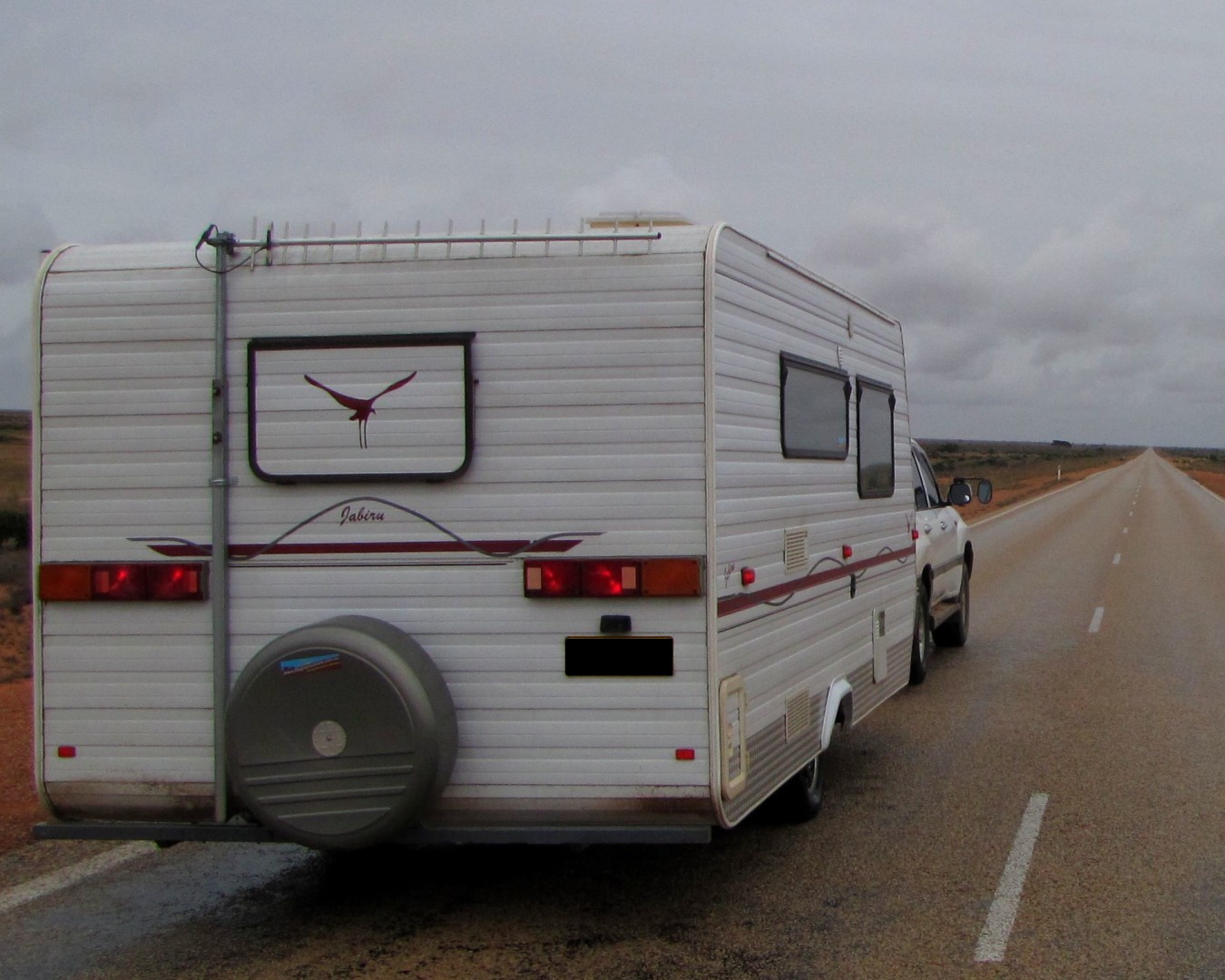

We had an outside antenna fitted to our van and had internet in many places others didn't.(see photo. We just loosened the bolts (could use wing nuts) and raised it then pointed it
Before we moved to our next port of call we checked what direction the nearest Telstra aerial would be from that spot then, when we got to our destination, we raised the antenna and pointed it in that right direction then...voila!

If you mean on my van I wouldn't have a clue sorry and the caravan isn't here at the moment to take a look.
I just found a reputable antenna guy, told him what I was after, he scratched his head and looked at the back of my van for a while then turned to me and said 'this is what I can do'. After that I said 'buedy mate! go for it. and you see the result.
Cheers.
I think this is the latest Mobile Telstra aerial location finder site: https://www.telstra.com.au/mobile-phones/coverage-networks/our-coverage
Hope this helps.
Jon
Cheers.
Jon
