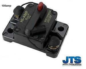

03_Troopy said
02:31 PM Apr 9, 2015
I fitted a couple of these to mine.
This mob have them for $34.00 free postage. I didn't get mine from here though, got them through work at the time.
100A Circuit Breaker.
