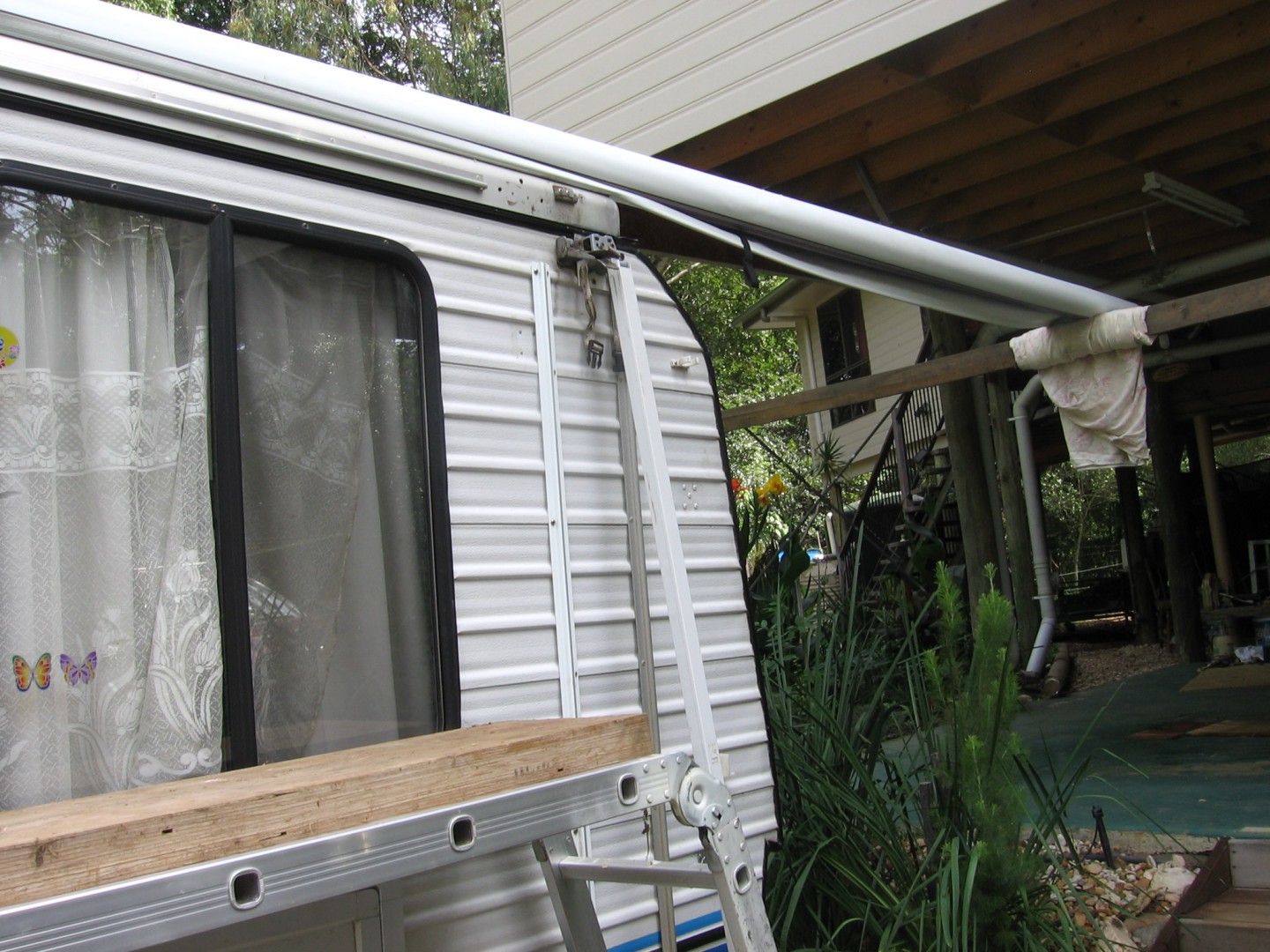

Well, my neighbour is away. The closest mates are a couple of hours away and my partner is an incomplete paraplegic. Sooo, I did it on my own today. Spent more time looking, thinking, ensuring it wouldn't fall on me. All up, about an hour or so going real easy. Roped one end to the van roof once threaded. Dismantled the other end brackets, bolted both ends and reassembled the bracket. Easy peasy.
