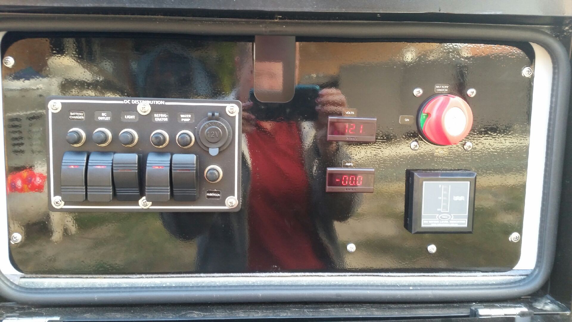

Hi. This is my first time posting. We have just bought a brand new MDC Voyager RF V5 (Melbourne) and getting ready to go away. Plugged into mains power and put the fridge on. Found after a couple of days the fridge was off as the battery ran down. Unplugged fridge overnight and left battery charging, turned on the this morning to find 5 minutes later still no power in battery. All the appropriate switches are on (pic attached). Clearly the battery is not charging. Is there a trick to this? Would appreciate some assistance as we are going away Tuesday and completely new at this!!
OK, let's go to basic, have you checked the circuit breakers? Thsee will be in a cupboard or box near the mains inlet. If these are on (switched up) then check the cable and power point you have it pluged into. Being a new camper I would guess these are off, has the inlet receptical got a very large earth pin?

I'm clutch at straws here, but do you know where the charger is located? And if it is switched on from there? Also check it the connections are tight and if the fuse is ok.
Also the pic doesn't really show the labels that clear and I don't think your reflection was smiling, be happy I'm sure others will jump on this with some suggestions too.

looking at your "panel" are the buttons above the switches circuit breakers? have you pressed them in to be sure they are reset?

mellykelly said
10:49 AM Apr 5, 2015
Im not smiling cos this thing is DOING MY HEAD IN!! Will check to see if there's an on switch at the charger - yes we're idiots for not looking but we don't know what we don't know!!

I don't know if they're circuit breakers. All I know is you switch them on, they light up... From left to right is Batter charger - on, DC outlet - on, Light - off, Refrigerator - on, Water Pump - off. The red knob has a pic of a batter and says 'house', which is on.

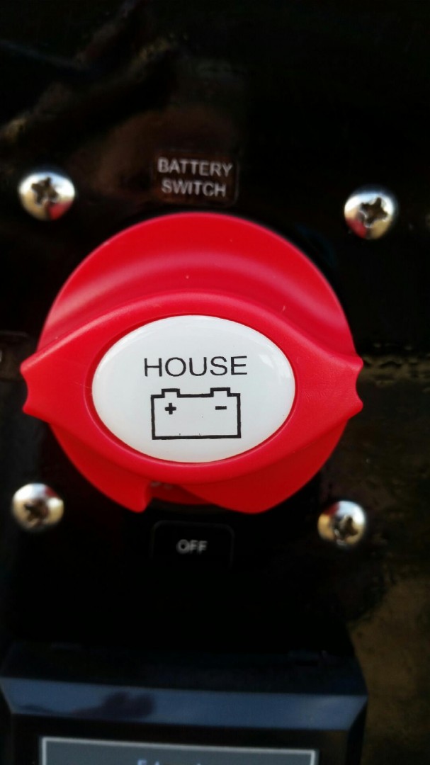

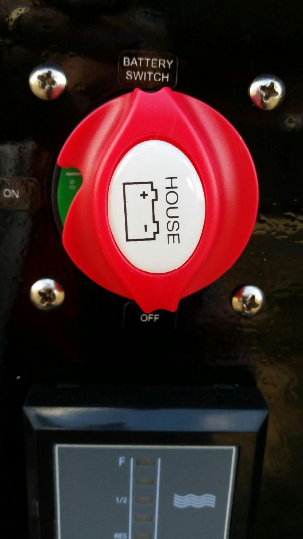

mellykelly said
11:15 AM Apr 5, 2015
Okay more pics - one of the battery switch in on and one in off - they are the only positions. I turned it off at the power point then turned it back on. The battery charger switch was not lit when I turned it back on so pressed the button above it and then it came on. The fridge worked for a couple of minutes but went back to showing not enough power in battery (flashing orange). I am totally clueless with this A manual would have been a fine thing:(
Ok, sounds like the charger isn't doing the right thing, may be a fuse or not plugged in properly or not switched on. Locate the charger, check the fuse, check it's plugged in and switched on. After that I would ring the dealer and get some answers.
Also check the battery box, some of these have integrated chargers etc in the actual box, maybe a fuse or switch in there.
Just had a thought, may be the battery terminals need tightening.

mellykelly said
11:24 AM Apr 5, 2015
Okay thanks Phil. Should the battery button be switched on?
Yes

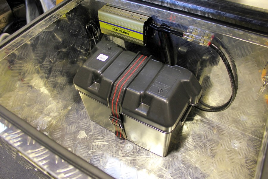

mellykelly said
11:38 AM Apr 5, 2015
Well there's this big black thing next to the battery, so I'm assuming so (although one should never assume).

Phil C said
11:42 AM Apr 5, 2015
Melly, sorry to give you the run around, but if you can post a few pics of the box and take a look behind where the power comes into the camper may give me a clue or two.

Phil C said
12:19 PM Apr 5, 2015
Im not getting much from the website, OK by the look of your last pic it looks like all the gear is in the front tool box. I would suggest disconnecting the charger (the silver box on top) and plugging it into the extension lead, thus avoiding anything on board the camper.
That way at least your battery will get a charge and 12 volt electrics on board will start to work. This will also test the charger to make sure it is working correctly. You may have to do this during your holiday as well until hubby finds the problem or it goes back to the dealer to get fixed.
Please try this and let me know what the outcome is.
