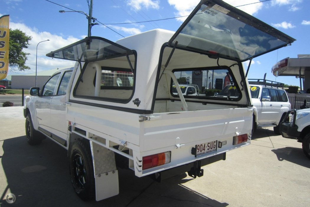

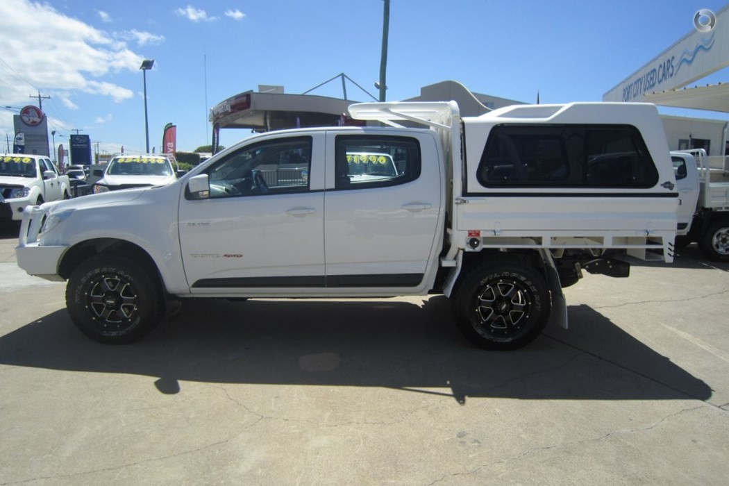

we are picking up a 102/13 duel cab with tray back next week and was told to upgraded heavy duty load leveling tow pack on it
we plan to tow 3 ton loaded caravan with it. and do a lot of traveling anyone having problems out there with theirs
