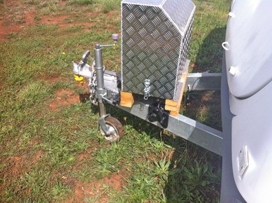

I am considering redoing my genset box on the A frame BUT it is difficult to keep the WDH chains vertical. I thought (now that's a worry) I read somewhere that there are different lengths of the WDH bars. I cannot seem to find that info now. Tried the HR website.

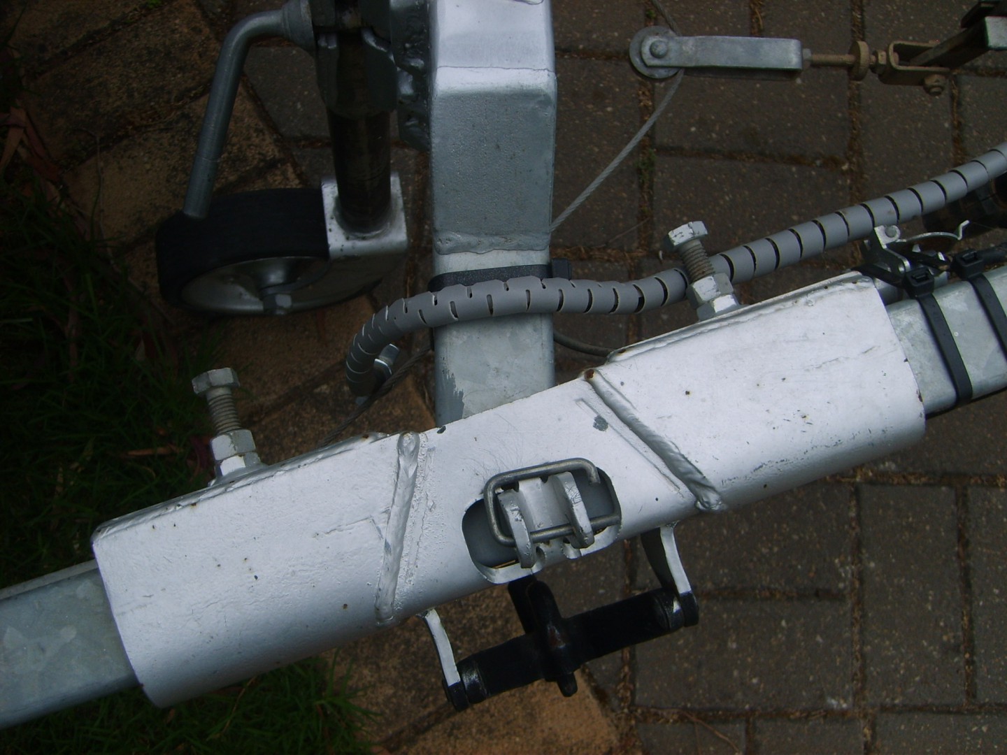

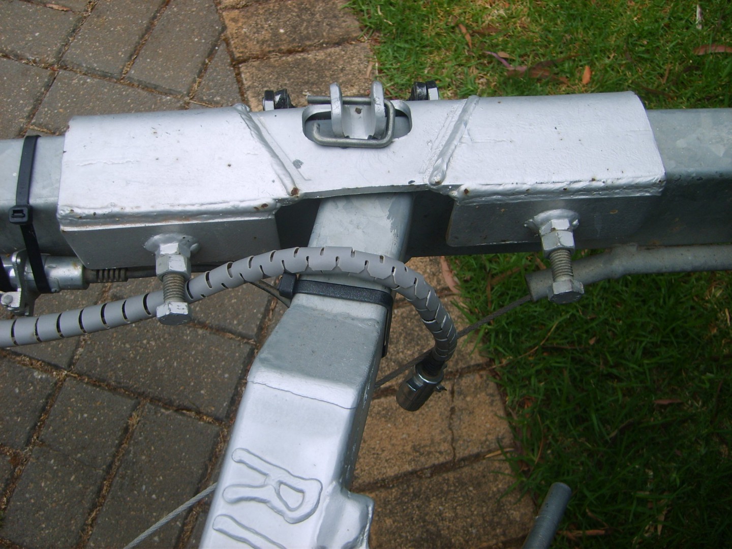

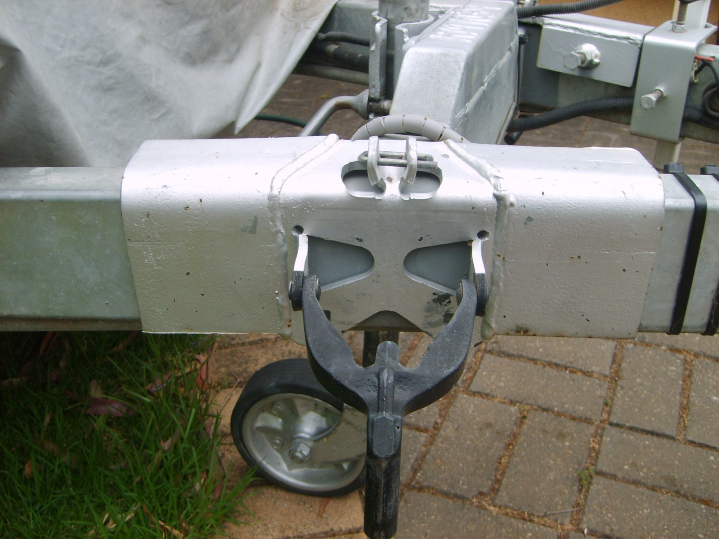

Baz421 said
08:07 PM Apr 3, 2015
Paul
I had a cross member preventing my Reece (US version of Hayman Reece) from ideal location.
See pics on how to make plates to overcome this type of problem as you tailor make them to suit .
They bolt on and utilise the original/existing Reece fitting.
Cheers Baz
-- Edited by Baz421 on Friday 3rd of April 2015 08:09:17 PM
Paul you can use your existing bars just put the block on the a frame to suit the position of the bars, probly a 15 minute job for a good welder.

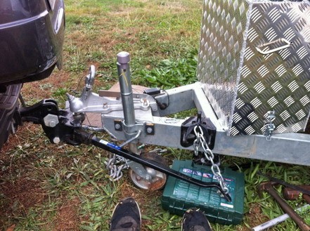

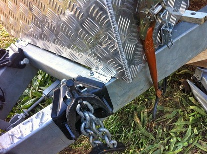

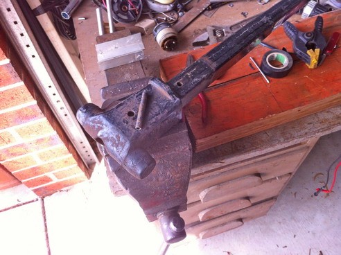

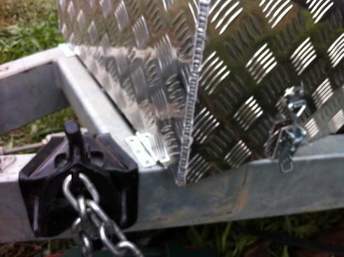

aussie_paul said
02:18 PM Apr 6, 2015
I reckon that I will be able to shorten the bars as they are only held in position by a roll pin. Also I could redrill and shift the U bolt with the chains forward a little. I am also trying to get a price on those devices in the catalog PeterD.
I have come up with an idea to hinge the genset box so I can lean it forward to open the front boot. If this works I will then get sturdier hinges and pop rivet them with stainless pop rivets.
Thoughts please??
-- Edited by aussie_paul on Monday 6th of April 2015 02:18:55 PM
-- Edited by aussie_paul on Monday 6th of April 2015 02:23:35 PM

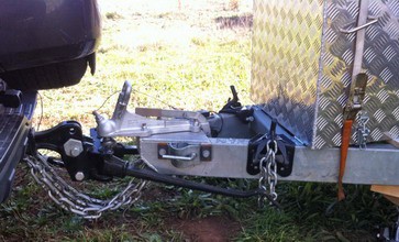

aussie_paul said
01:52 PM Apr 7, 2015
Ok, no takers re me doing something incorrect (I am never wrong!!) re my HR wdh bars so I will have a crack at cutting a few inches off the thick end of the bars and see how I go.

aussie_paul said
07:42 PM Apr 8, 2015
Thanks KevinC, too late she cried!!! The thick end is where I have shortened them. Bloody tough bit of gear to cut and drill. HR have both 30" and 28", mine were 28". Personally I don't see any problems, but time will tell.
KevinC said
09:17 AM Apr 9, 2015
I'm glad you did that end. Obviously it's where there's least flexing, so if you're going to get away with it, and I certainly hope you do, you've given yourself the best chance.

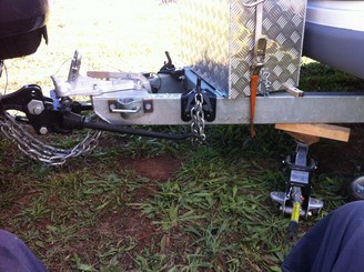

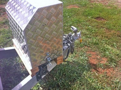

aussie_paul said
02:18 PM Apr 21, 2015
This is how it all ended up. I have hinged the genset box and will organise a lockable system when get heavier hinges. Looks much better. I will use stainless 3/16" pop rivets to attach hinges to A frame now that the proof of concept is a goer.
